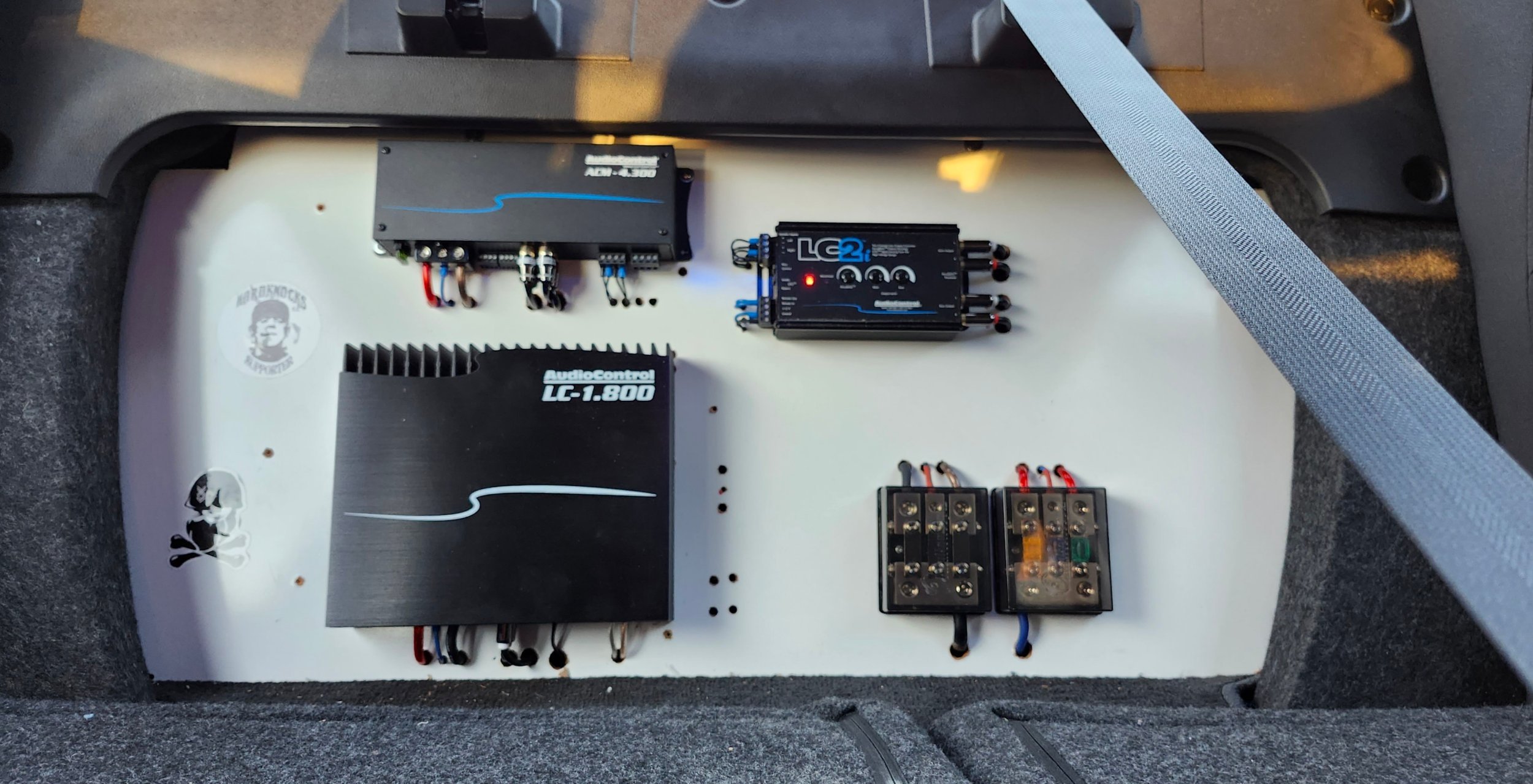

I was wanting to add a DSP to my set up . Do I need a DSP and a Epicenter or am I good with one or the other ?

All that said what are you trying to accomplish or fix? what other amps/equipment are you planning? Whats the overall system goal? Audio control is GREAT stuff. and they have a couple-5 different pieces, including DSP packaged inside a few amps. Might be able to get a 2-fer with more/better amp power and possibly elminate pieces and reach your goal in less footprint.
