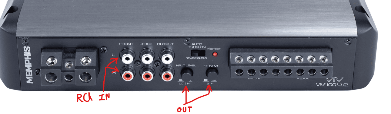

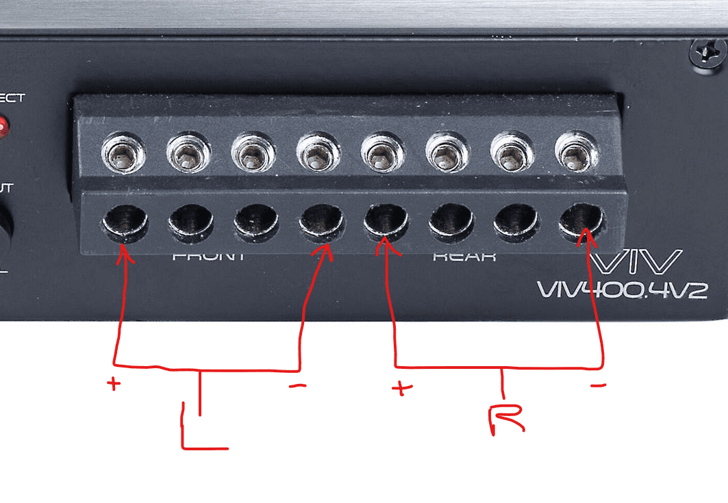

Bridged 4 channel memphis viv 400.4 for focal es 165 k fronts. Amp has switch for 2 or 4 I put it on 2 ran rca's from front to front on amp + and - I'm getting mono sound no balance .do I need to go from read Hu to rear amp with rca's for stereo .?

Usually amp's front RCAs are the universal input. What do you mean by "amp + and -"?
You need make sure you are placing your RCAs on FRONT out of the HU/Radio 1stof all for front staging,and on the amplifier you need make sure the button is in HIGH position and pushed on 4 so you dont blow the speakers and use two chs of the four for the front speakers @4ohms. Make sure your RCAs left from HU and Right go to the Front Left and Right on the amp Input, and use the Front speaker terminals. Do you have your Manual at all?? It should be self explanatory/straight forward for installation

That amp puts out 65x4 or 200 x 2 and he is running Focal 65ks. Bridged, no rear fill. Bridged gives the OP the most power. It is important to pay attention to the speaker connections as they are different and not something most people getting their feet wet are accustomed to seeing.
