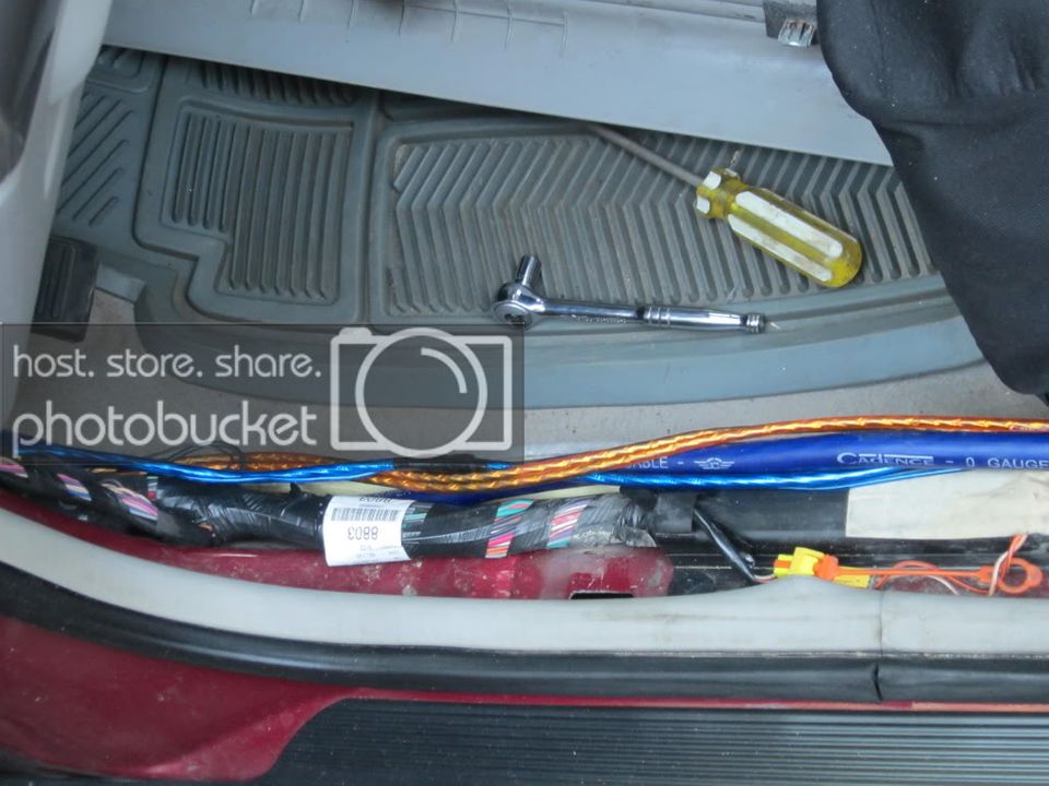

I just ran into a problem with an airbag sensor that was making the noise in my setup. The RCA cables ran right next to it. They lasted for about a year then started giving me engine noise. The RCA cables were ruined, every time I plugged them in the noise would be there. Took the monster cables all the way out, put them on the ground and they still made the noise when I plugged them into the amp. Plugged in an old spare set, and the noise was gone. I went with coaxial cables for now and moved them towards the middle of the truck. I worked on this problem for a long time, checked every thing at lease twice, changed grounds, added grounds, changed where my power & ground was coming from on the headunit, but in the end it was the cables that were fried. I believe the yellow air bag sensor caused my problem.

my system is all good now. I ran into problems and it was all my rca cables. Monster 4 channel set, and a xln monster set for the subs. All of the rca cable's made noise when I plugged them into the amp, even after I took them out of the vehicle. The problem was the air bag sensor, makes a high pitch noise, and some how made these rca go bad. It took almost a year until they made the noise. Never had rca cables go bad, so it was a surprise.
