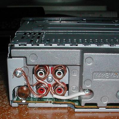

It sounds like you're experiencing a common issue. Often, speaker whine can be caused by ground loop problems or alternator noise. I recommend checking your ground points for any corrosion, ensuring they have a solid connection. Also, consider using a ground loop isolator or checking the routing of your RCAs and power cables again. If the issue persists, you may want to try a different alternator or check your power management settings.
Doing this may help.
