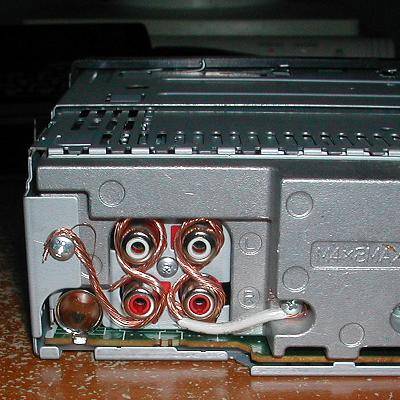

THIS IS NOT MY PIC but it shows the concept
if this works, then the pico is still the issue
also, do not use a factory ground for the hu. find a new location and use that. ground the case of the unit and the harness to that point.
