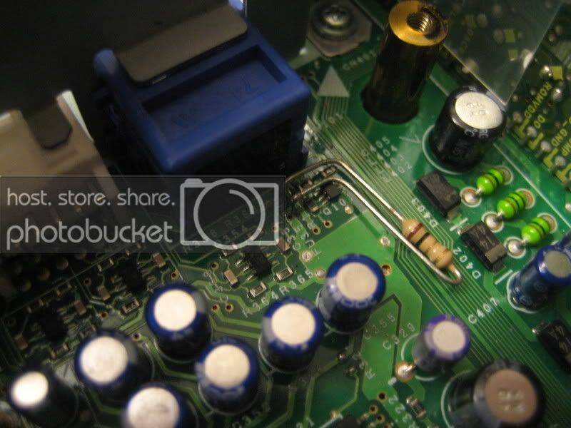

I had the pioneer headunit serviced for pico fuse, same shit!
If i disconnect one of the rca's on the amp the whine goes down in volume but still there. Could the noise be from the amp? I got it used from here, an MTX road thunder..old black version.
ive had 3 pioneer head units in a year and a haft,, there just really toutch y, i just go to wall mart pick one up but the bad one in the box, return it, get your momey and the broken one if off to the factory
Really thats some shit that you have to mod a brand new $300 piece of equipment just to get it to properly working order. It should work out of the ****in box.
So what are the details on this resistor mod?
Also how do i ground the rca shielding ?
I guess i can search, ill post up again if i dont find anything...thanks dman
