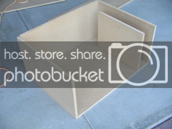

No glue or nails, just seein how it would look

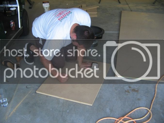

Peter makin them perfect circles free hand for the sub to mount on

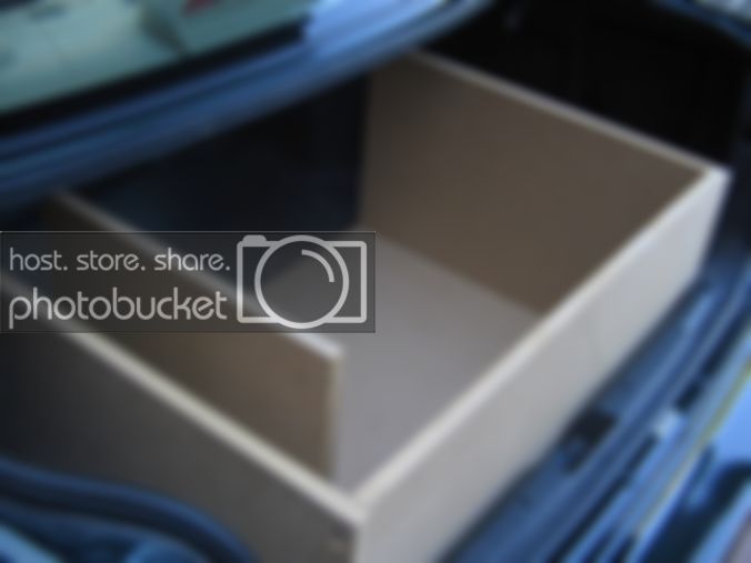

The box in the trunk, nice fit, no problems

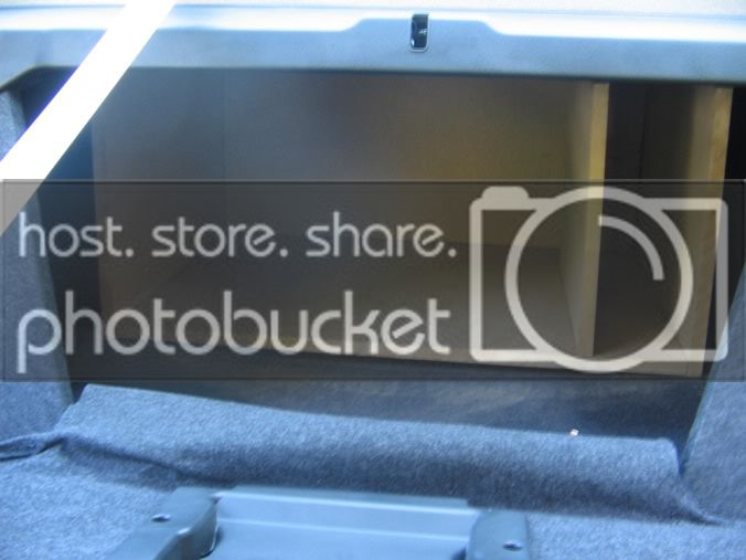

The view with the seats down (you'll be able to see the sub with the plexiglass if we decide to go that route)
