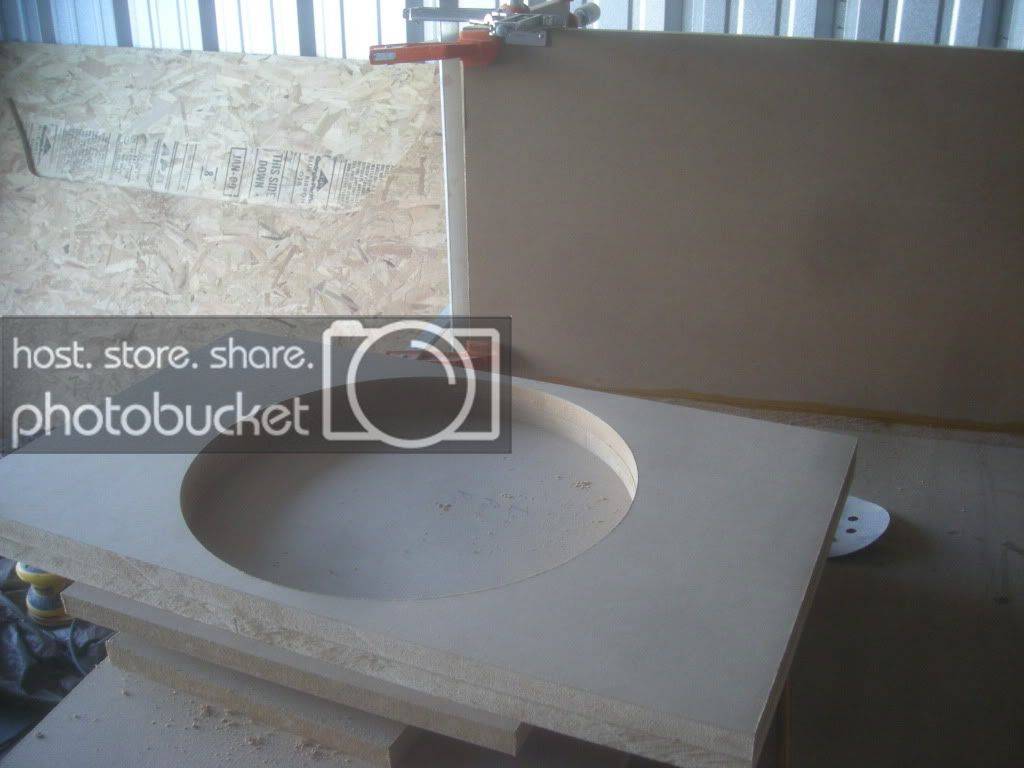

My internet's been so crappy the last day and a half I couldnt get on to upload this build...but here it is. The specs are less than optimal due to space constraints though.
Specs come to:
-3.16 cubes
-34.5hz tuning
-46.5 sq inches of port area
Onward:

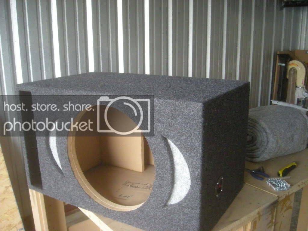

is it better to have the double baffle make the subs sit flush, or to have it like how u did it?
btw great build //content.invisioncic.com/y282845/emoticons/biggrin.gif.d71a5d36fcbab170f2364c9f2e3946cb.gif
Thanks
And it's really for the look to countersink them (and having the sub mostly flush with the enclosure is nice when moving it in and out of a trunk if space is tight) but having no countersink would have more support since it's mounted through both layers, no performance difference really though.
