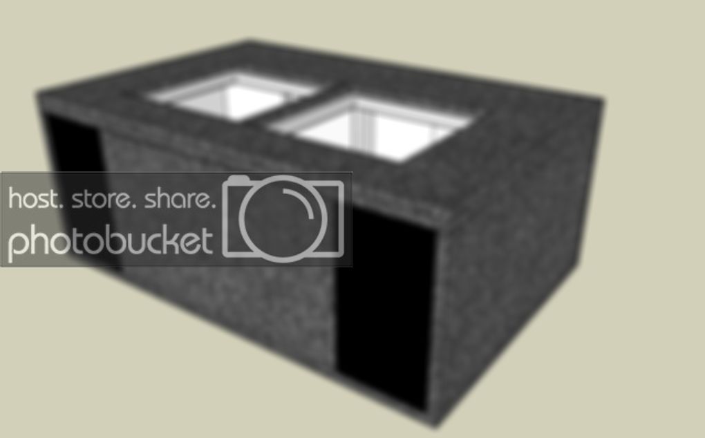

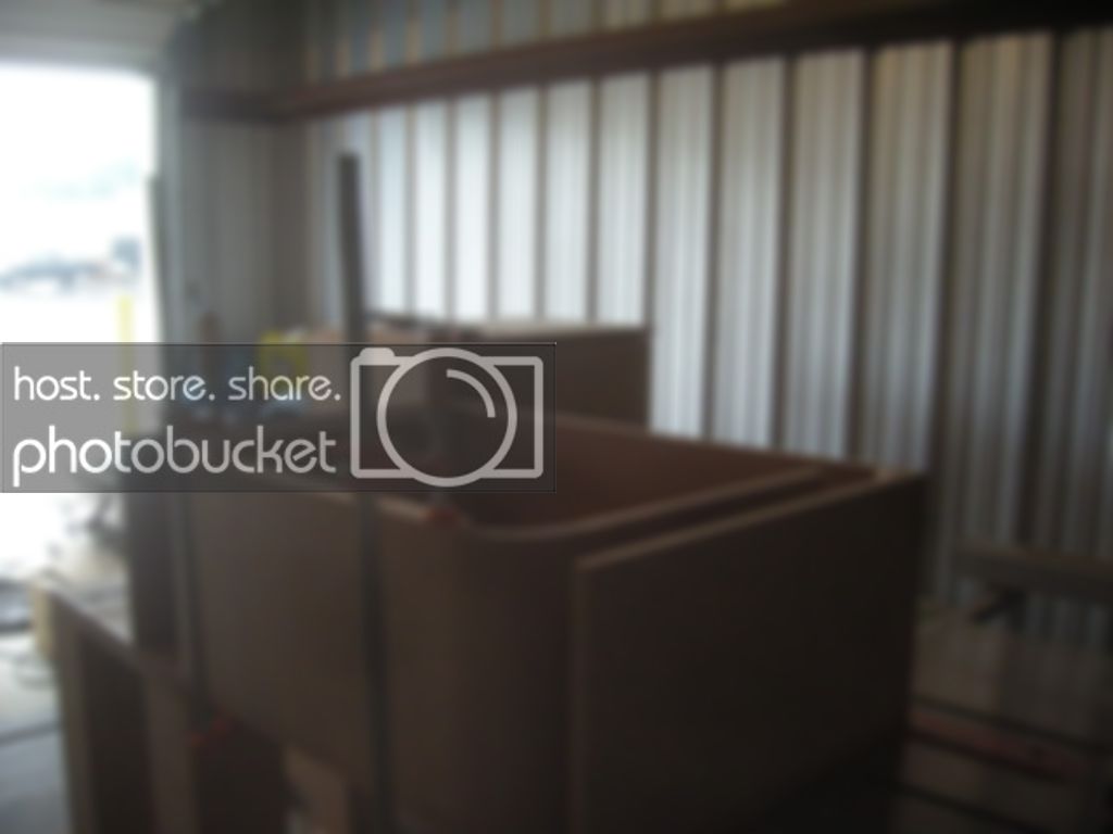

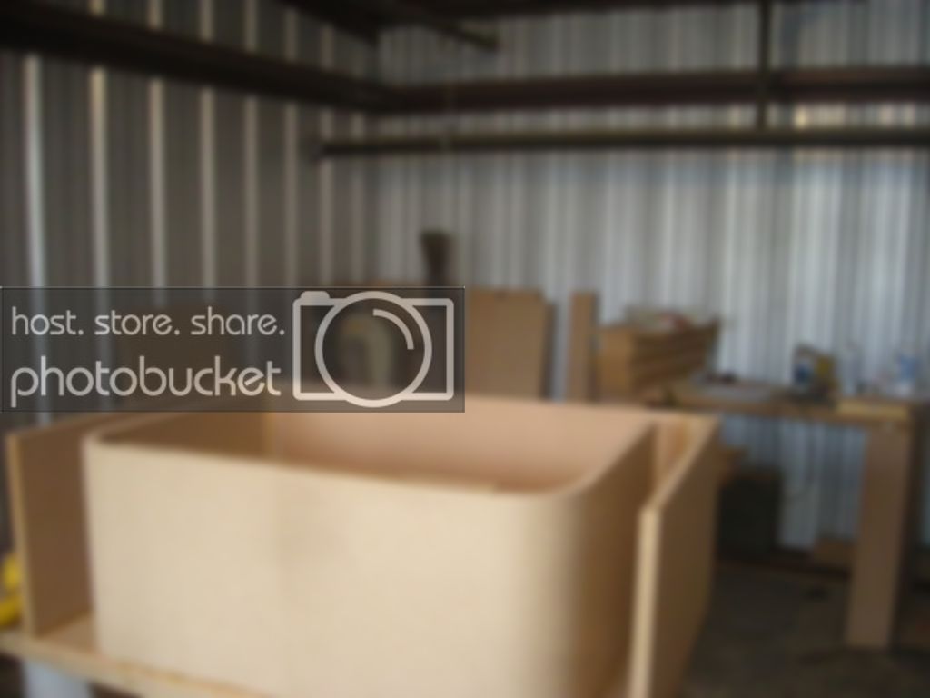

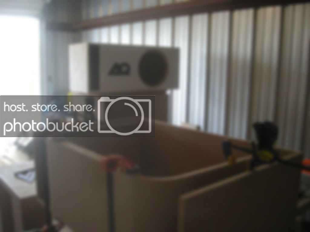

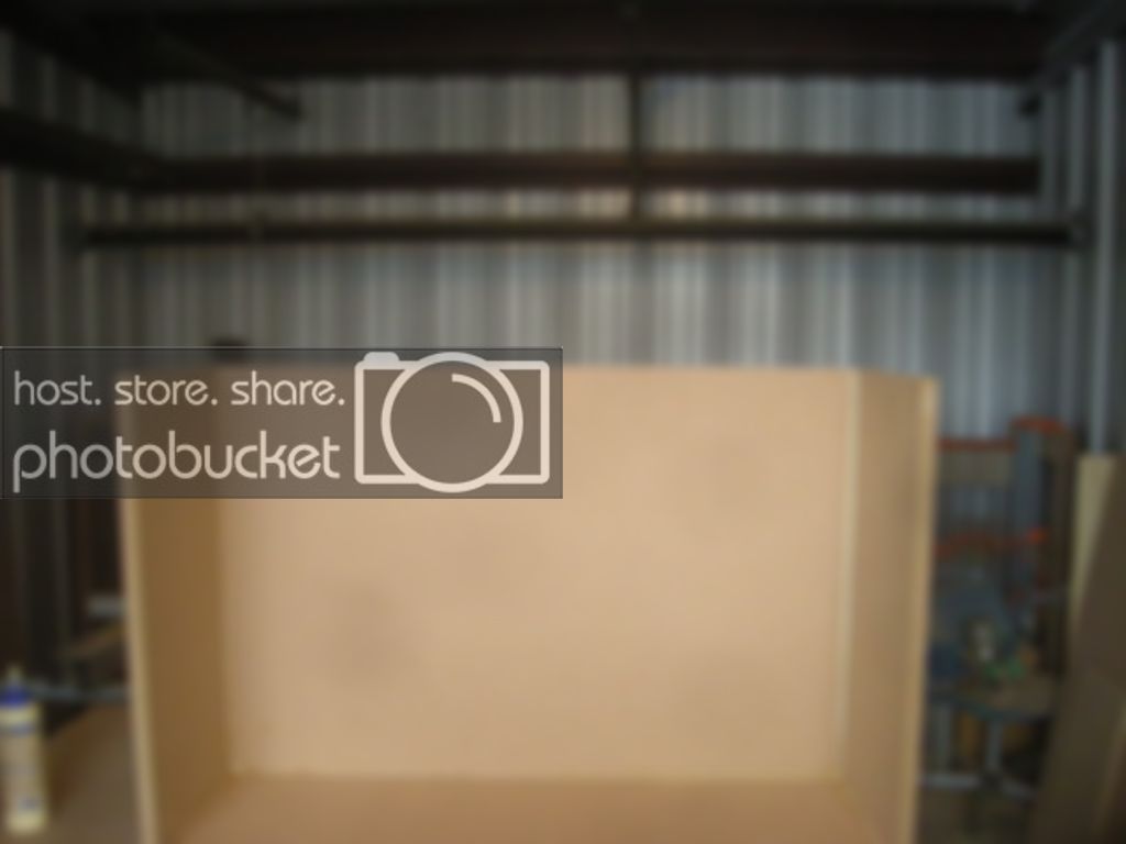

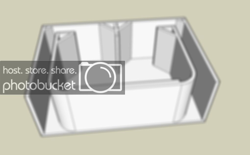

This enclosure is for a pair of square Atlas 12's and the specs come to:
-4.31205 cubes net
-32.26Hz tuning
-76.5 sq inches of port

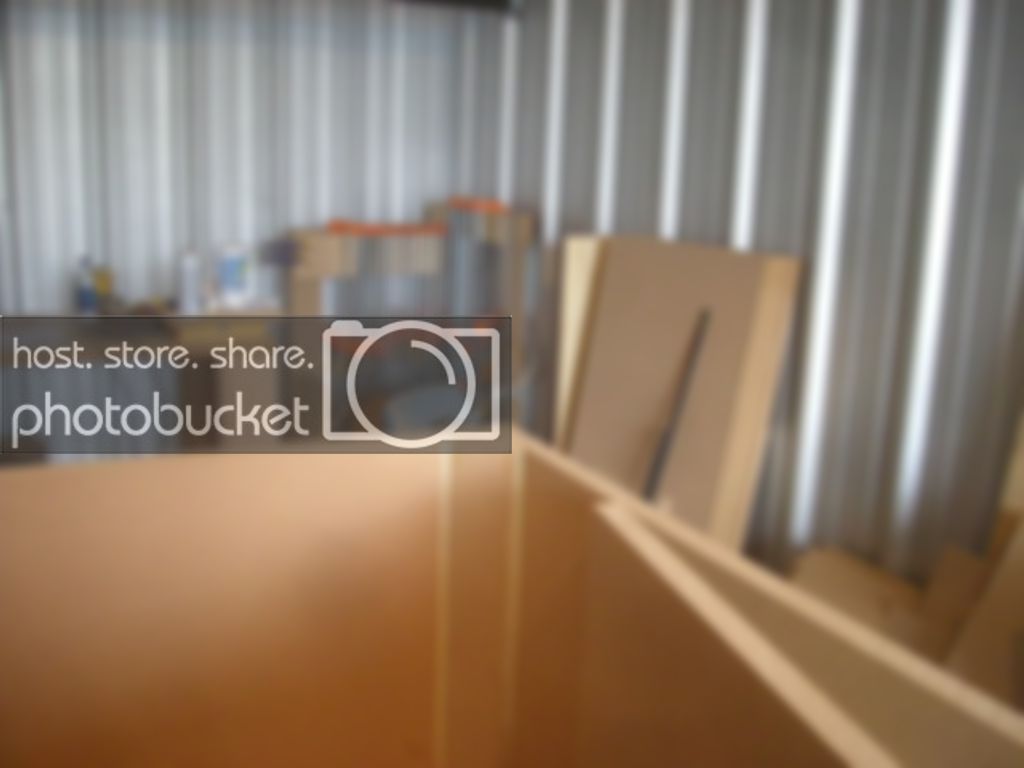

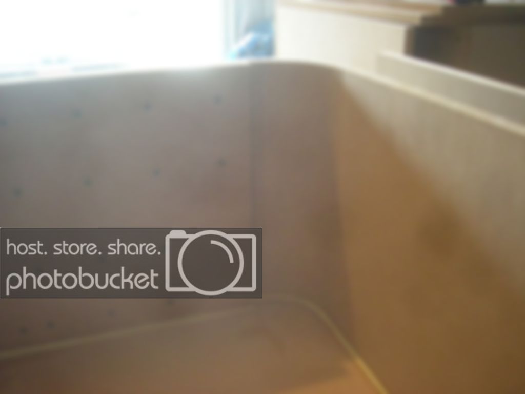

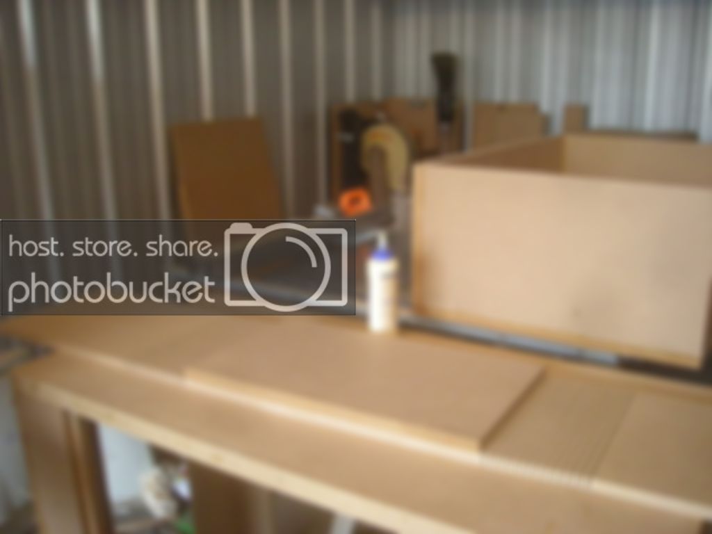

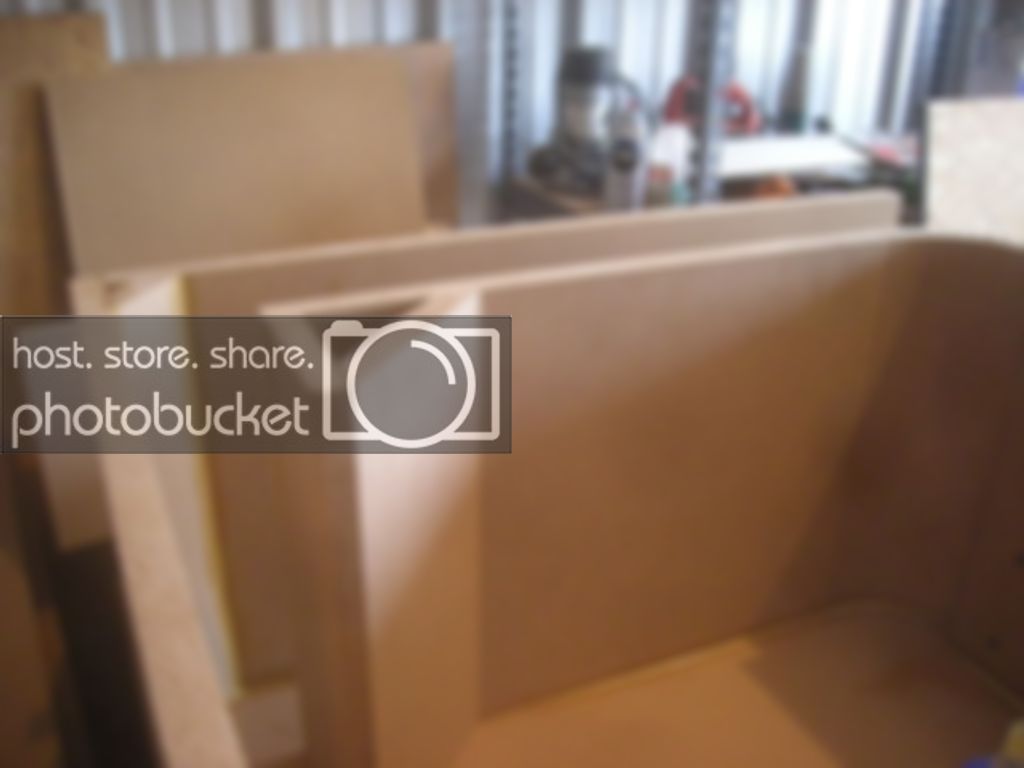

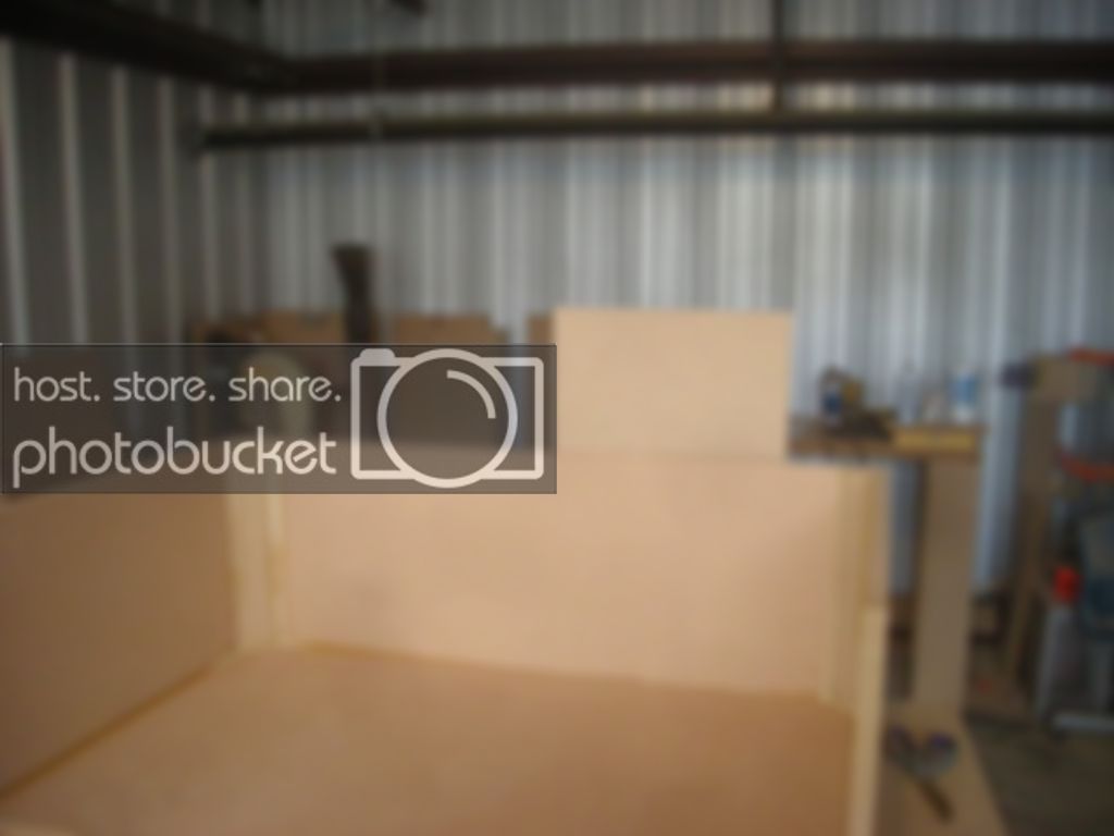

Getting started (sorry about all of the reall crappy angled pictures...my camera's screen is busted and I just have to aim it the best I can and just guess what im taking a pic of)

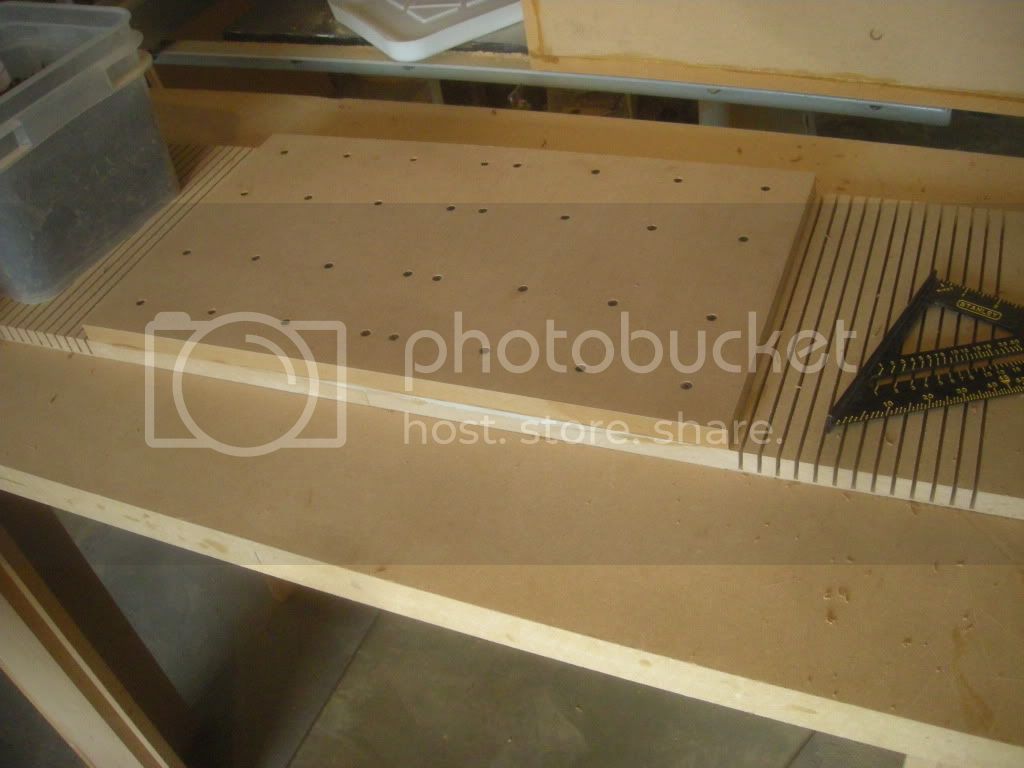

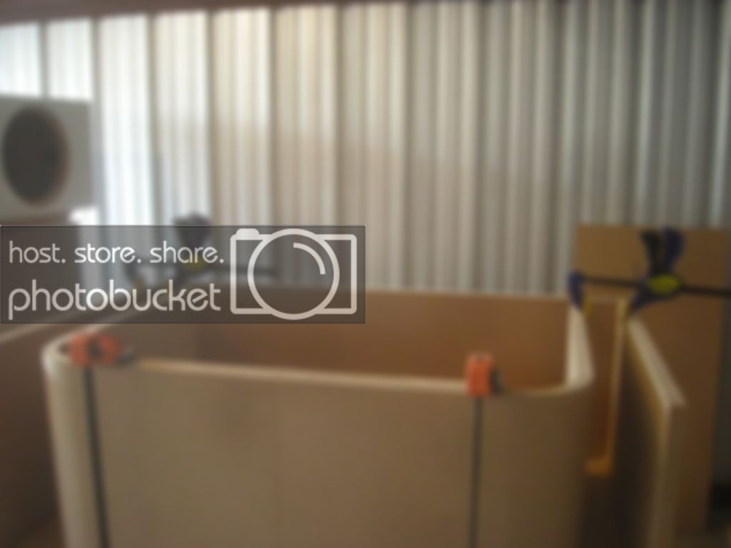

Kerfed pieces getting going:
//content.invisioncic.com/y282845/emoticons/verymad.gif.3f39c5c2fd57527b671fad3efdfac756.gif

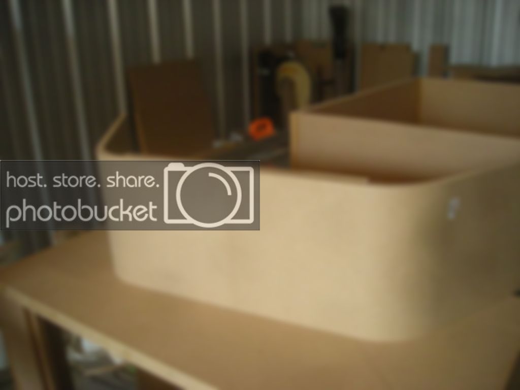

why did i never think of doing a double kerfed port with two pieces like you did!!!! should have seen me try to kerf that long *** piece! great work man! but im wondering about those atlas subs.... ive never heard them
Thanks //content.invisioncic.com/y282845/emoticons/smile.gif.1ebc41e1811405b213edfc4622c41e27.gif...that wouldve been a pretty darn long piece if I didnt do that, lol...and it's some added support so it's good there too.

i really cringe every time ppl ship out kerfed boxes.... seen alot get all messed up! u gona put resin in the corner or no?
