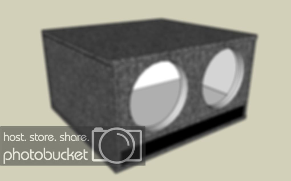

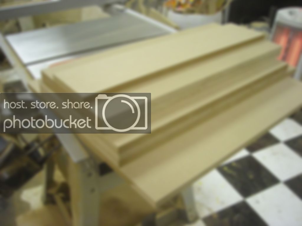

This enclosure will be for Fender5's pair of 12's. Specs come to 4.11 cubes net, 71.25 sq inches of port, and tuned to 32.5Hz. Double baffled.
I have little done on the enclosure though, so you're going to have to make due with a sketch-up and a couple pics of most of the pieces cut //content.invisioncic.com/y282845/emoticons/tongue.gif.6130eb82179565f6db8d26d6001dcd24.gif
Sketch-up:

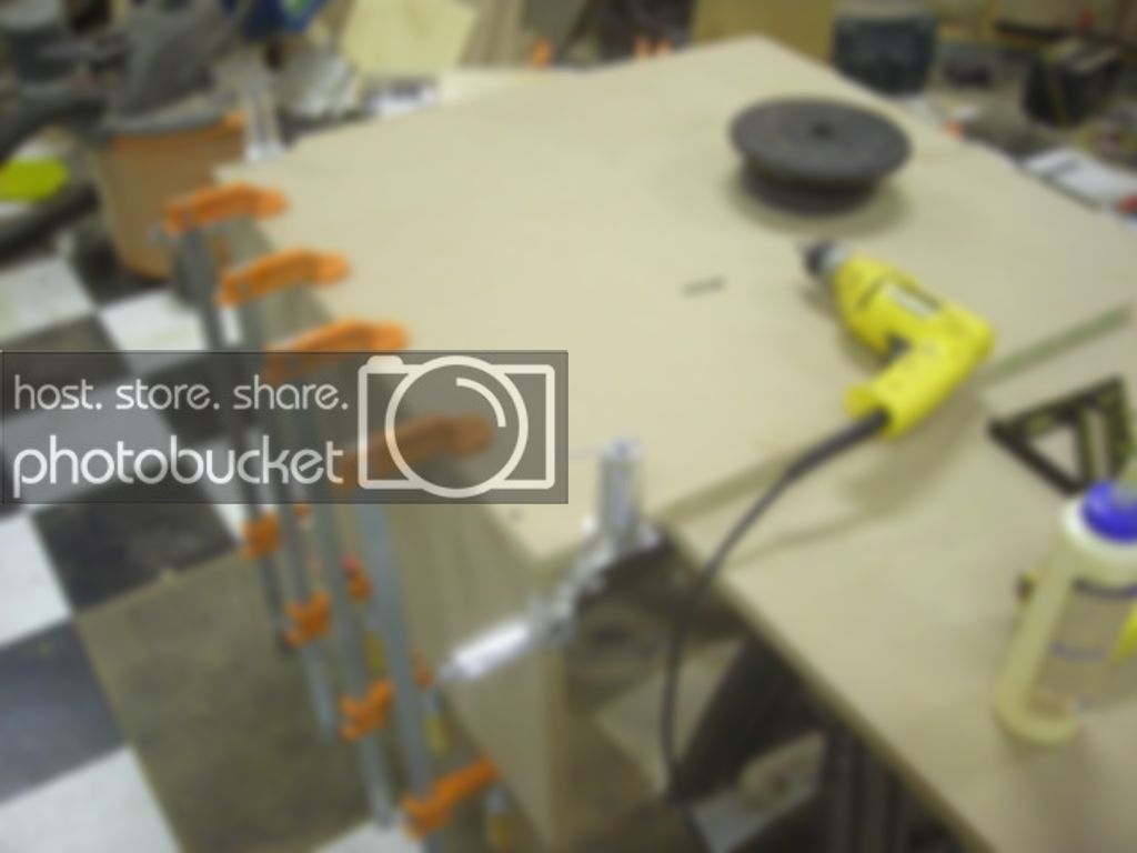

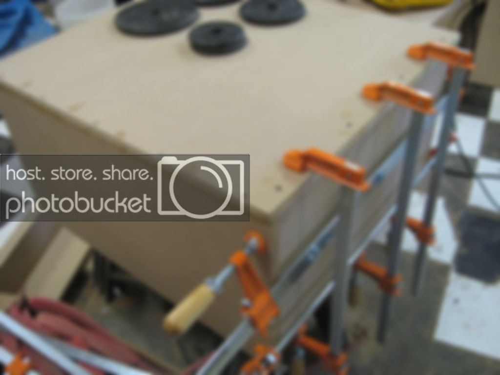

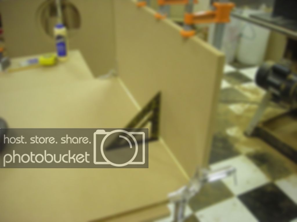

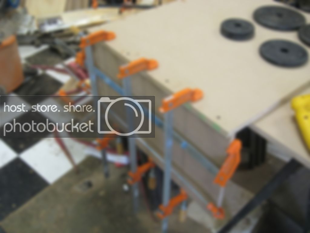

Pieces cut (most)...
More for sure tomorrow
Chyea //content.invisioncic.com/y282845/emoticons/smile.gif.1ebc41e1811405b213edfc4622c41e27.gif
Hopefully tomorrow I'll have some real progress...tonight I was just too tired and hungry to stay...I need to get to bed //content.invisioncic.com/y282845/emoticons/frown.gif.a3531fa0534503350665a1e957861287.gif
Thanks //content.invisioncic.com/y282845/emoticons/smile.gif.1ebc41e1811405b213edfc4622c41e27.gif
And ofcourse I forgot the camera when i went in the second time...I'll have pics tomorrow.
But what I got done was the port pieces put together and the 45 degree pieces cut...i'll be rounding over the edges in the morning hopefully before work and then pics tomorrow night
