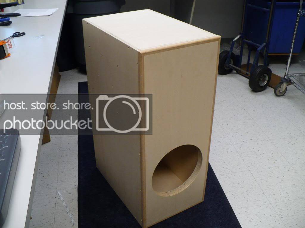

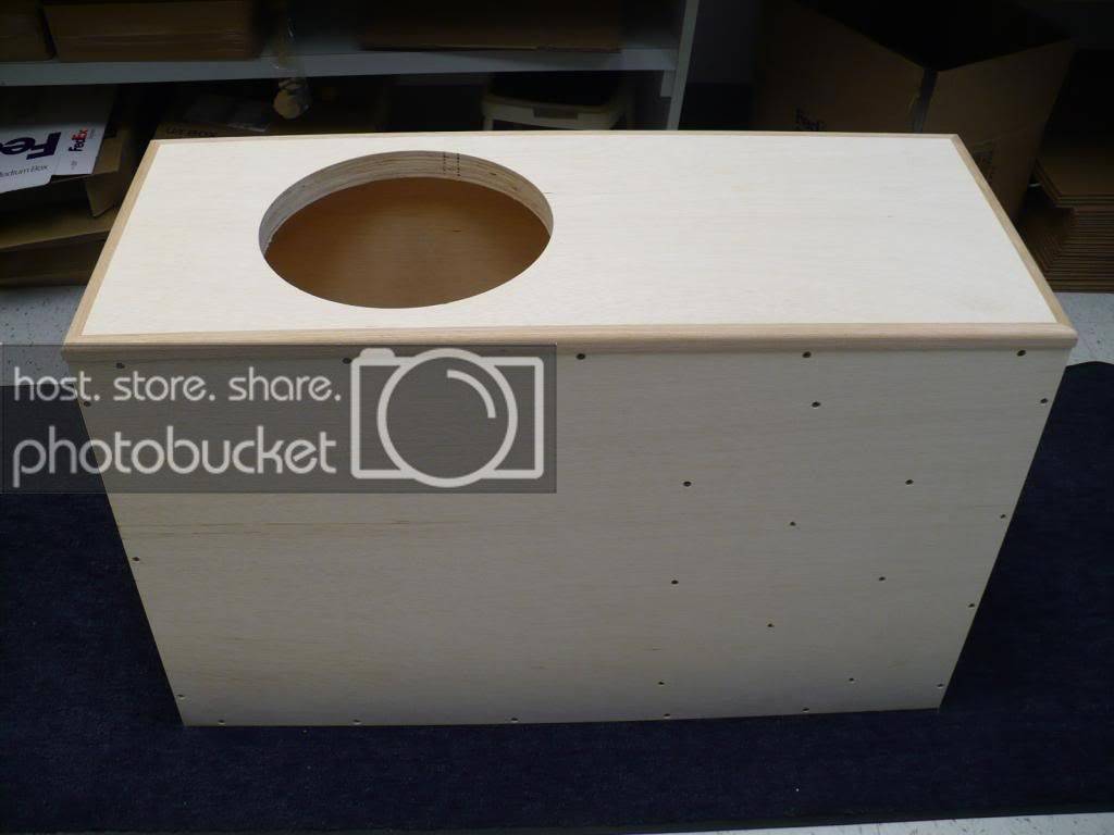

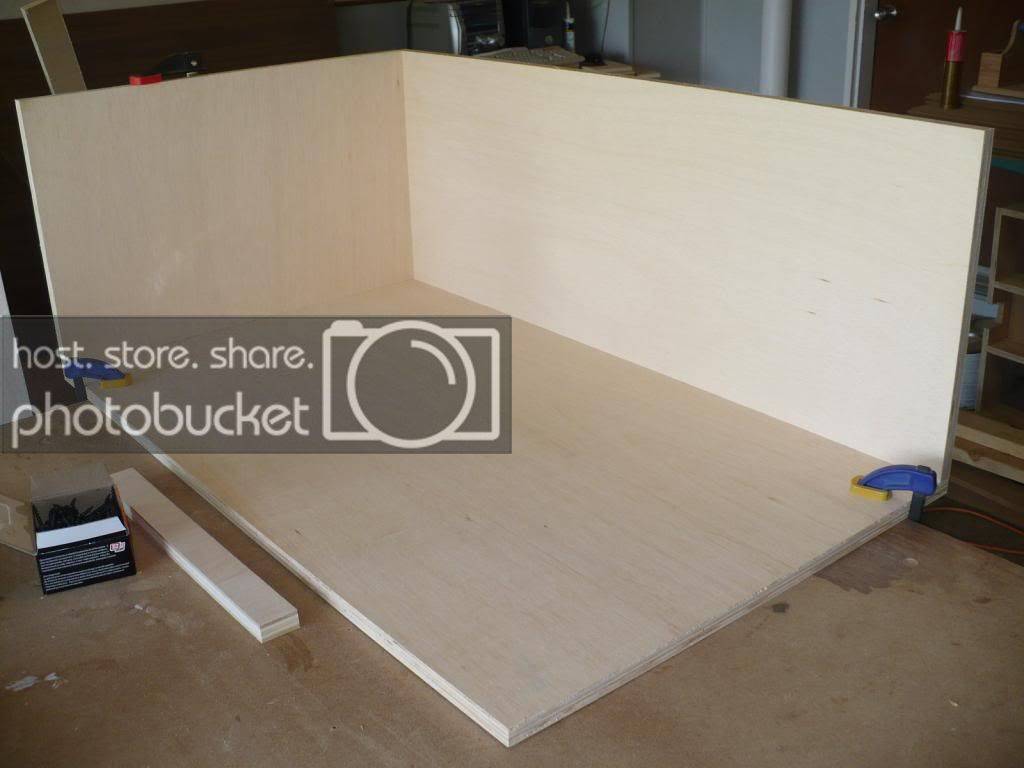

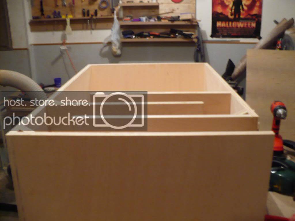

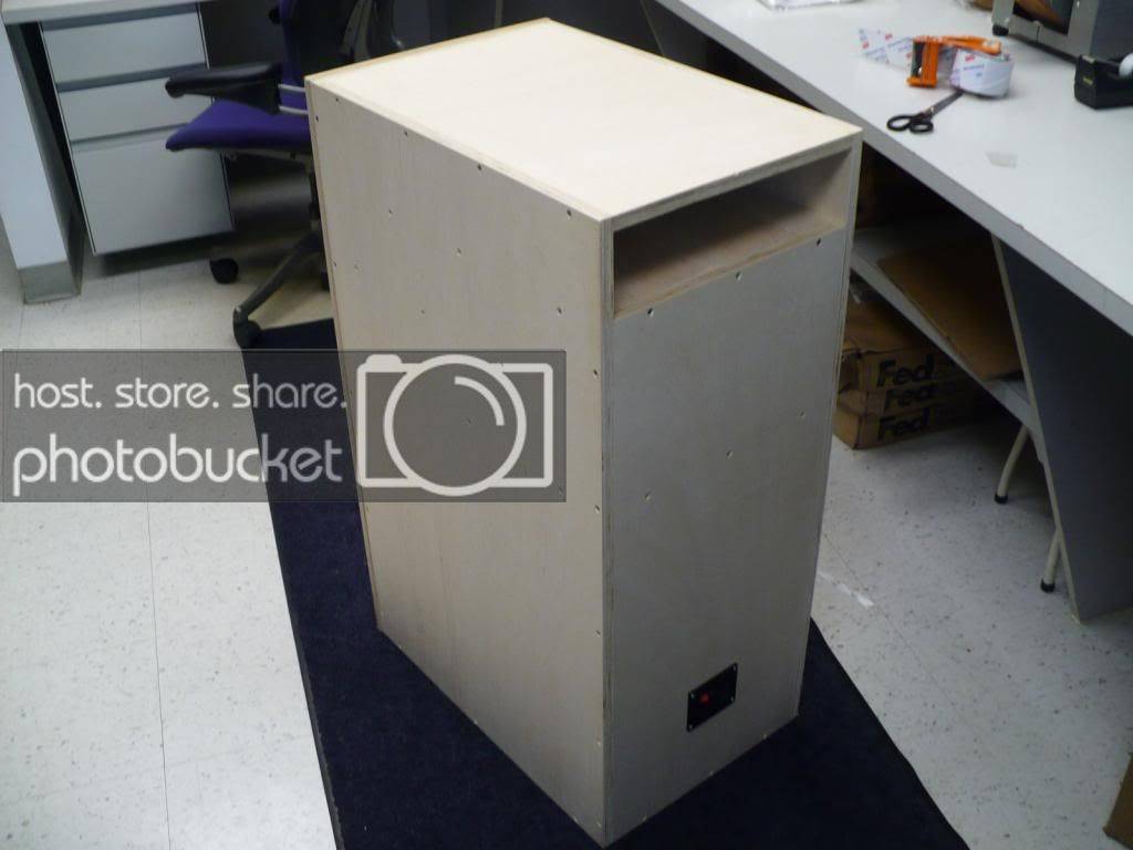

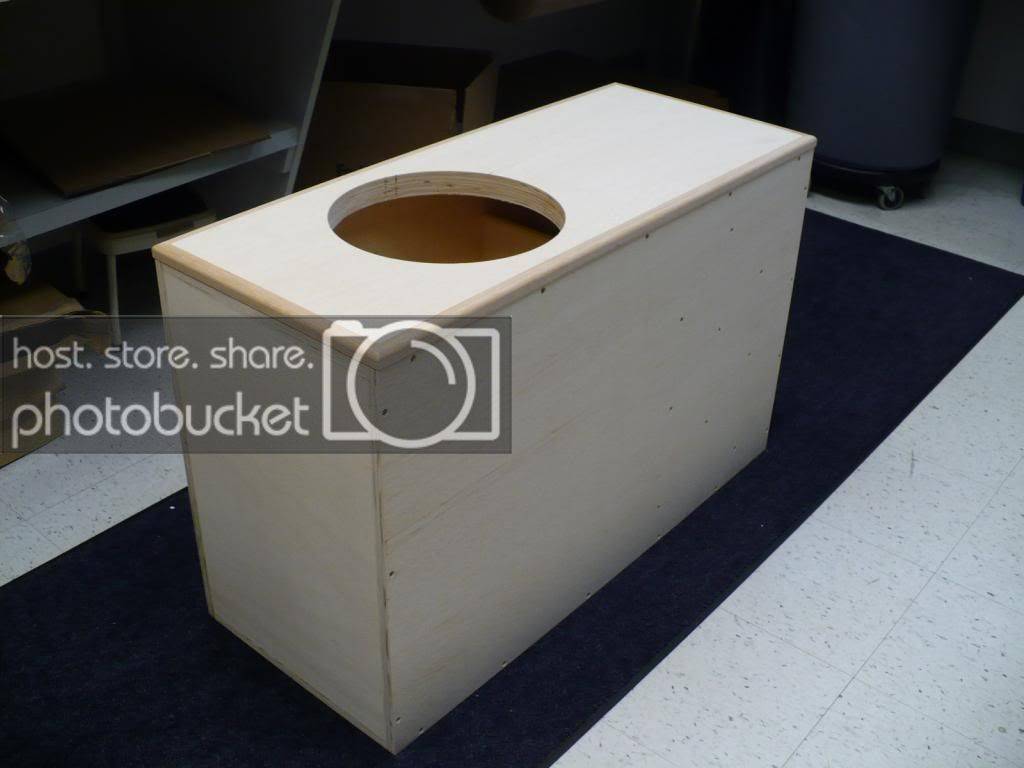

psych0ticnemes1 5,000+ posts Psych0tic Customs 6,004 9 Behind You Aug 7, 2013 #1 I just wanted to throw something together since this isn't a typical build for me. This is a home theater box for a 13W7. I wrapped the baffle with hickory to hide the plywood edges from the front angle. It is tuned to 22 hertz. Click to read more...
Buck 5,000+ posts little alien on campus 35,960 5,673 Inside of a pyramid Aug 7, 2013 #2 What's your port area?
OP psych0ticnemes1 5,000+ posts Psych0tic Customs 6,004 9 Behind You Aug 7, 2013 Thread Starter #3 58 square inches of port.
