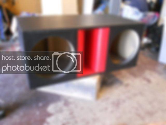

mkay box is done guys here is the finished product!
looks awesome
how far apart do you make the relief cuts for the kerf
it depends on the size of the radius really. each cut was spaced about 5/16" apart. A total of 12 cuts must be made at the starting point of the kerf to the end point. and just a note to people who are thinking about building a kerfed box, they are extremely simple. Its all about the depth at which you set the blade. to low and when you try to bend it, it will crack, to high and the blade will go through lol. the perfect depth i notices was leave 1/16" of material on the top and you will get zero splitting issues.

Yeah I tried it once but didn't cut deep enough...kept cracking
yup. thats an issue. dont cut so thin that if you can c the sun glowing through the wood if looking at the kerf through the back. just enough to where its a small glow lol.
