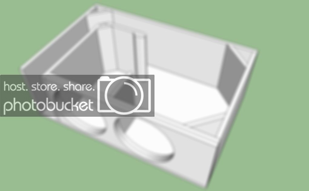

A look at the design:

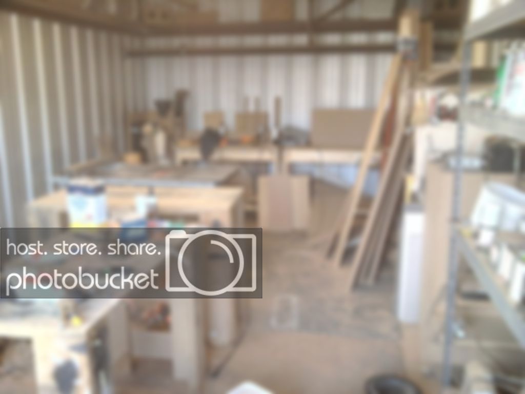

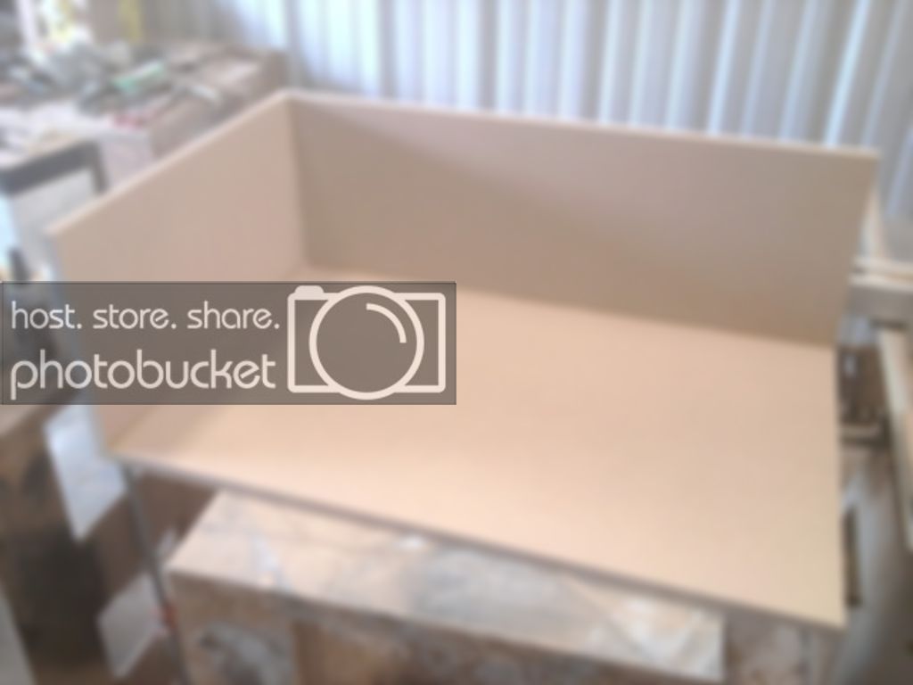

And I get to the shop...it's pretty much in ruins lol. Time to dust everything off and get back to work :hello:

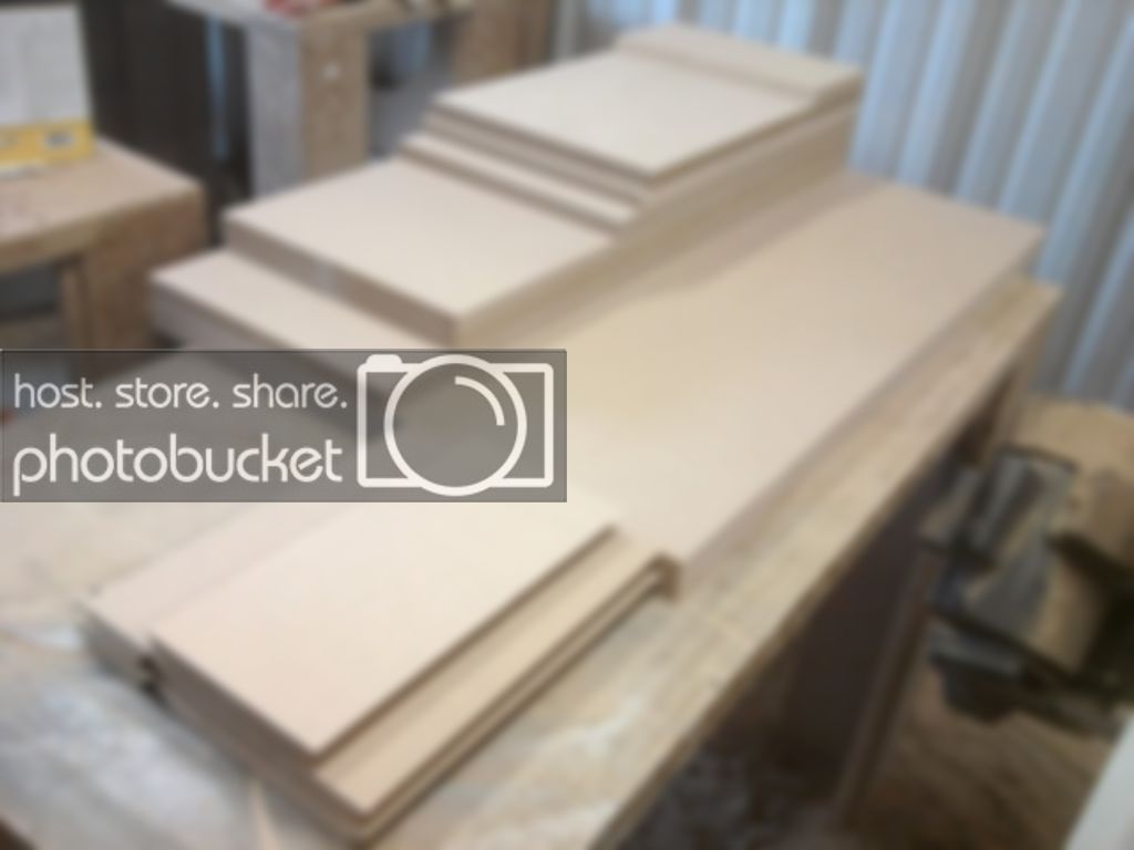

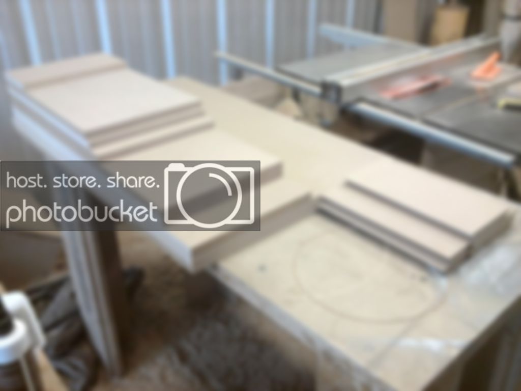

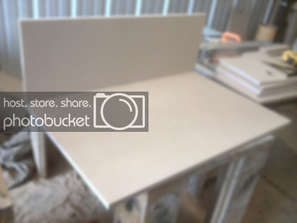

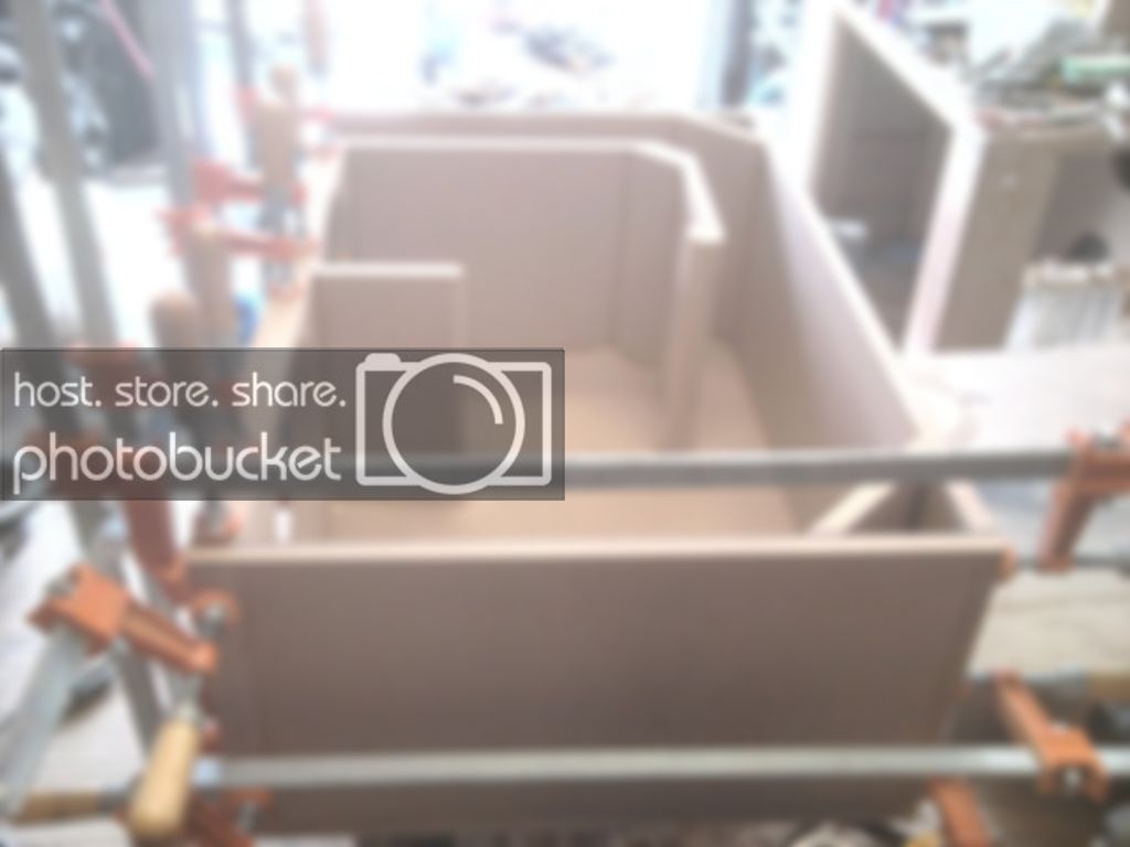

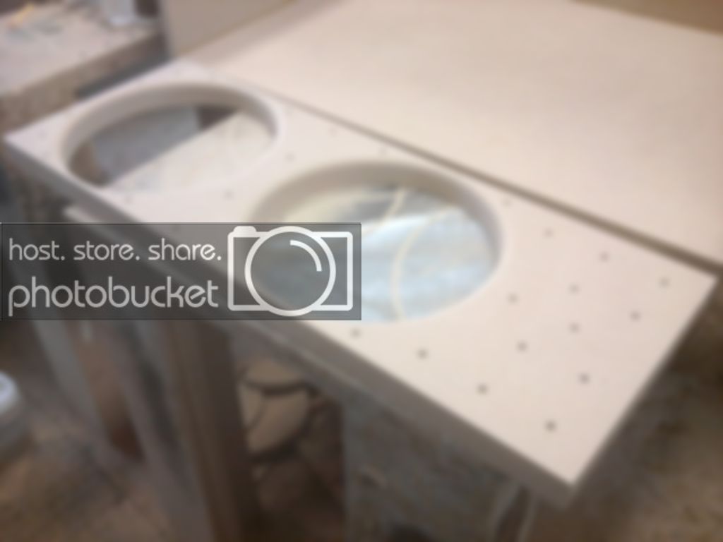

Pieces cut...

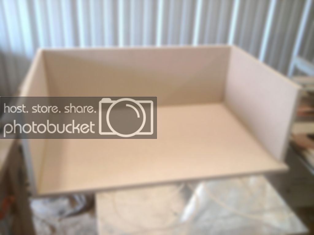

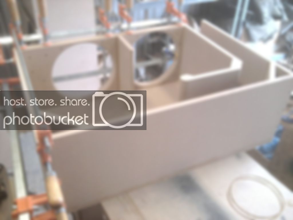

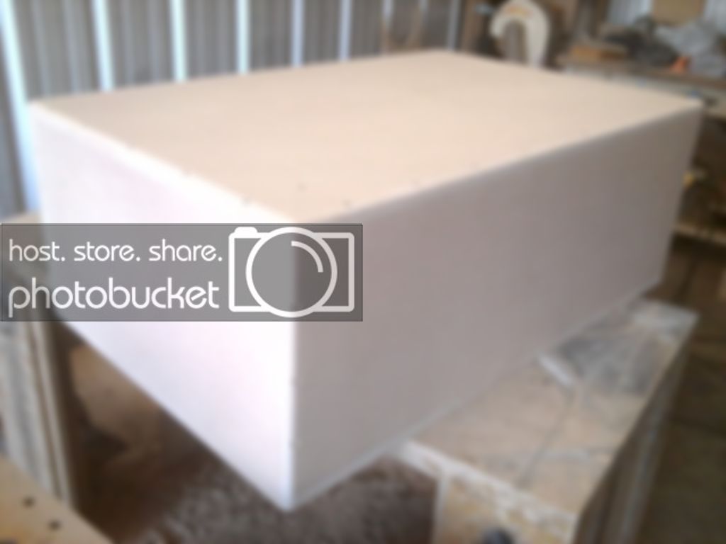

Back on...

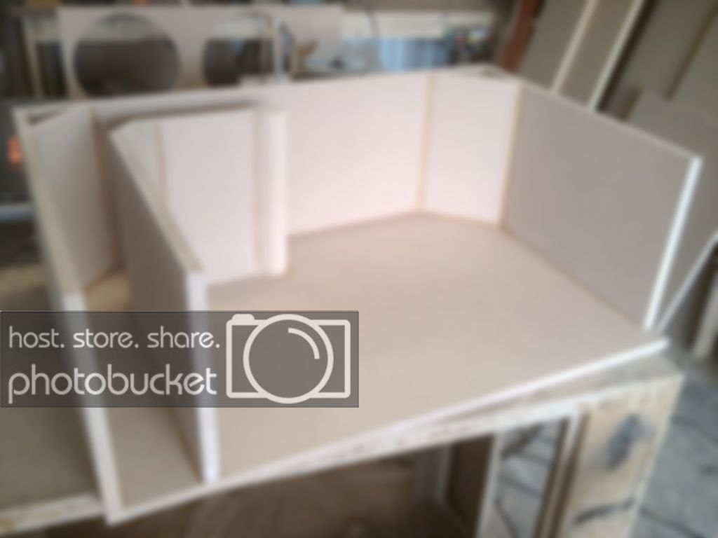

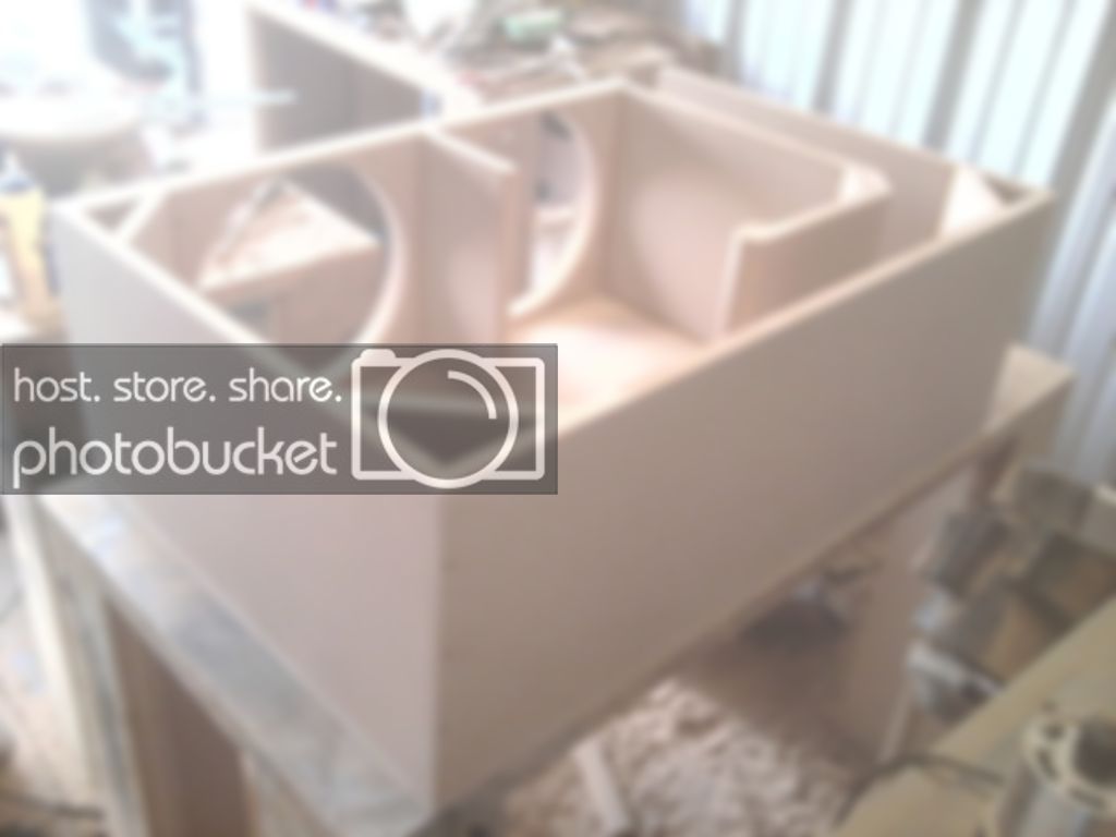

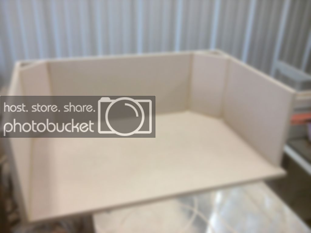

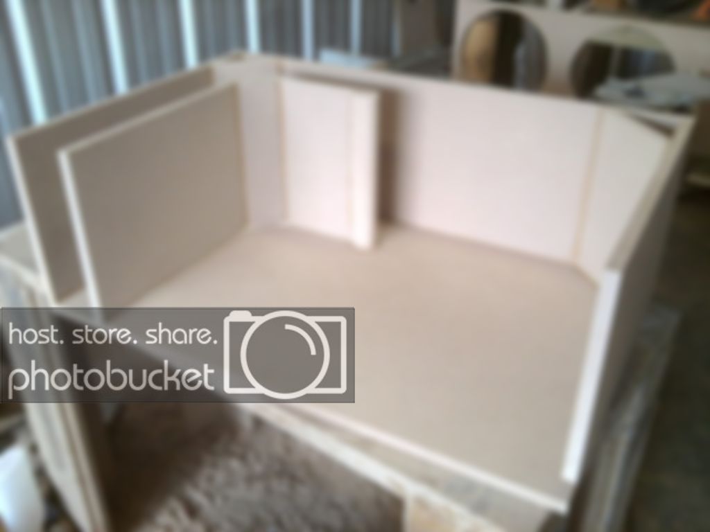

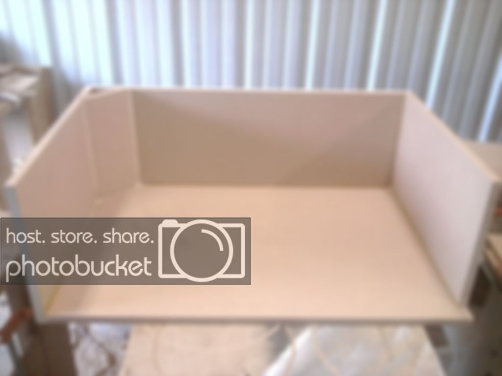

Port-side on...

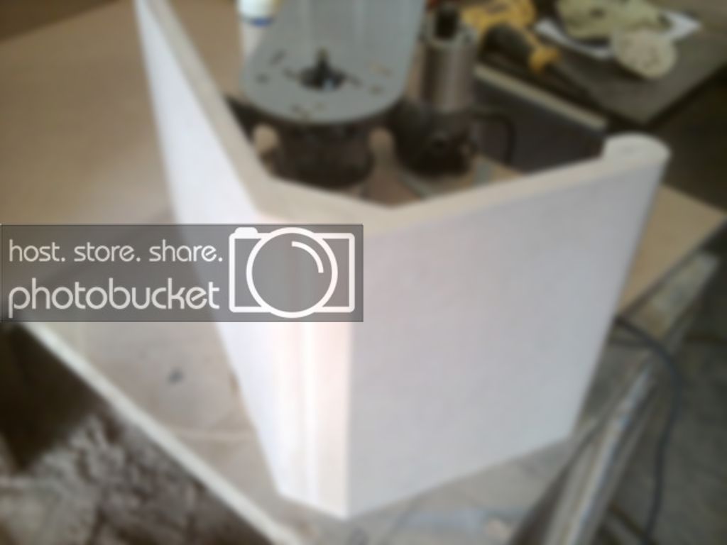

Other side on...

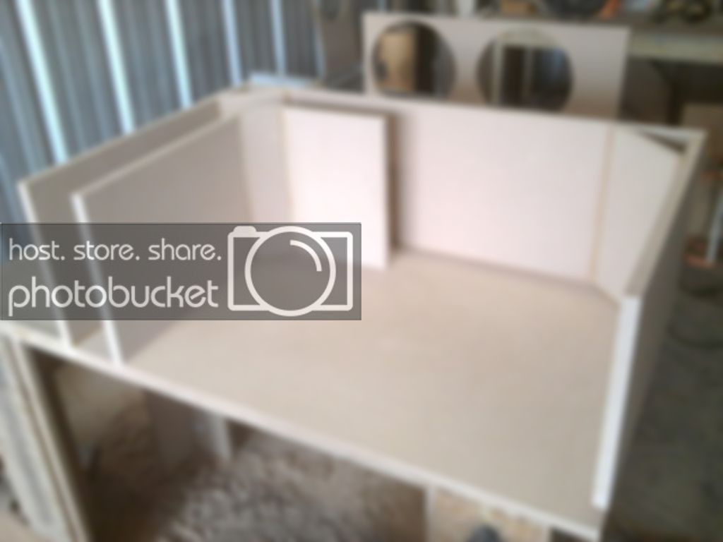

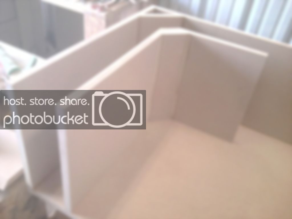

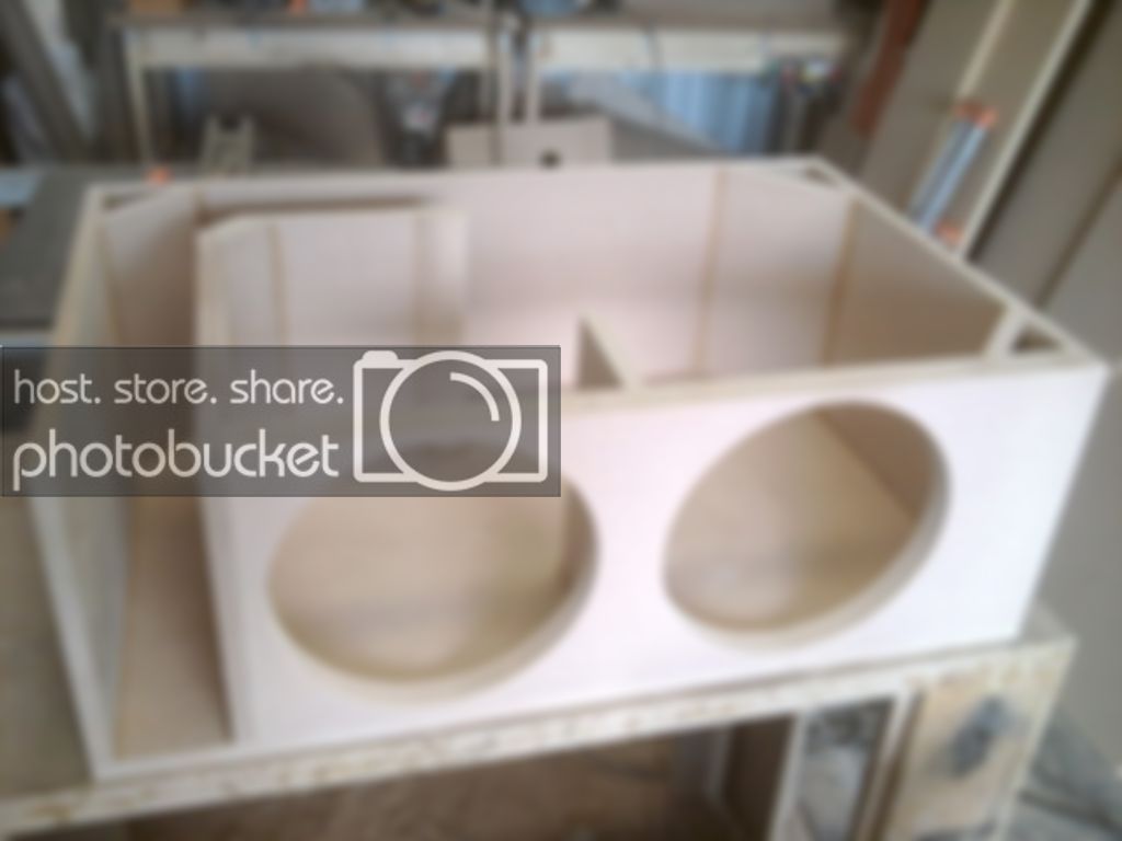

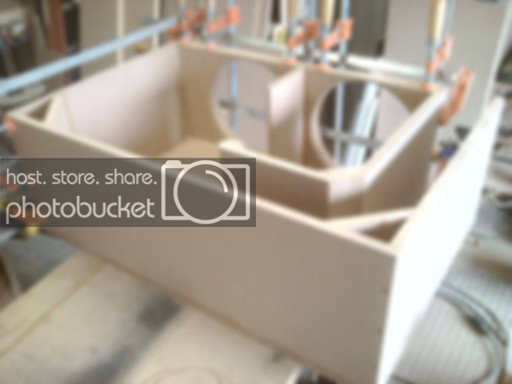

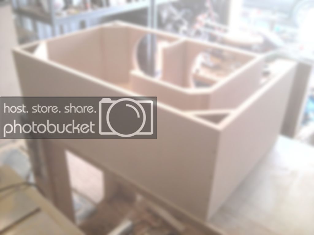

Port-corner 45 in...

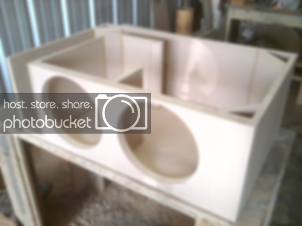

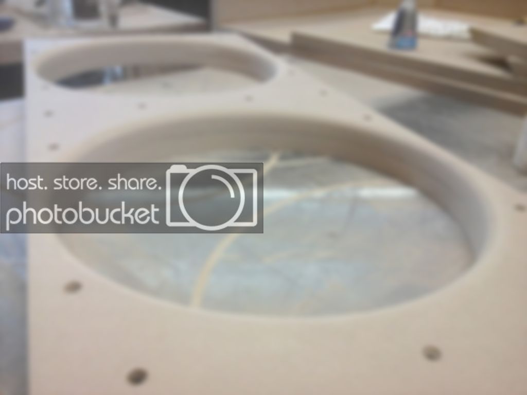

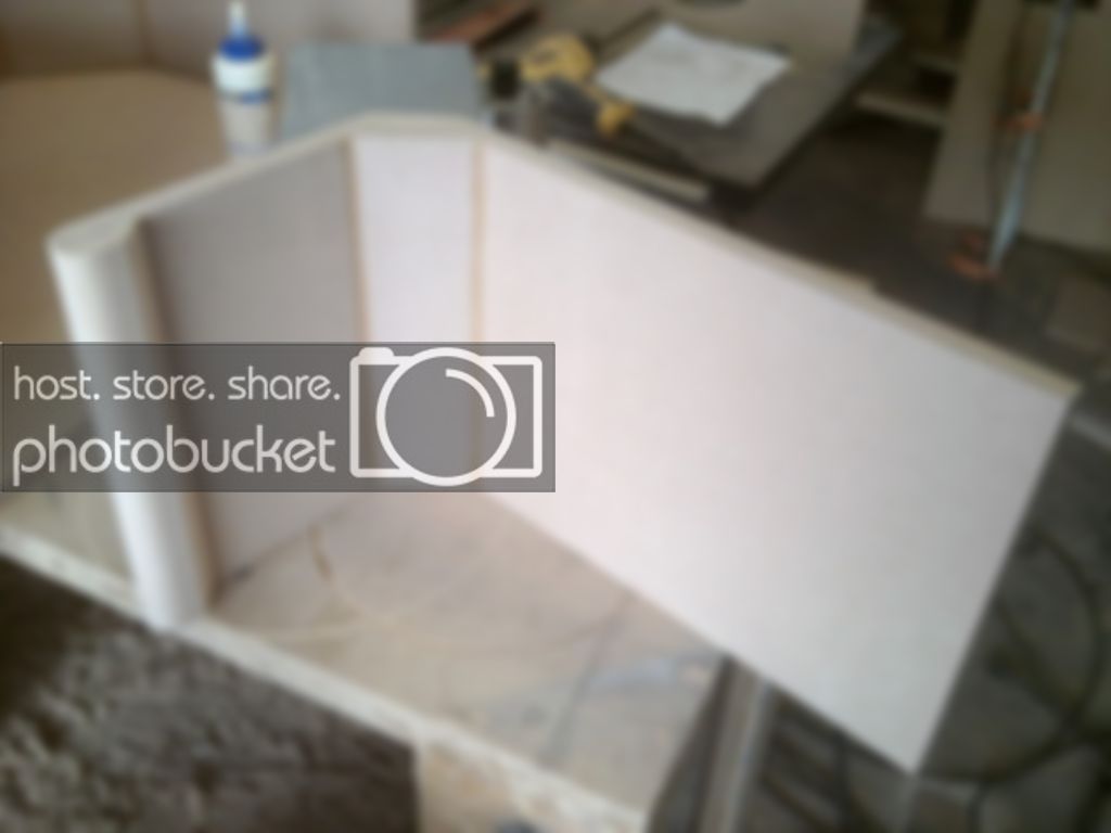

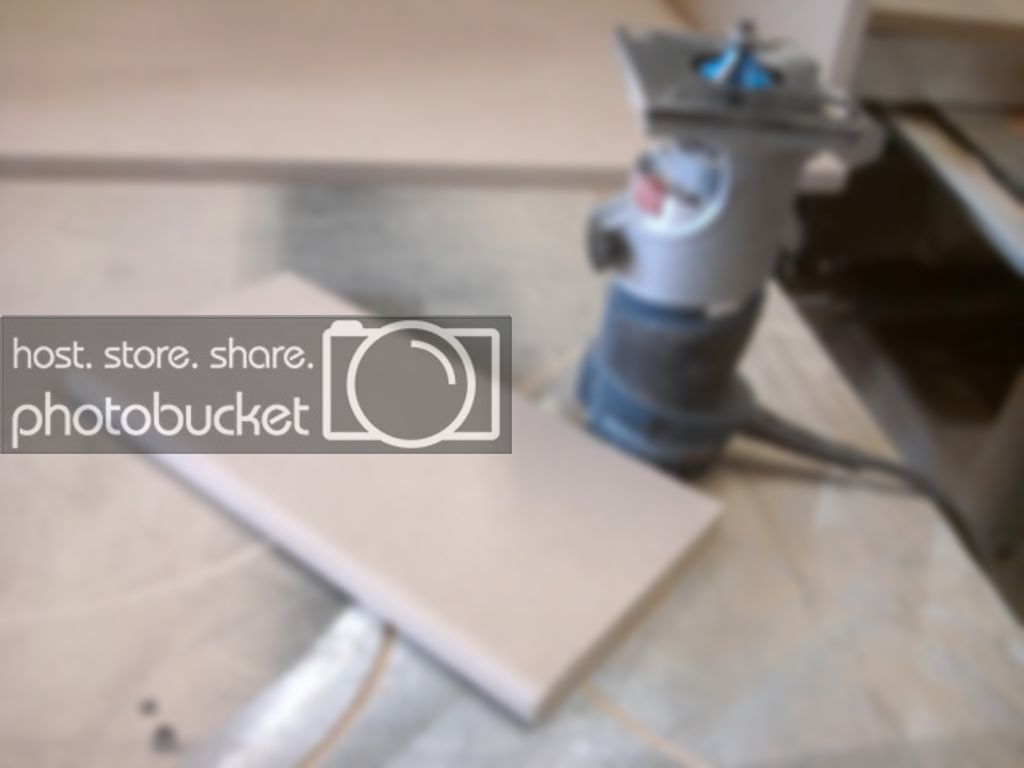

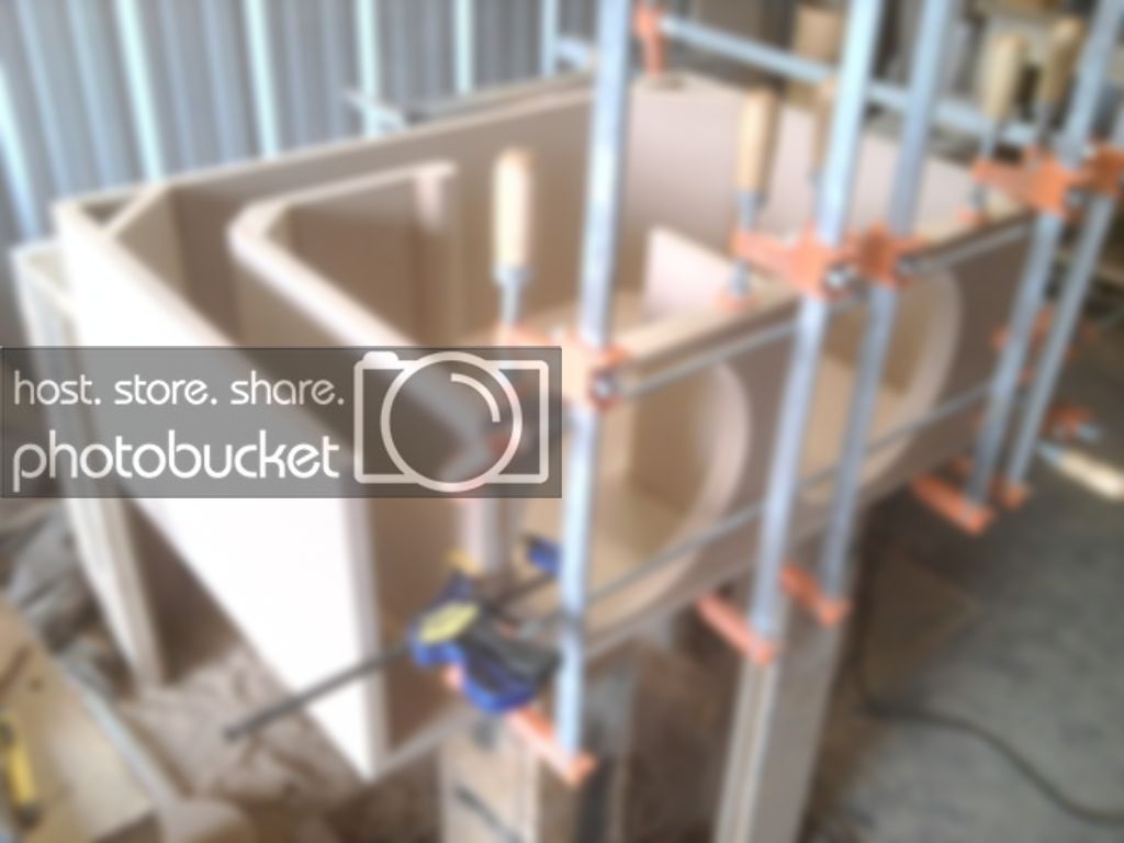

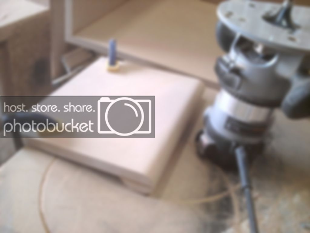

The divider, for between the subs, rounded-over ...

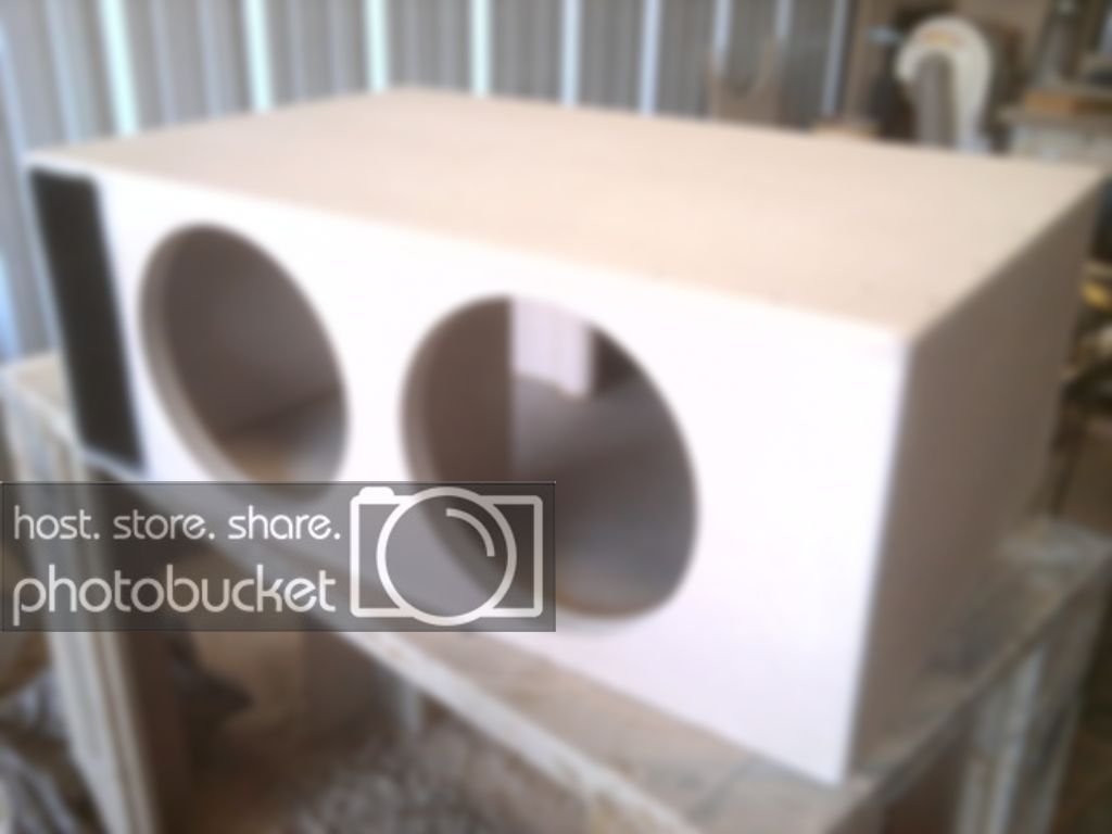

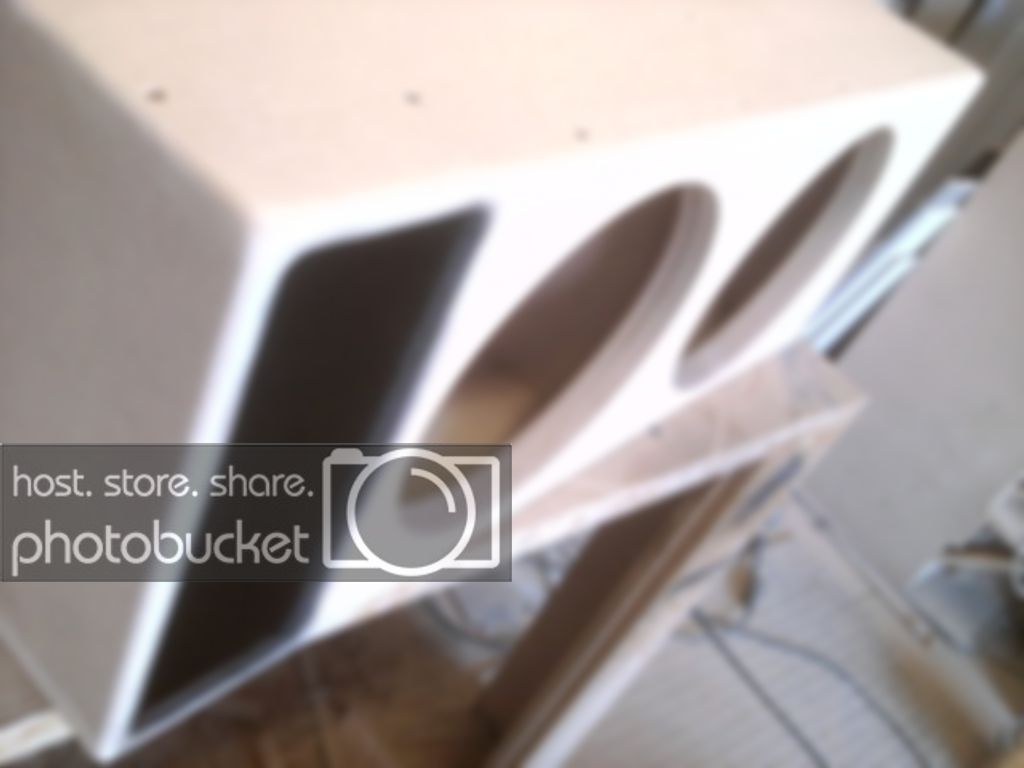

All done //content.invisioncic.com/y282845/emoticons/smile.gif.1ebc41e1811405b213edfc4622c41e27.gif

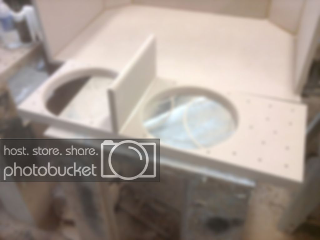

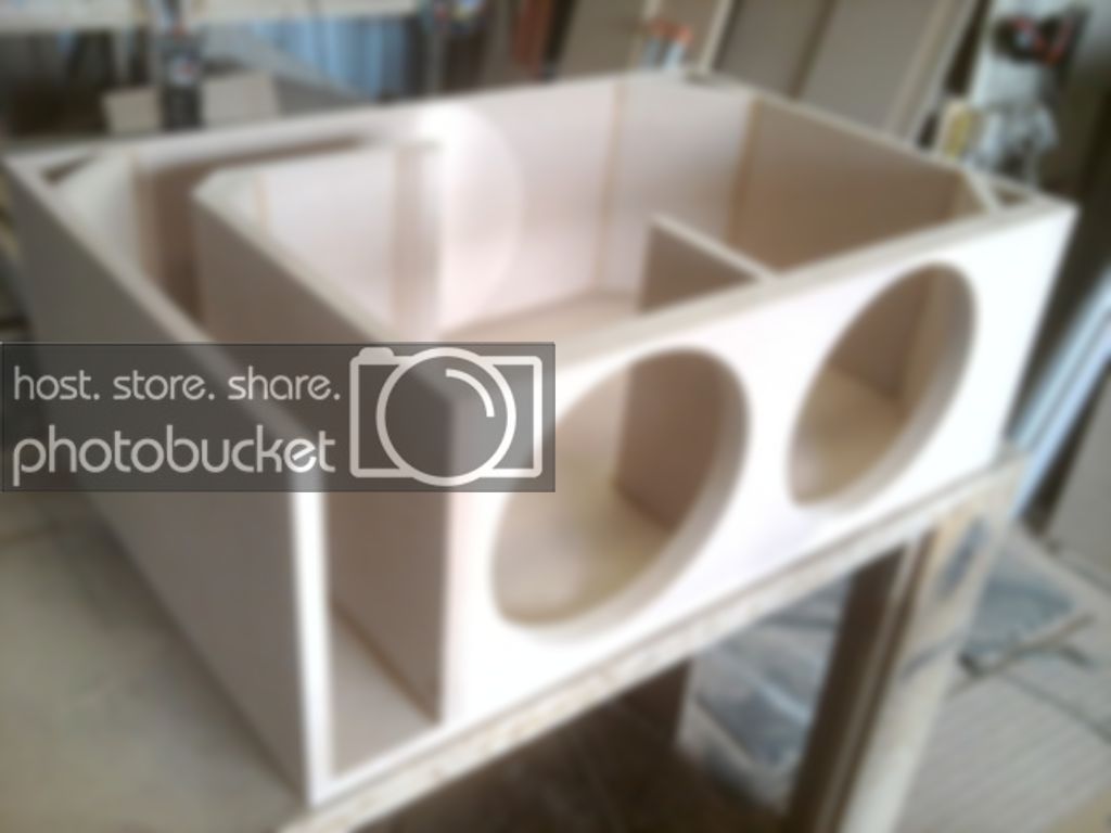

Get 'er unclamped, last 45 put in, and cleaned up...

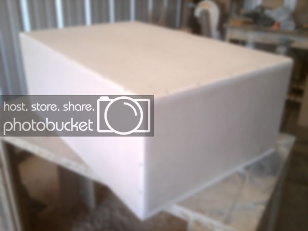

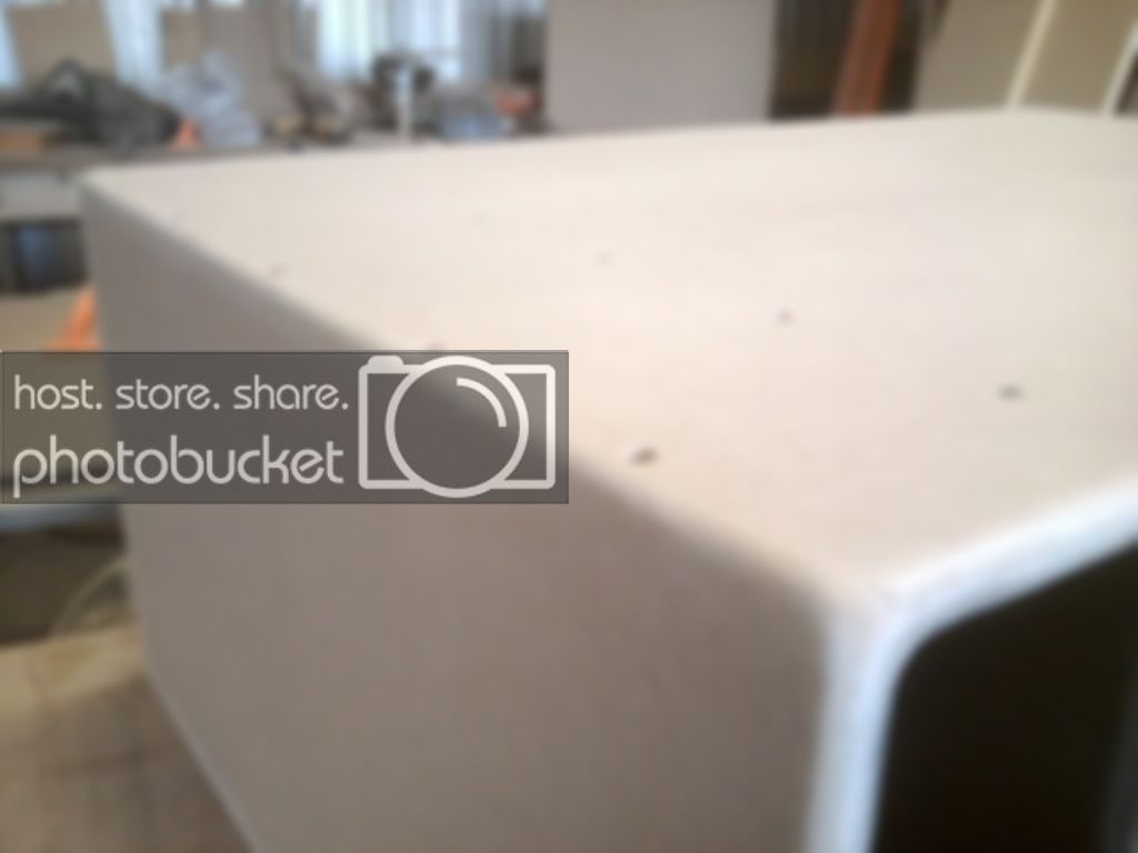

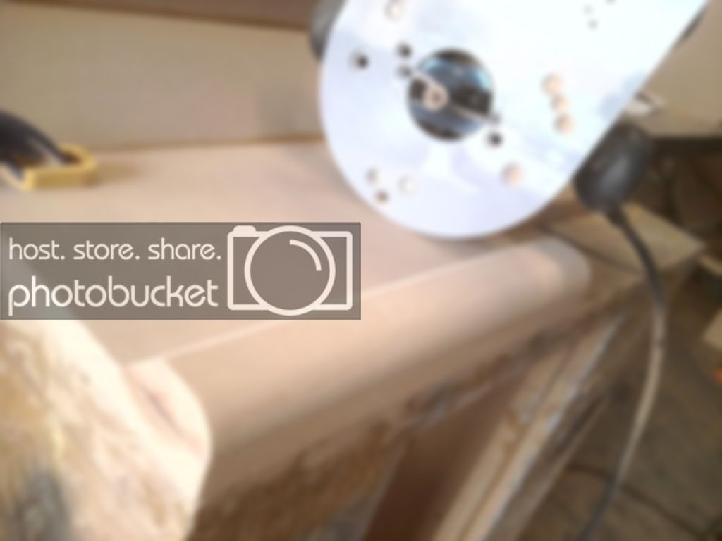

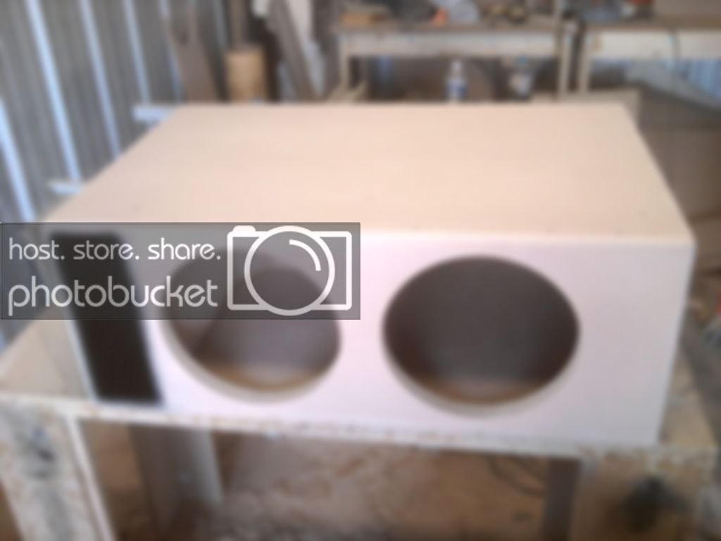

Top on, corners rounded over, and port painted //content.invisioncic.com/y282845/emoticons/smile.gif.1ebc41e1811405b213edfc4622c41e27.gif

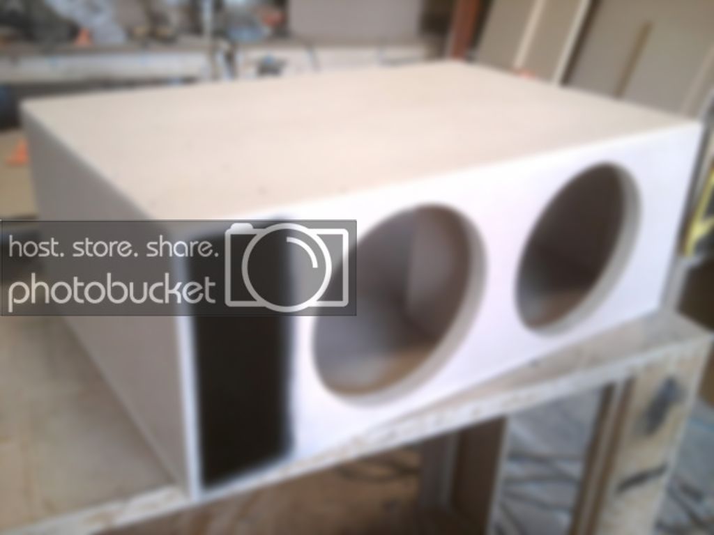

Schwing! //content.invisioncic.com/y282845/emoticons/smile.gif.1ebc41e1811405b213edfc4622c41e27.gif
Kinda sloppy, but I'm still getting back to it again //content.invisioncic.com/y282845/emoticons/smile.gif.1ebc41e1811405b213edfc4622c41e27.gif
Thanks guys.
As for the divider, I try and keep woofers separated like this most of the time because I like to see each side of the woofer seeing similar scenarios...without that divider the sides of the woofers facing each other would be pressurizing air towards each other, unlike the opposite side of each woofer.
