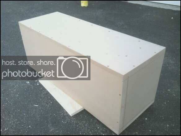

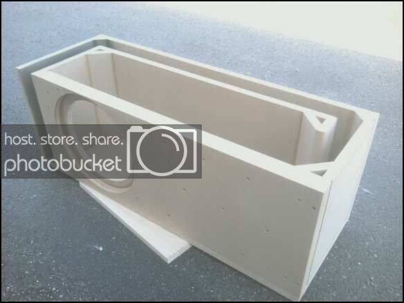

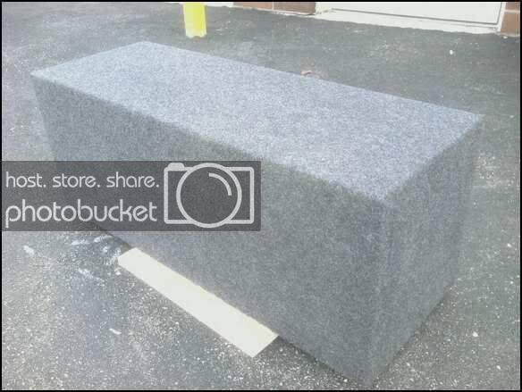

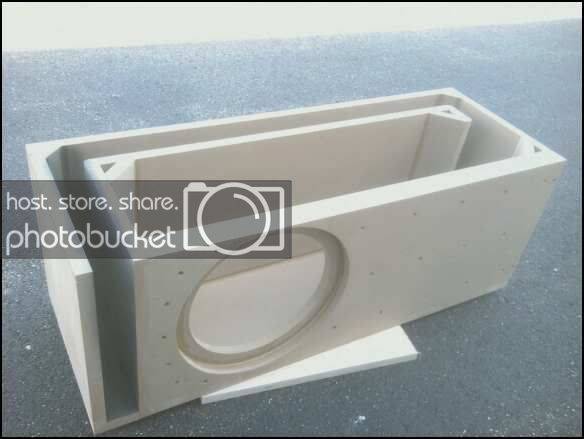

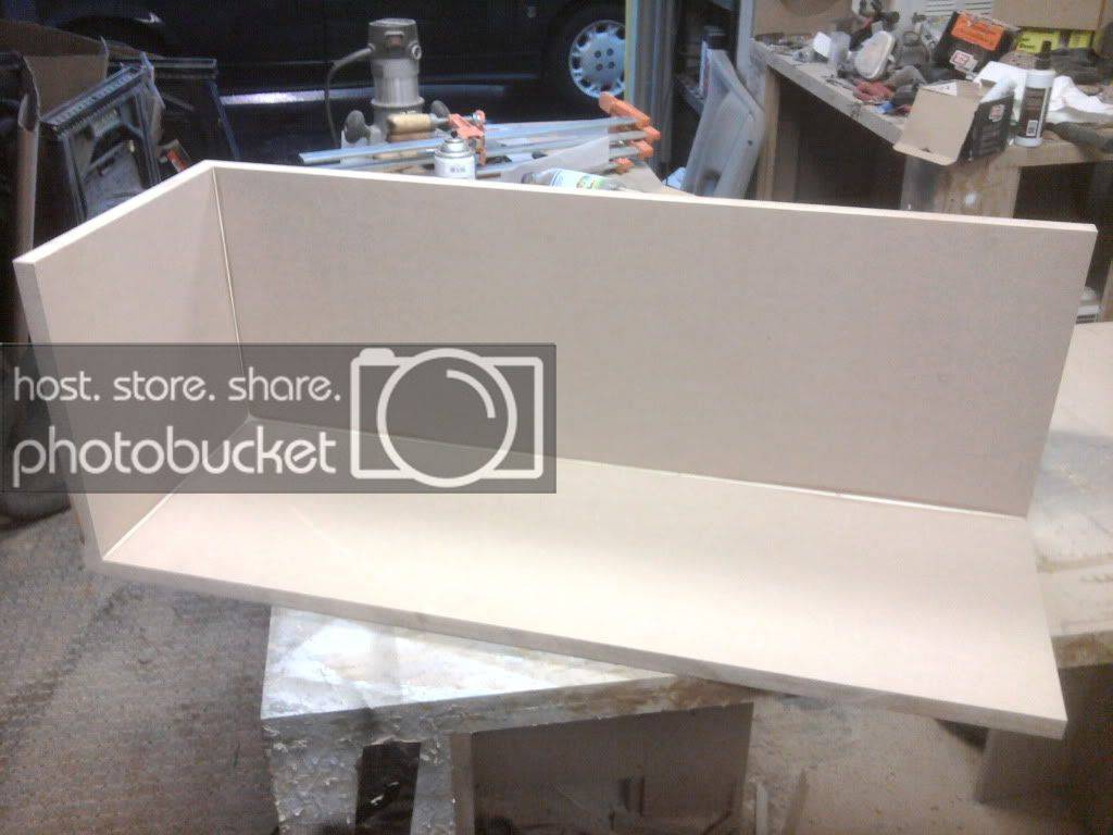

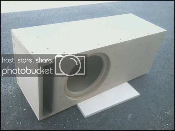

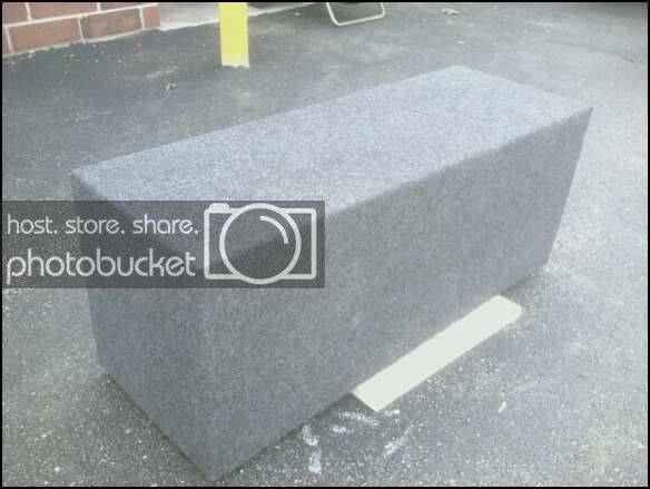

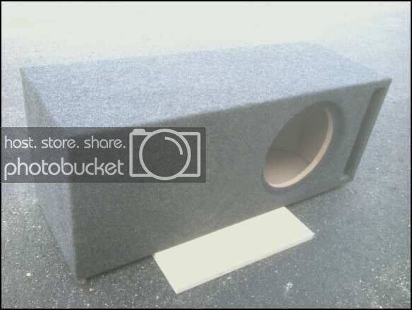

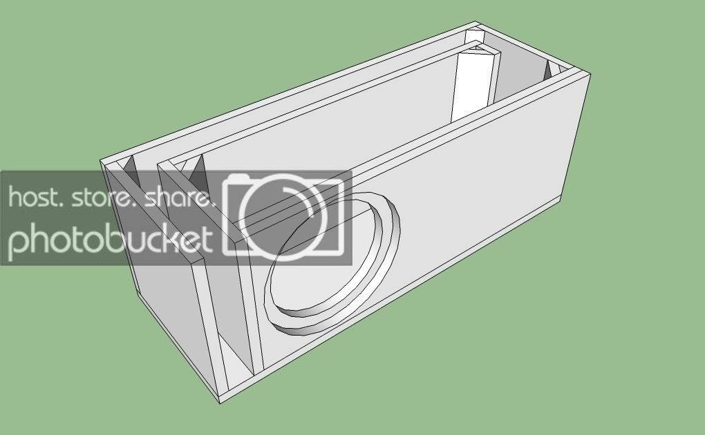

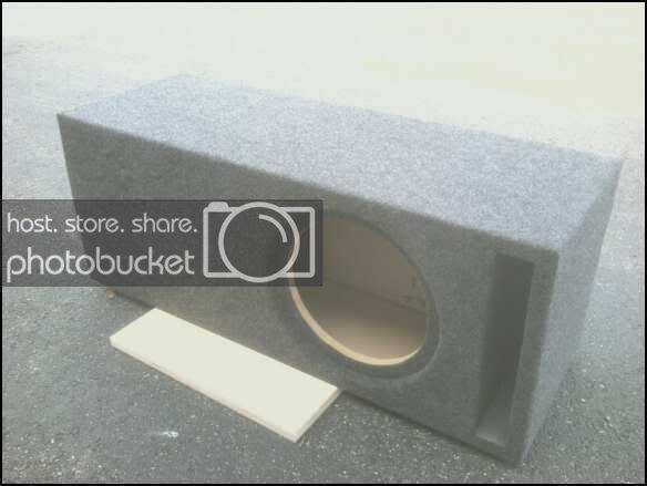

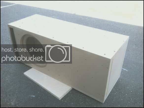

This enclosure will be for banks and his 10" DC lvl 4
Specs:
1.145 cubes net
32.5hz tuning
21.5625 sq inches of port area

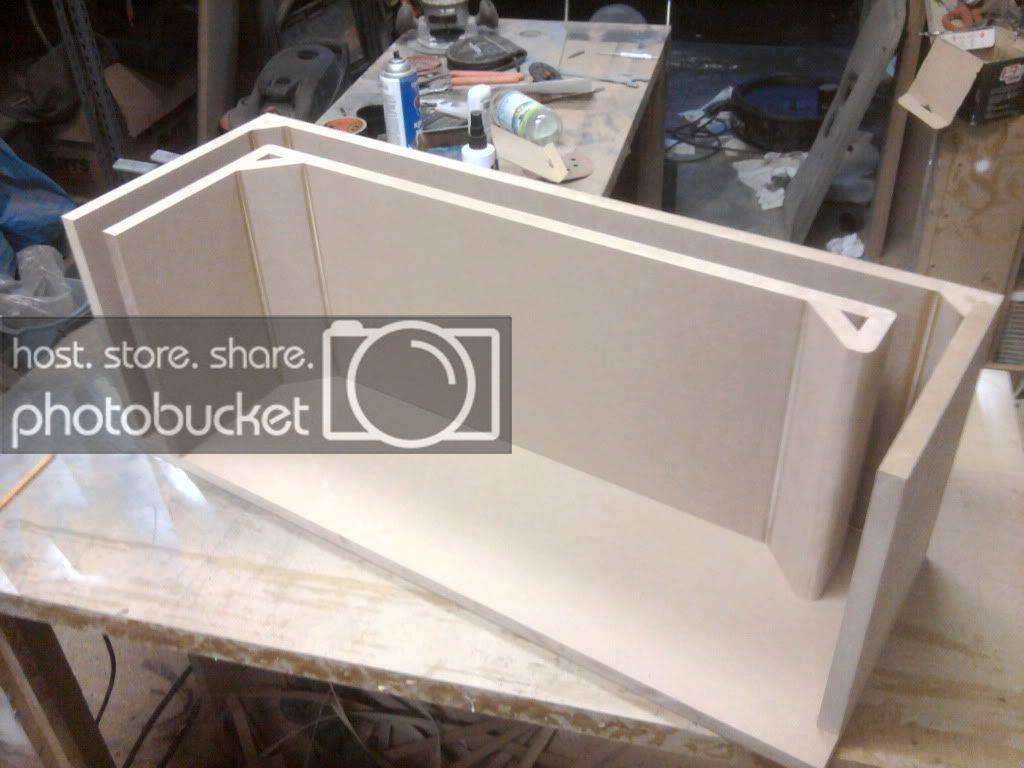

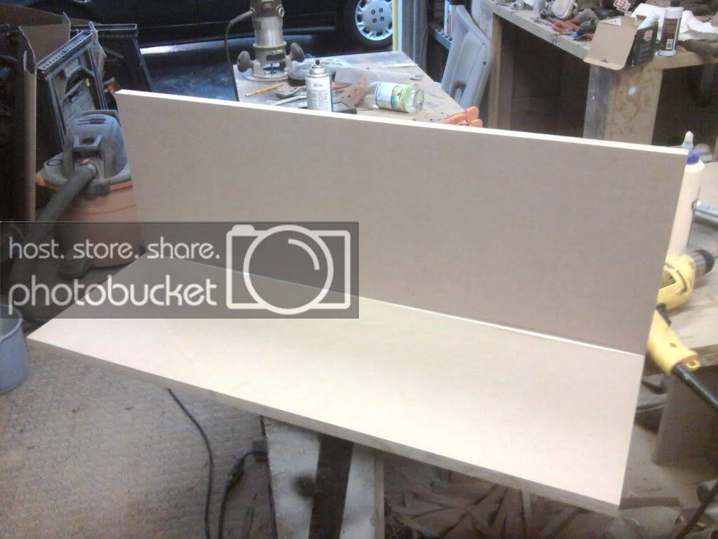

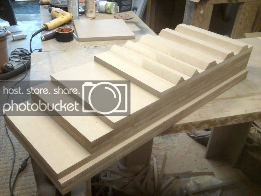

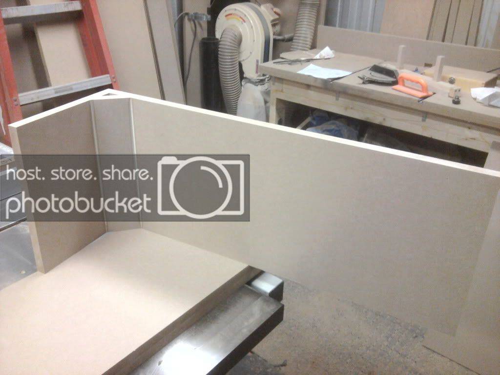

The Design:

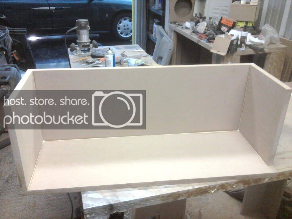

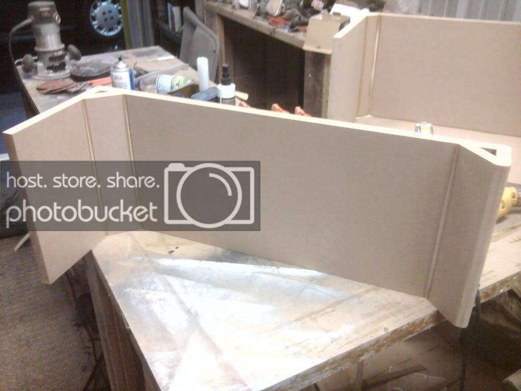

Pieces cut...
Onward...
Looks real nice saturn.. Friend has a lvl4 10 in a 1.7cf tuned to 34hz with 32sq inches of port and it sounds amazing. Only has 800 or so watts to wrk with so this is the reason for such a large box but even that being said he has yet to get it to reach its mech limits. It's not very musical but it does get loud so he is happy.
