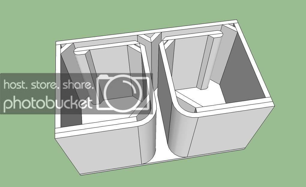

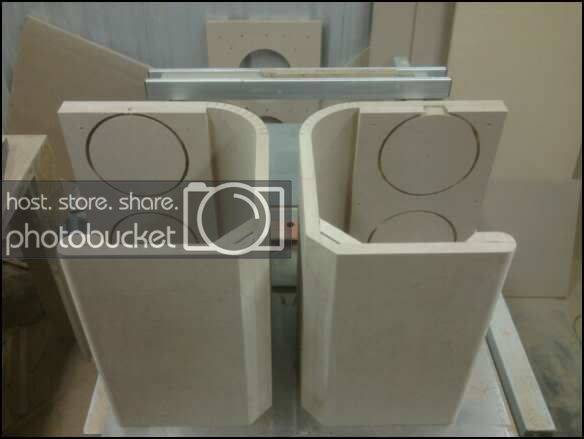

The design:

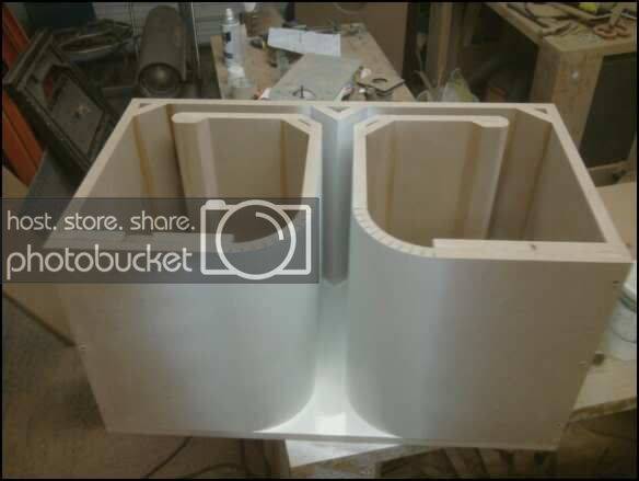

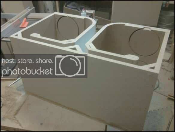

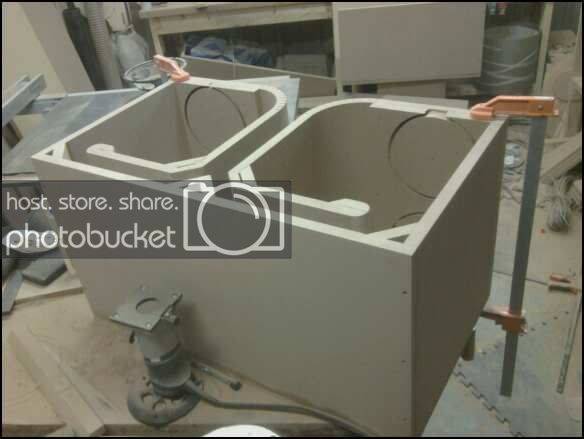

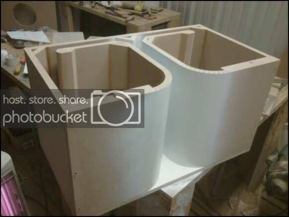

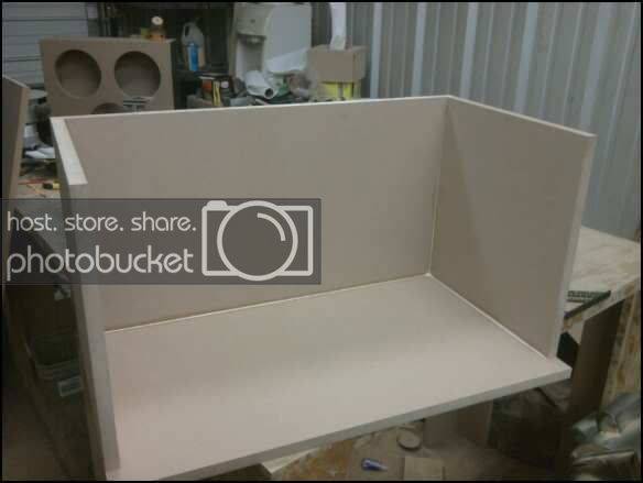

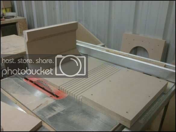

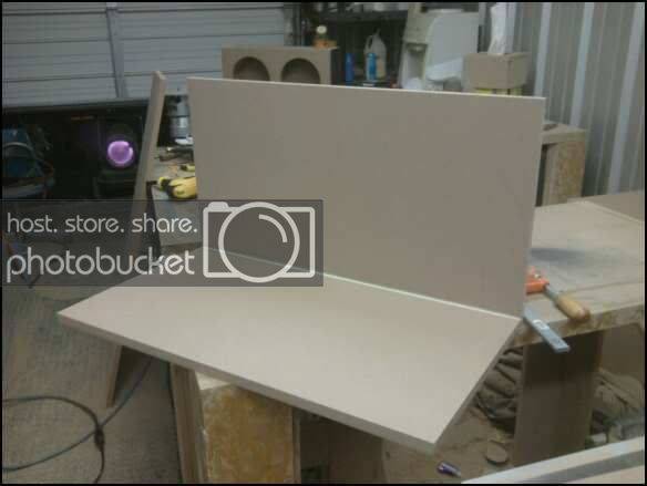

Majority of the pieces cut...
Back on...

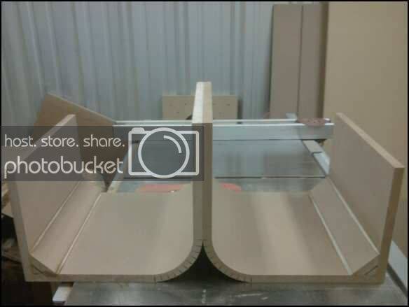

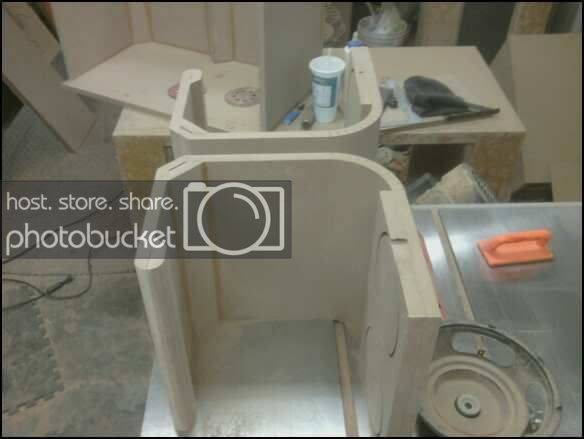

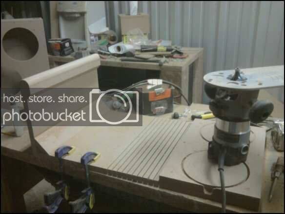

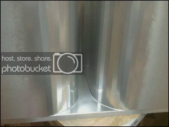

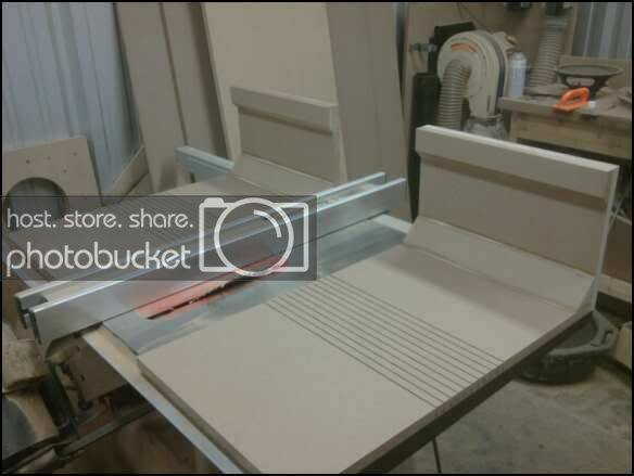

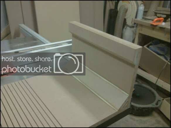

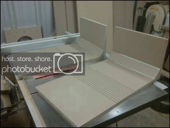

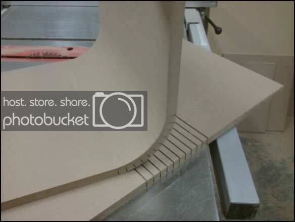

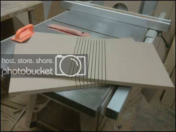

Kerf cuts made...

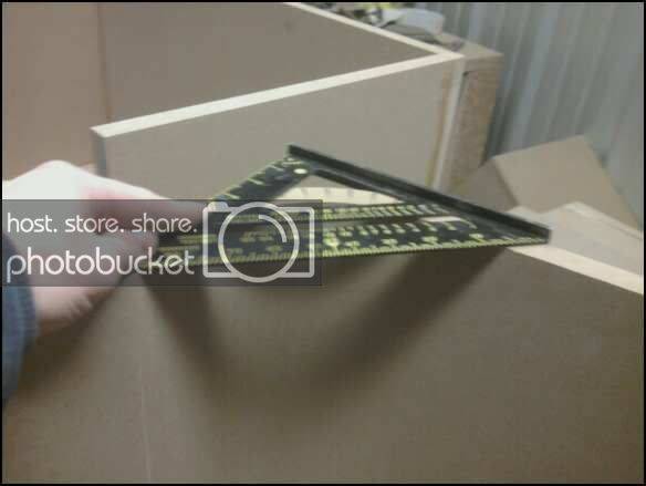

Makes a 90-deg turn when touching //content.invisioncic.com/y282845/emoticons/smile.gif.1ebc41e1811405b213edfc4622c41e27.gif

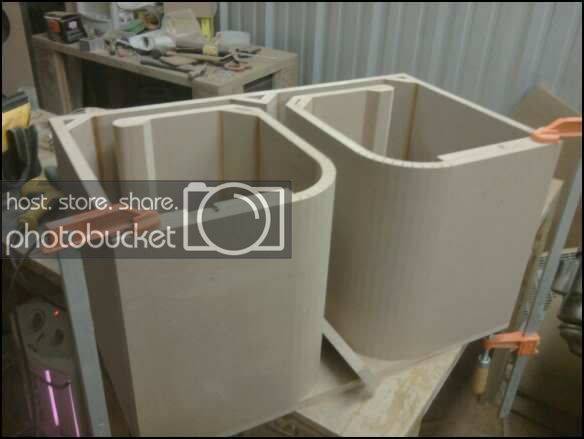

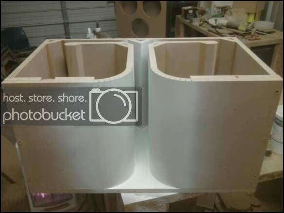

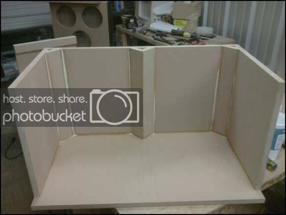

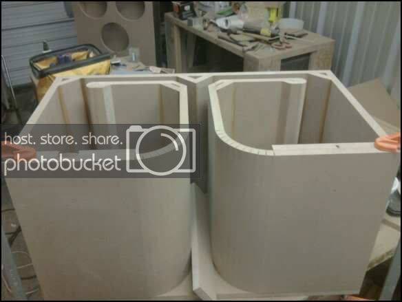

Got the kerfed pieces built up and almost done...
Hmm, seems to be working out ok //content.invisioncic.com/y282845/emoticons/smile.gif.1ebc41e1811405b213edfc4622c41e27.gif (though I got sloppy with the glue on the end there...was kinda ticked //content.invisioncic.com/y282845/emoticons/frown.gif.a3531fa0534503350665a1e957861287.gif )

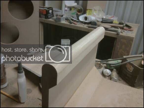

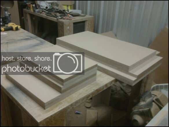

Built-up for the roundover on the port ends...
Both...

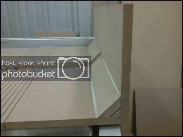

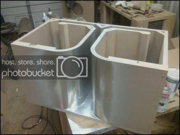

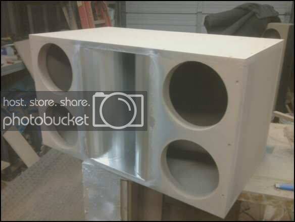

Got the 45's in for the corners and port center...
And got the 2nd layer to the front mounted...

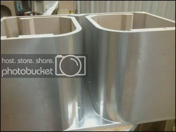

45'ed the port corner...

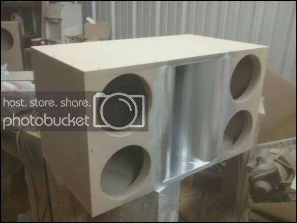

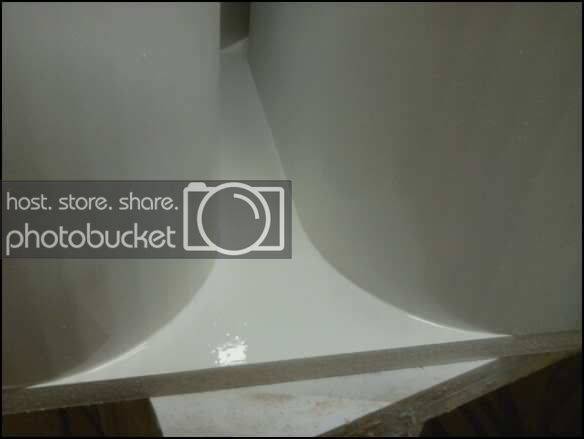

Had to wedge a piece of mdf in the port to keep the kerfs from coming together etc/holding right, so they arent sitting perfect but u get the picture...

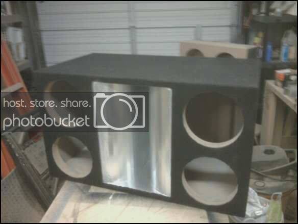

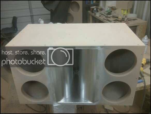

Got the port painted...

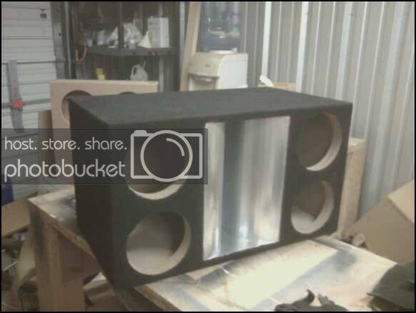

Done...
Sorry about the craptastic pictures //content.invisioncic.com/y282845/emoticons/frown.gif.a3531fa0534503350665a1e957861287.gif still havent found the charging cord to my camera so still using the phone's //content.invisioncic.com/y282845/emoticons/frown.gif.a3531fa0534503350665a1e957861287.gif
Thanks, but this enclosure isn't for myself...so I couldn't say how it performs etc. //content.invisioncic.com/y282845/emoticons/frown.gif.a3531fa0534503350665a1e957861287.gif
