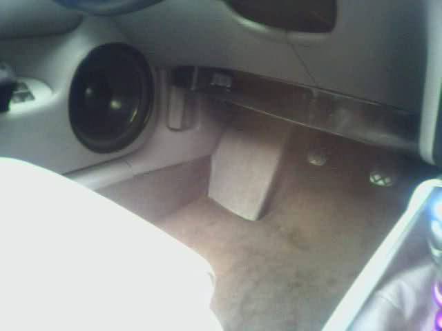

nother quick shot. i got some U shaped grommet shit that those cheesy people put on the edges of their doors and crap from pepboys. works well, has a bead of gooey shit to keep it in place. not the nicest thing ever, but looks a hell of a lot better than jigsawed doors lawl
hard to see, but when i get back to virginia ill take some better pixcures.
and thanks for the compliments everyone. so now you all know you can fit ~3" deep by 8" diamater midbass in volkswagon 2002~2005 golf\jetta\gti

****, only 2.95 inches?! I just installed the 7" power line CS woofers in my doors and they are 3.75 inches deep //content.invisioncic.com/y282845/emoticons/frown.gif.a3531fa0534503350665a1e957861287.gif Had to raise them off the doors 1.25" with MDF rings to make them fit in the doors of my '99 camry.
Your install looks clean man, nice job. I used liqud nails to seal up the gaps between the MDF rings and my doors - i don't think the non hardening clay stuff would handle the temps in my car in FL. Thx for the tip //content.invisioncic.com/y282845/emoticons/wink.gif.608e3ea05f1a9f98611af0861652f8fb.gif

yea i definatly would have to get kinky if i wanted to make a sealed enlcosure. i got like .2" of room behind the driver to the window lol. and sealed pods in a new stang is cheating. they come with stock sealed pods you jerk!

hey req, are those 8's acting as both your midbass and midrange?
i was assuming it was a 3-way system and those took over the midbass and you had a different set of speakers covering the upper freqs. am i wrong in assuming this?

They look pretty sweet. How are the doors holding up? From that wonderful cell pic I can't tell if you've deadened at all, but to the rattle the shit out of everything?
actually the doors have very minimal rattle. the inner door skin is a 1\8 inch thick piece of solid alu with almost no holes in it. the small ones that were there i covered with aluminum tape. (talking like four 1\2" holes in random spots). and this piece of aluminum is bolted to the inner door frame that connects to the hinges. all the way round the seal from the aluminum to the steel is a rubber grommet between the two pieces of metal.
its quite a solid ****in door. door handles on the outside rattle, and the door locking mechinism rattles a little. ill see what i can do about it but im sure not much.
and george, the horns play (as of today) from 1.2khz@30db to 17khz@12db, and the mids play from 31.5hz@18db to 1.2khz@24db. so yes, they do play the bottom octaves of the midrange. but the horns take most of it for them. active 2 way for the win.
