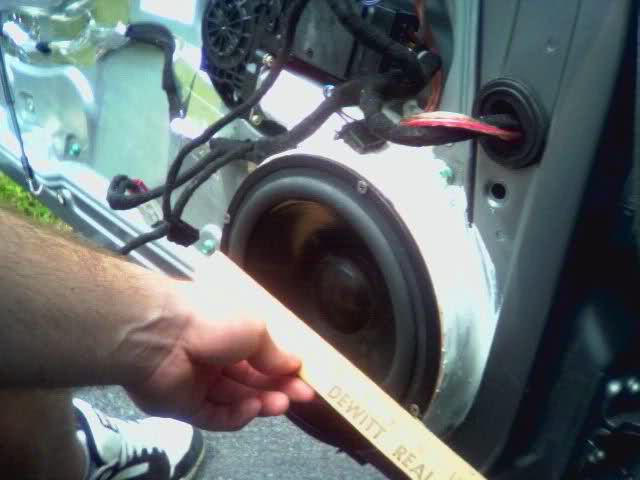

2003 volkswagon gti 1.8l turbo
alpine H701
alpine 9830
memphis mc3004
image dynamics cd2 hlcd mini lens xover @ 1.8khz\30dboct - 17khz\12dboct
seas ca21rex xover @ 31.5hz\24dboct - 1.8khz\18dboct
seas fr
just playing around with the crossovers, i need my RTA from virginia to proceed with the tuning of the 31 bands of eq. i cant wait for it to sound better than it does.
and they play down to 20hz. its fantastic.
I'll be adding my IDQ8's to my doors in the next few weeks. But I have to say... mounting them to the sheet metal is the easy part. Lets see pics with the interior panel back in place (modified I assume), then I'll be impressed. //content.invisioncic.com/y282845/emoticons/wink.gif.608e3ea05f1a9f98611af0861652f8fb.gif
slightly modified. had to remove one pressure fitting thing in the corner. and i had to take the stock 6.5" grill and cut it to acomodate the 8 because the cone was hitting the back of the door panel. im gonna fab up some simple grill cloth covers and it will look like stock again //content.invisioncic.com/y282845/emoticons/smile.gif.1ebc41e1811405b213edfc4622c41e27.gif
unless somone can find me some grey or black mesh 8" grills... its raining. and i dont have the cord to my digital camrea. so all i got is an email from my cellphone. lemme go take another one.
