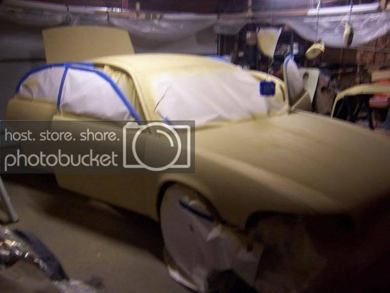

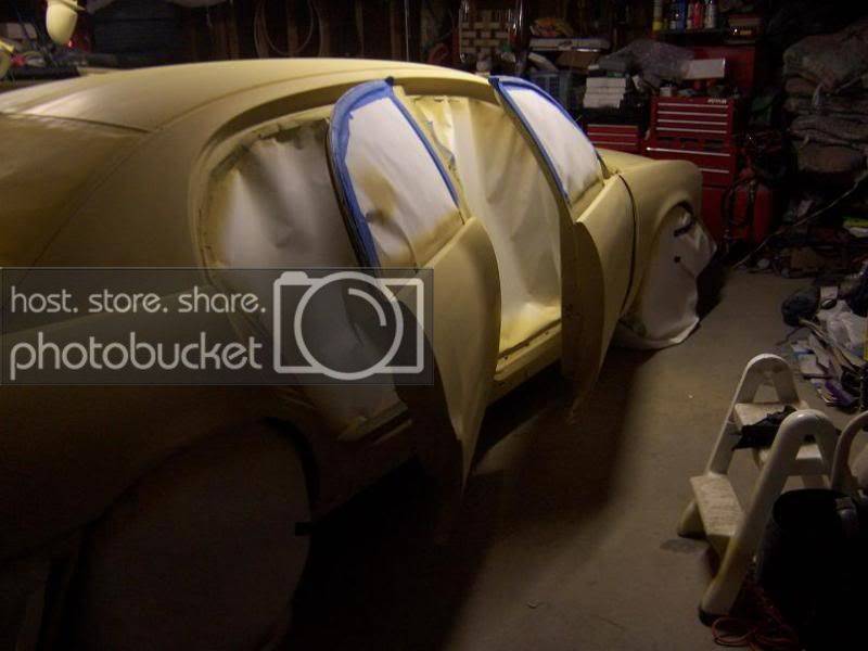

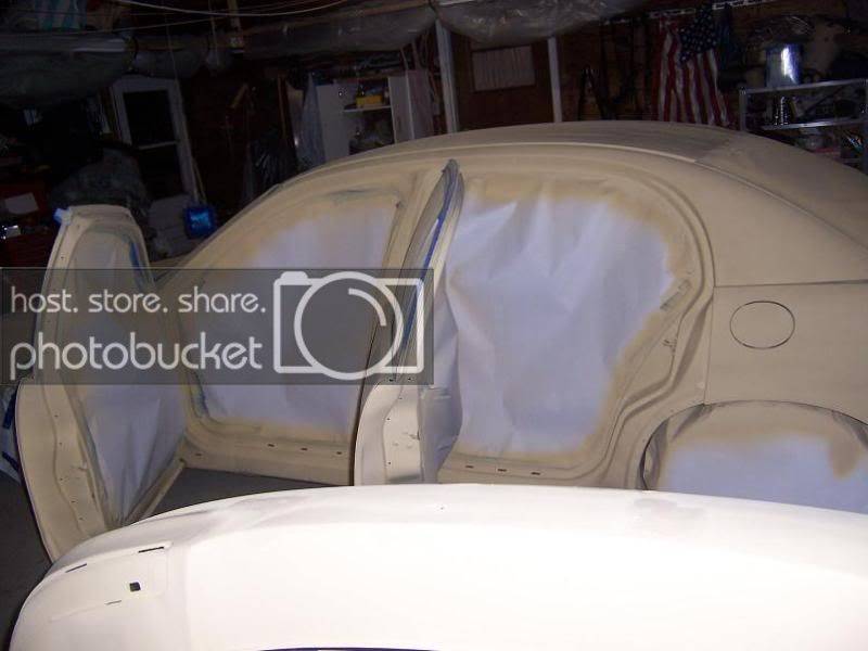

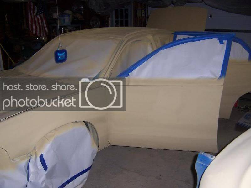

Primer turned out all tiger striped because the primer I was using was so thick and the gun just didn't want to shoot a decent wide pattern with it... it's all gotta get blocked anyways.

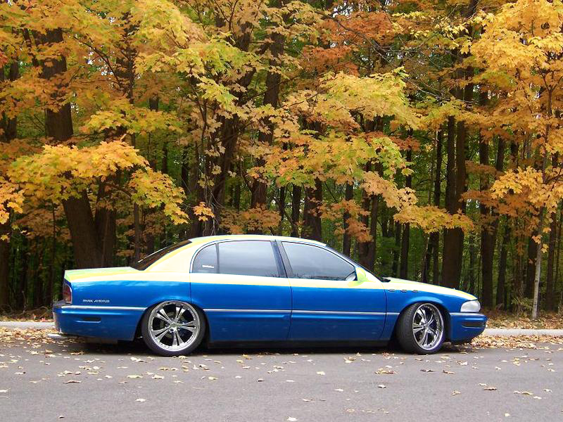

you gonna repaint those tweet pods and comp pods?...wat color you decide on reapint?
They're stayin blue, but they'll still match. Here's a photoshop of the plan

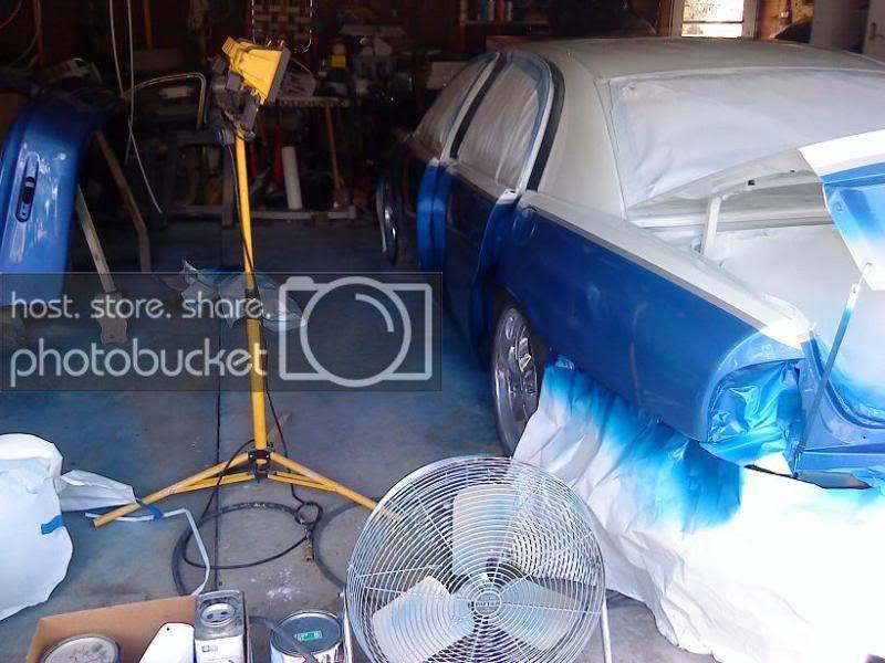

Bottom is gonna be the same blue, with a midcoat of clear w/ blue metallic mixed in. Top is gonna be white followed by midcoat of clear/white metallic. Finally the whole car's gonna get a coat of clear w/ purple and blue pearls mixed in to set it off in the sun. Then of course a coat of regular clear... or something like that //content.invisioncic.com/y282845/emoticons/crazy.gif.c13912c32de98515d3142759a824dae7.gif

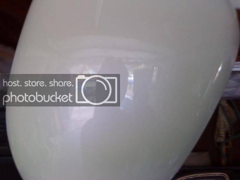

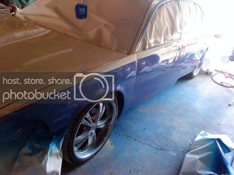

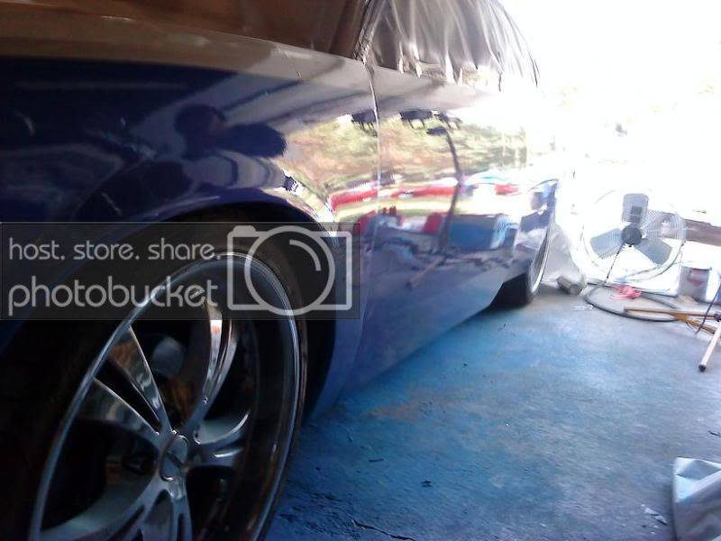

Ok. I've got some wetsanding to do. Me and clear don't work well. The positive part is that the clear layed out good (good enough for me). The bad part... I got a little heavy in some spots. Hmmmm, I think I can fix it.
Ack!!

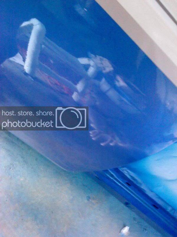

Purple pearl coat..
Lets play find the runs..
