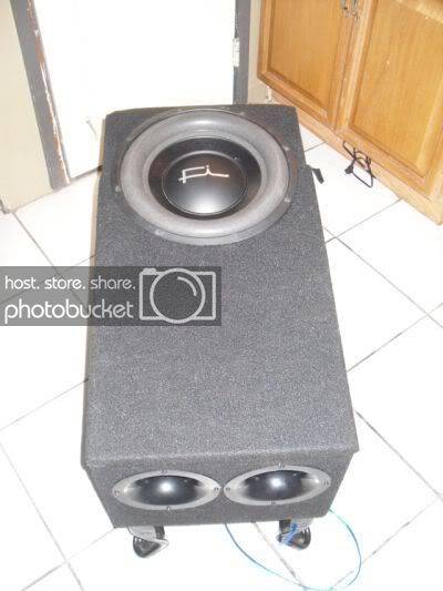

If i decided to port this box how do yall think round ports would do or would that be a waste of time, if so Id just build a new box rather then take this one apart and build a port on it but if rounds will do I can just cut out the holes and drop them in and seal them.
My box is ported using Aero's
