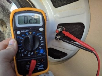

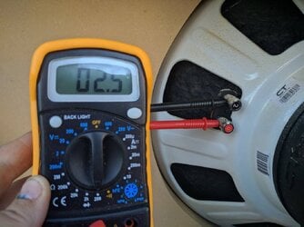

I saw 1ohm I have two so in expected much closer to .5, thinking one was disconnected I cut into the back of my box (4th order with no removable panel) all the connections were perfect so I checked the impedence of all the coils. Then the impedence of two coils then again the final load.
2.5-2.6 per coil.

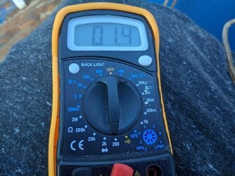

1.4 with two coils

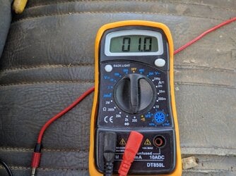

1.0 with all four coils.

Some pics.
