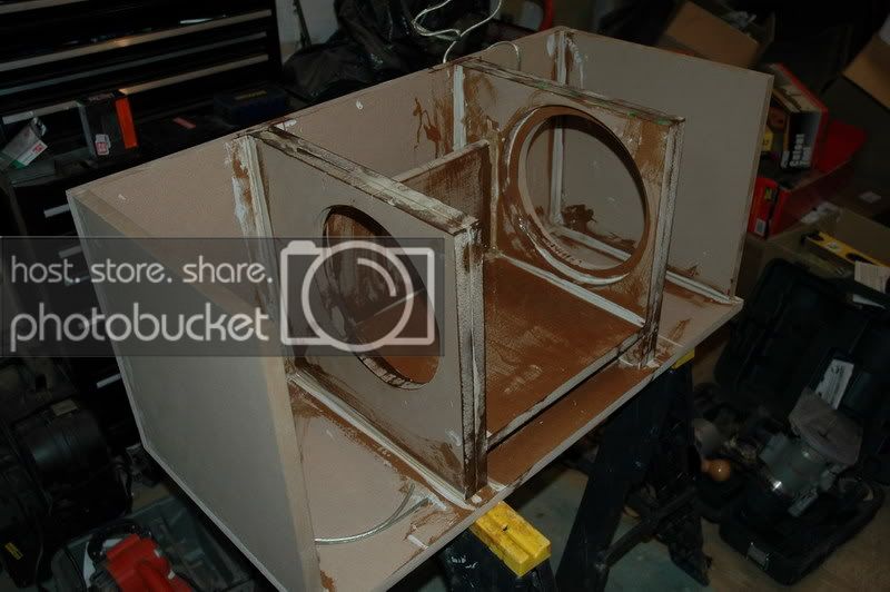

I don't have the exact information with me but it is somewhere around .8 cu/ft on the sealed side and 1.3cu/ft on the vented @ 52 HZ. This will be 100% different for every driver and passband, so don't use it to base a design off of.

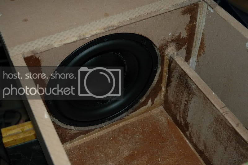

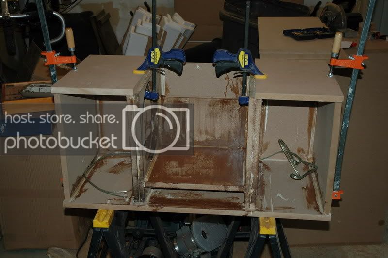

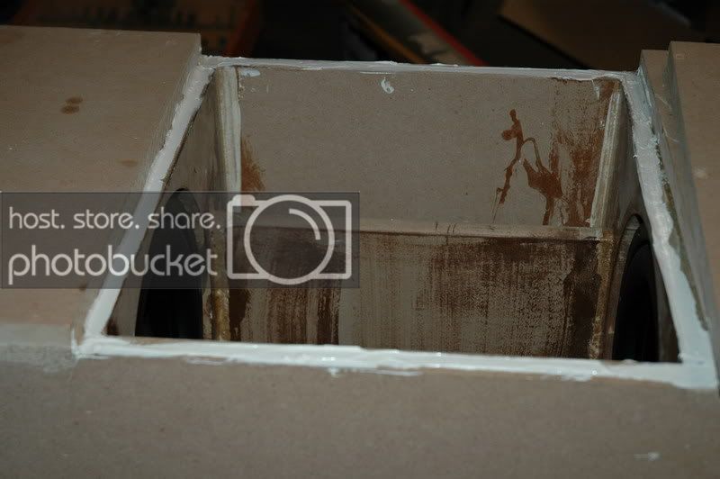

Here is a pic of some resin I layed down to firm up the seals after cleaning up the "MDF glue" ... I'll put a couple more coat before I sand it down and do some painting...

ofcos, I just wanted an idea of the size. so its around 3cuft!
Yeap, that’s about right.. It would have been much smaller if I decided to put both subs in the same chamber or ran them isobaric (that will be my nice design for my set of AA 8’s)
godforbid that resin looks ugly. but other than that keep up the good work //content.invisioncic.com/y282845/emoticons/smile.gif.1ebc41e1811405b213edfc4622c41e27.gif
Really doesn’t have to be pretty, just needs to reinforce the wood some;)
After I test the design and see if I want to keep it, I might paint the inside and put a piece of fiberglass over the vented area so you can see the subs.

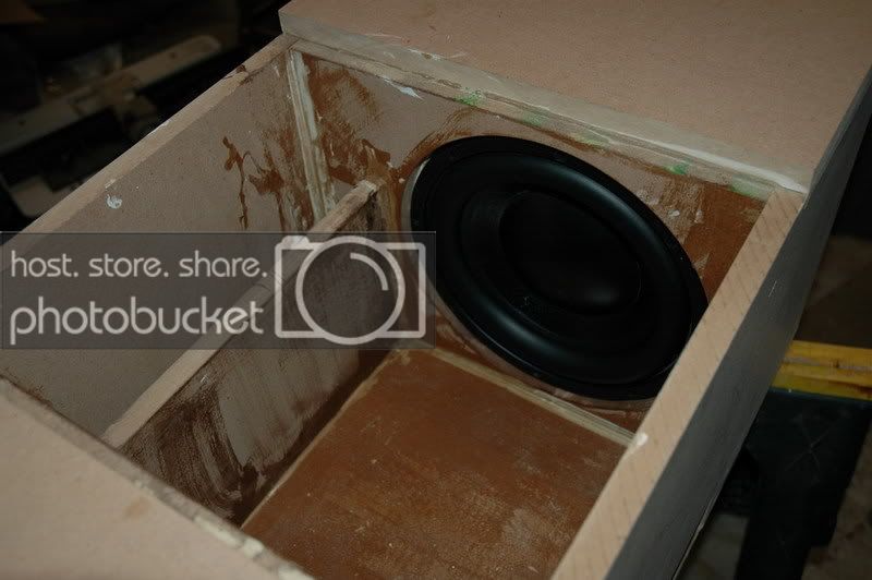

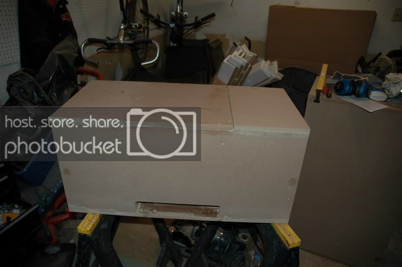

Here are some more pics... the box is about complete. Just need to clean it up and in stall the drivers and the vents top panel.
Sealed box tops.
Front panel install.

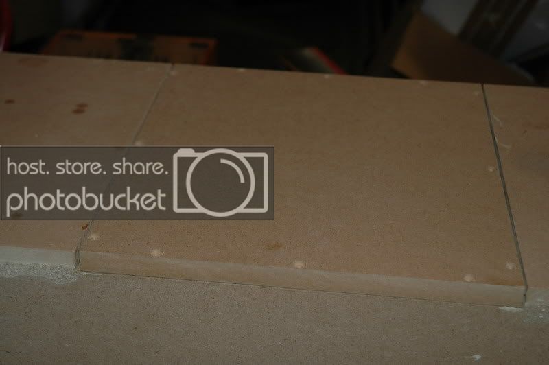

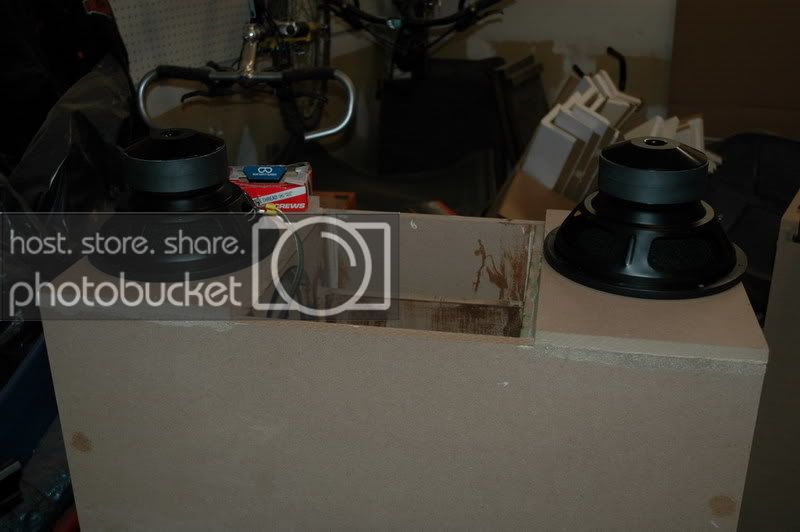

I split the top into 3 panels and the vented area (you will see in the next couple pics) will be screwed in and gasketed.

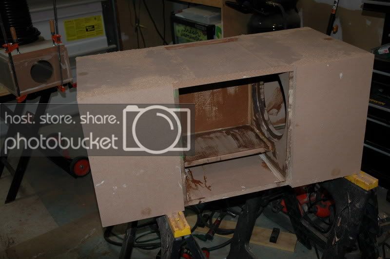

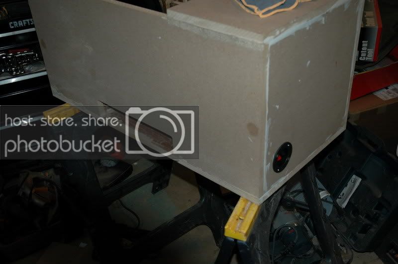

Haven't had time to post pictures. Here is the box about complete. I am building a "testing station" as my car is forsale so there is no wiring in it.
Terminal (wired to 2 Ohm)
Sub Placement 1
Sub Placement 2
Countersunk Top Panel
Caulked Top
Complete box ready for test.
I'll let you know how it worked out when I get the station together.
