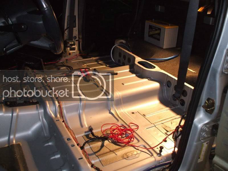

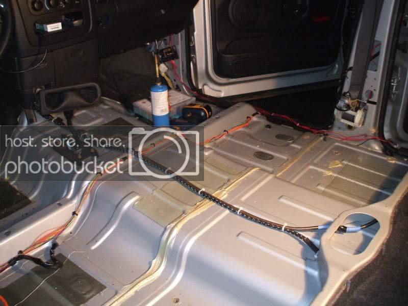

As of right now the old setup is out, the rear seats are out, the new head unit is installed, the front deka battery is installed, and I've began some under the hood wiring. Most of the under-hood and engine ground wires are done.

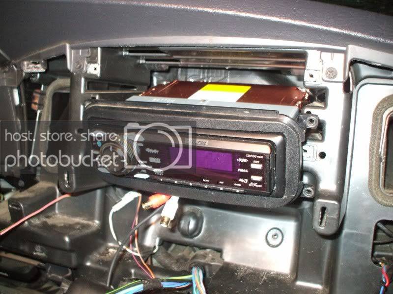

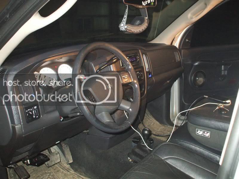

Installing the Eclipse 7200mkII Head unit. Copper chassis, 8v preouts, deadhead, usb, etc. So far I love this headunit. I'm most fond of the built in X-over and PEQ settings.

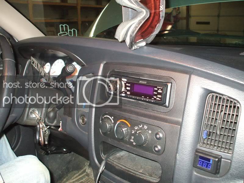

Head unit installed, also notice the aux input coming through the center cubby, and the Stinger voltmeter to the right on the dash.

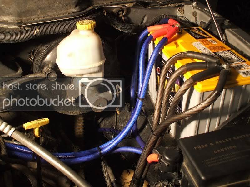

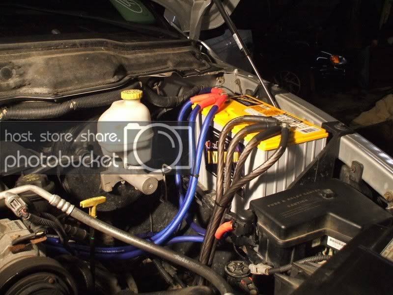

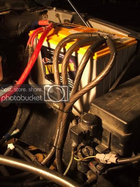

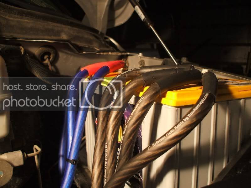

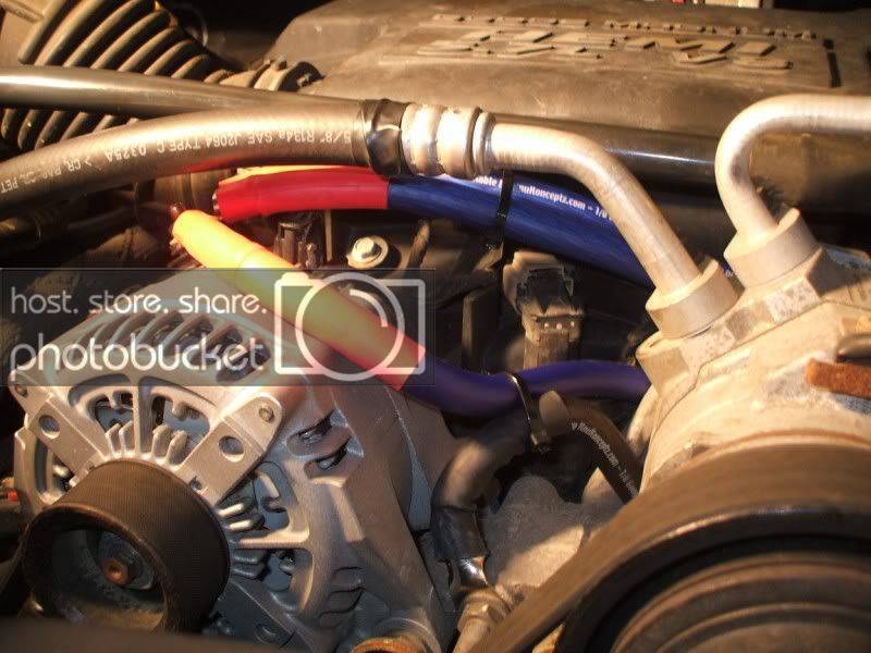

Front (underhood) Deka 9a31 installed, and ground wires installed. Don't mind the positive side, its not finished yet. I was contemplating on having some CNC'd 1/0 input blocks made for the front battery but I really like the sure tight worry-free connections from the bolted down ring terminals so I'm on the fence about it.

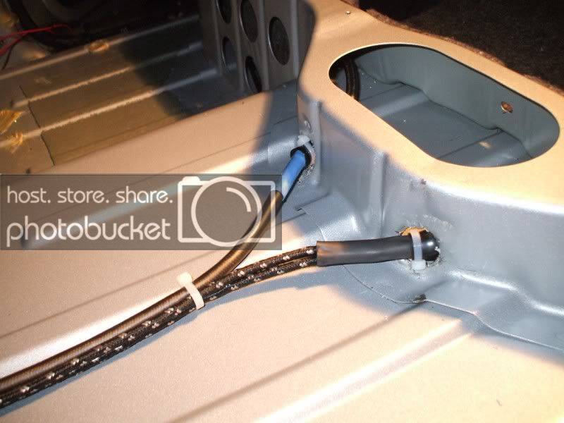

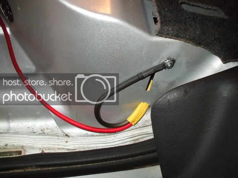

All of my connections are fully soldered, and are sealed in black or red heat shrink tubing. Black for grounds, red for positive wires naturally haha. Here's a few pics showing my soldering and heat shrink connections. Not too bad for only my 3rd time soldering terminals. I'll never, EVER go back to crimping on a ring terminal again.

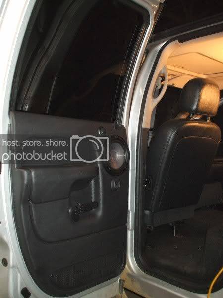

And finally here are 2 pics of the truck when I first bought it over 1.5 years ago. Obviously the truck still looks generally the same however these pics are old and I'll try and get newer pics asap!

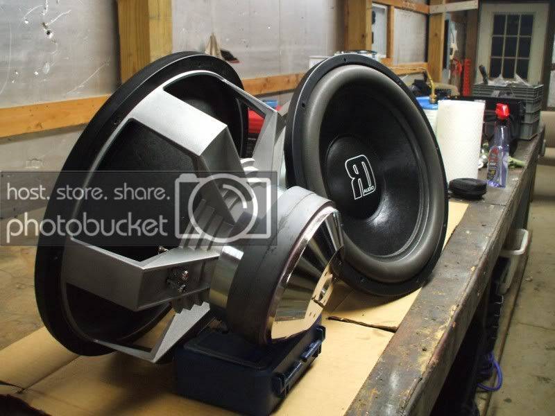

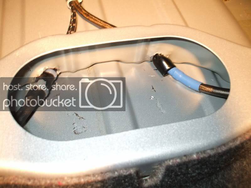

2 RD Audio Heavyweight V2 18's, dual 2 ohm each.
