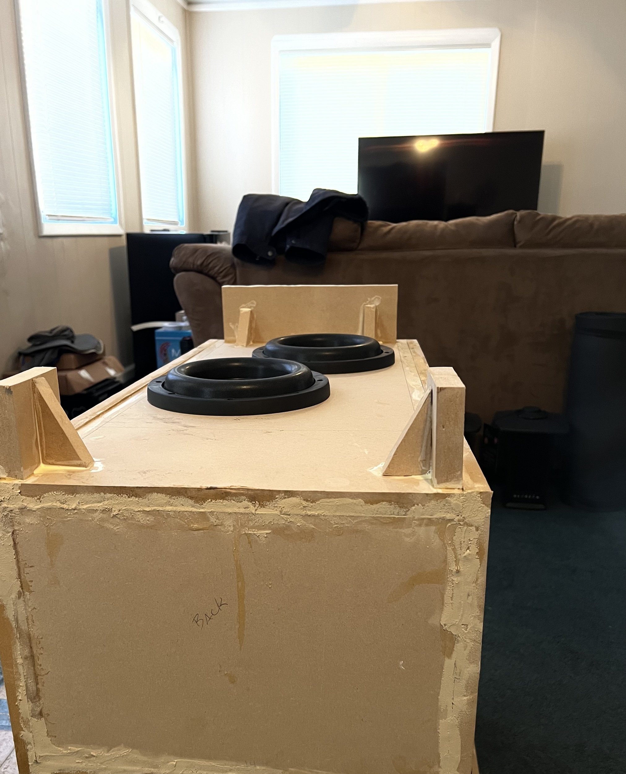

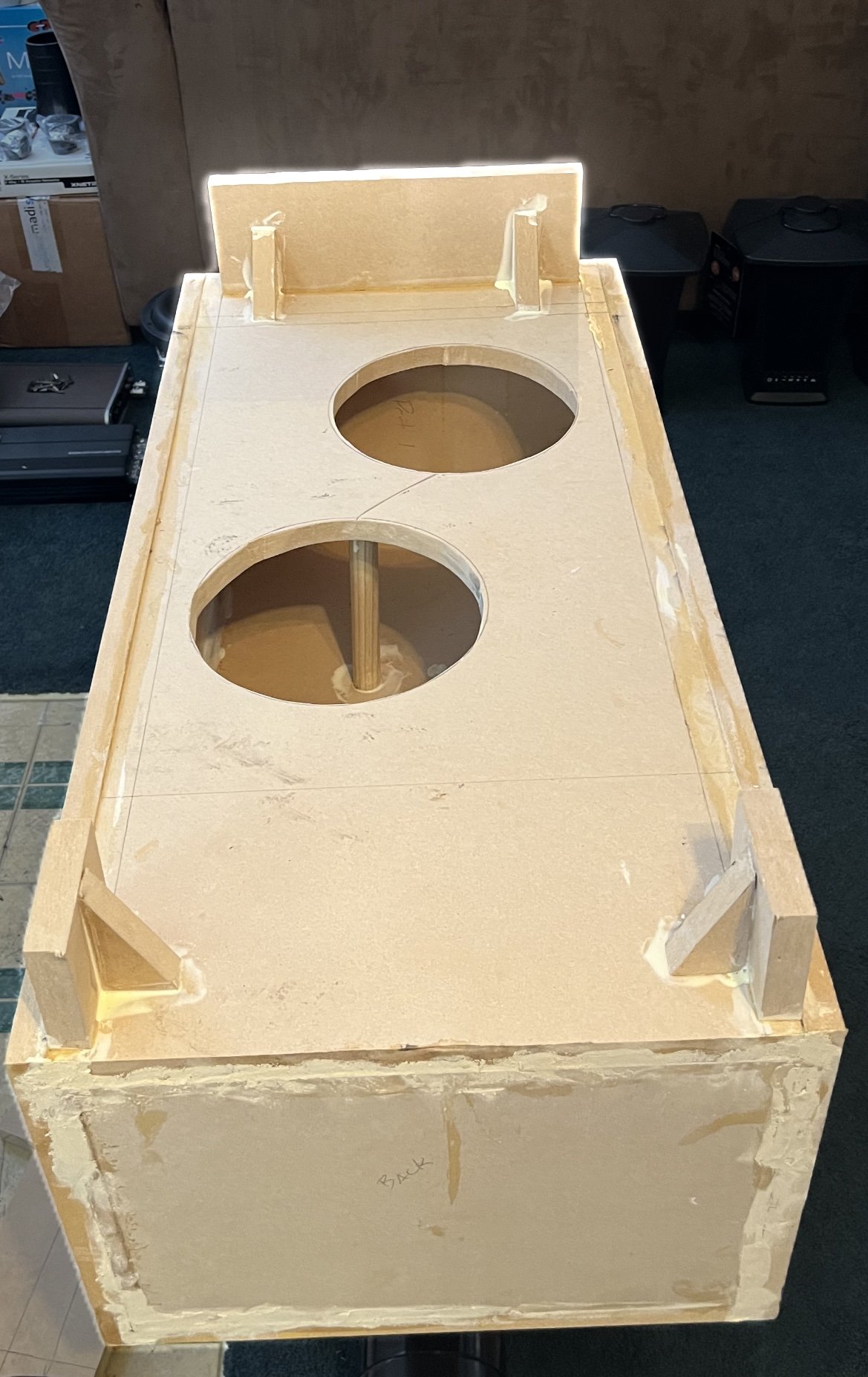

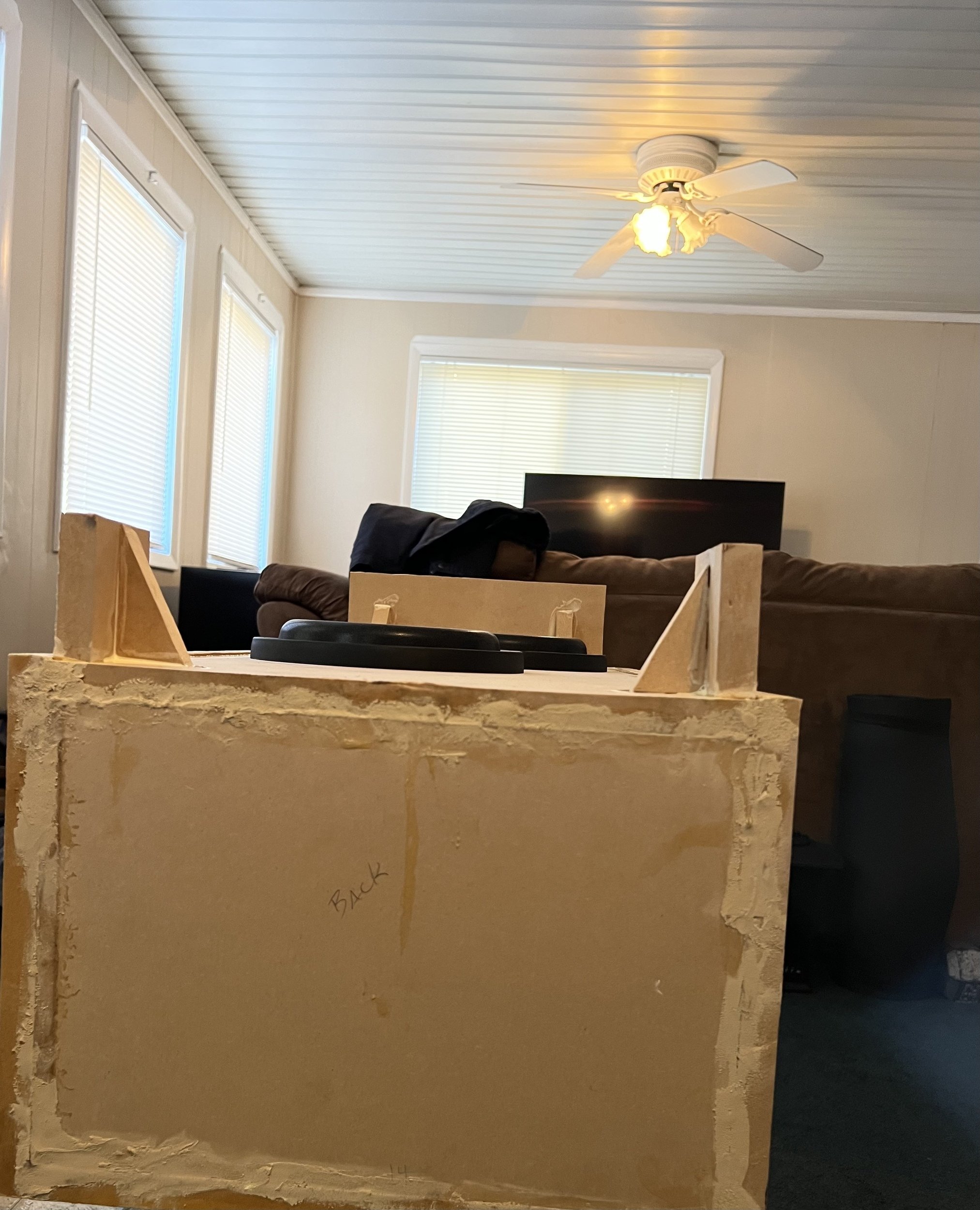

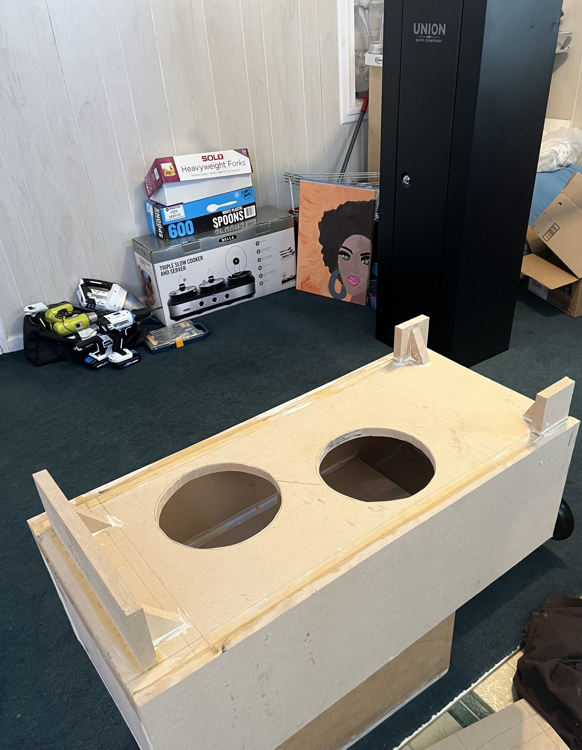

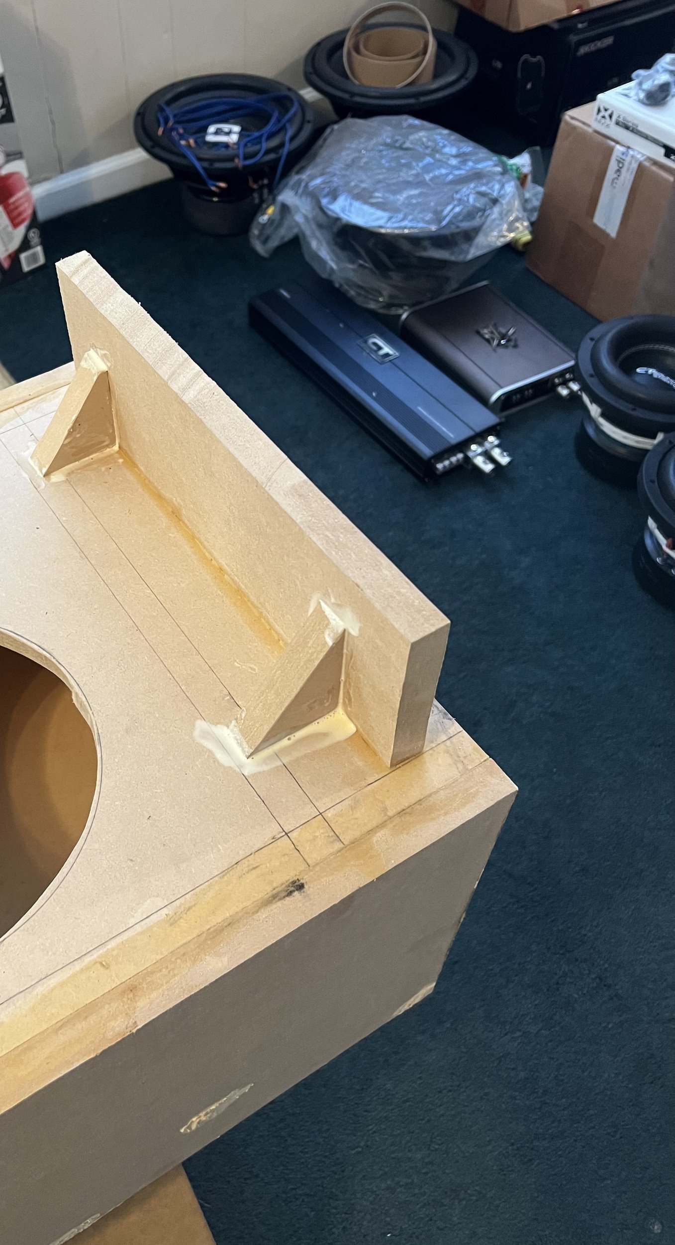

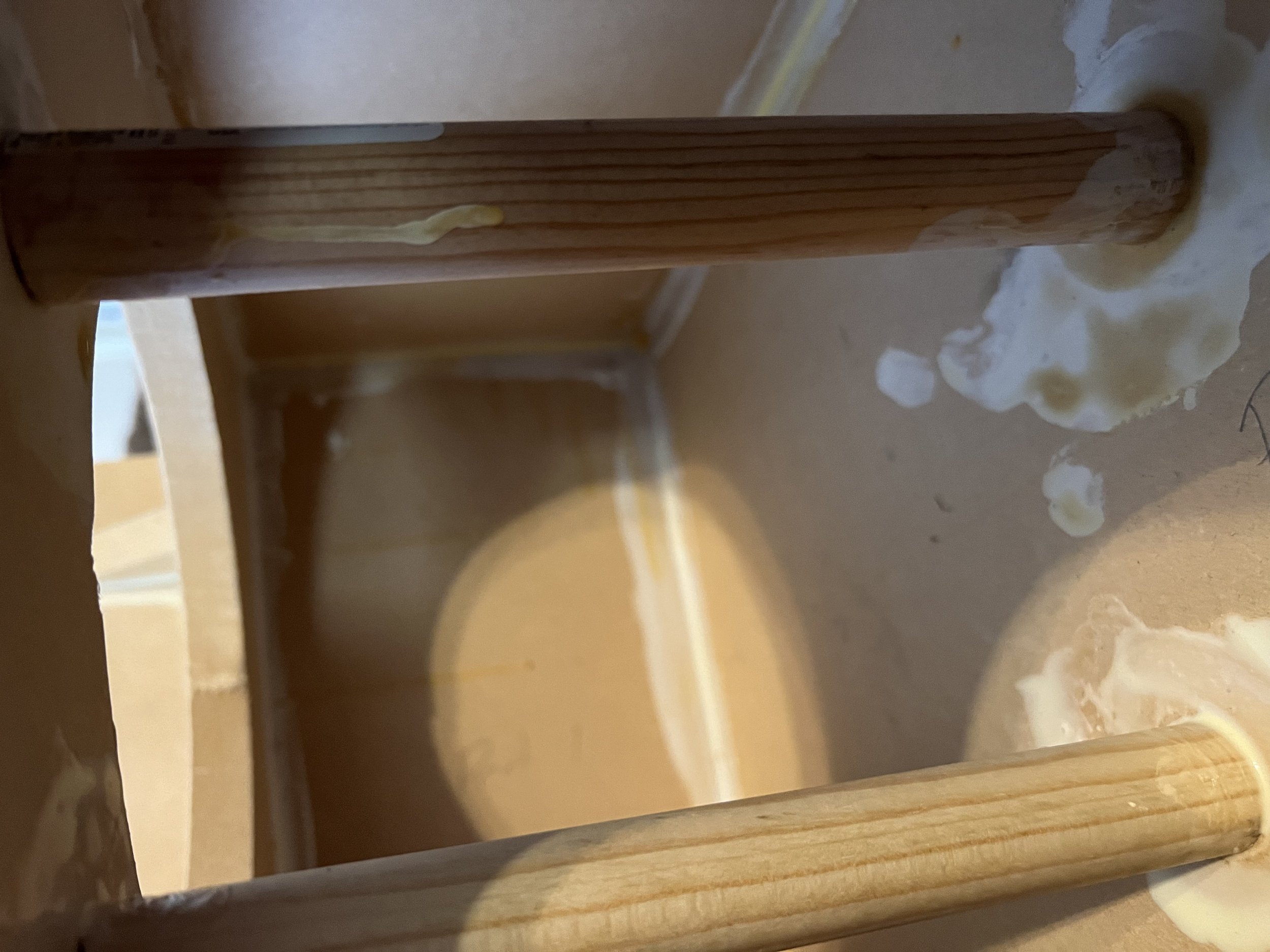

Between the cold weather and taking care of my wife, progress is slow. I did add some bracing inside and out some feet in the enclosure. It’s lifted 3” in back and 4” in front. (Die to ****** hump). Looks rough but promise it will look good in the end.
Nice. Should have around 160 cubic inches of play for bracing. I was doing 3 designs when I did yours and can’t remember what I had going through my head honestly. I usually don’t put the bracing into my drawings since I’m also the builder. I just do a set amount of displacement and cut the bracing with my cut sheet and try to fit it all in as I go on the build. I gave lazy drawings I do for myself. It could’ve been more detailed. Lol.
Lol, it’s cool. This helped me out a lot!! Box is pretty sturdy. I’m sure it will perform well!
It will for sure perform well. I’ve done similar setups with a few different subs. I had a similar downfire in my work truck chevy S10 for years. I’m doing a box now for a single 10 with a flared 3 inch round aeroport for an extended cab. It’s just a normal forward firing box though. The aeroports save quite a bit of space. I like them in truck builds.
Same. Love aero ports but in this case, I think slot works out better. Single cabs don’t have much room. Anxious to get this up and running.
