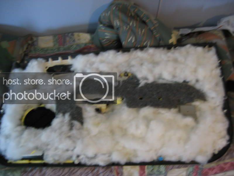

my door skins have expanding foam, some edead v1se2 and polyfil in them.
looks like a mess but it worked! //content.invisioncic.com/y282845/emoticons/smile.gif.1ebc41e1811405b213edfc4622c41e27.gif
