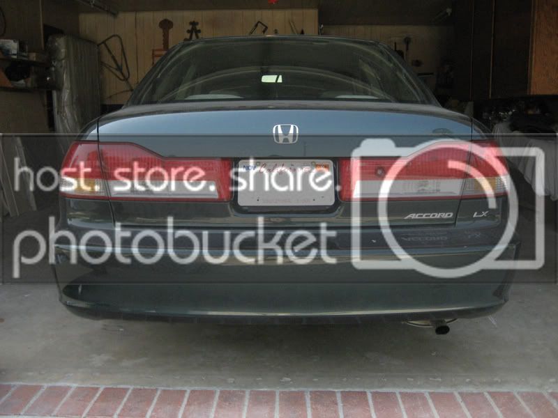

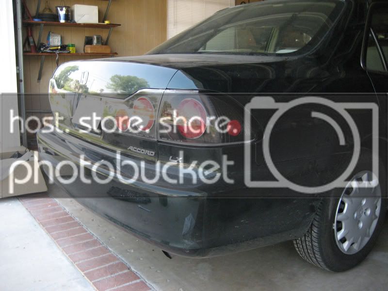

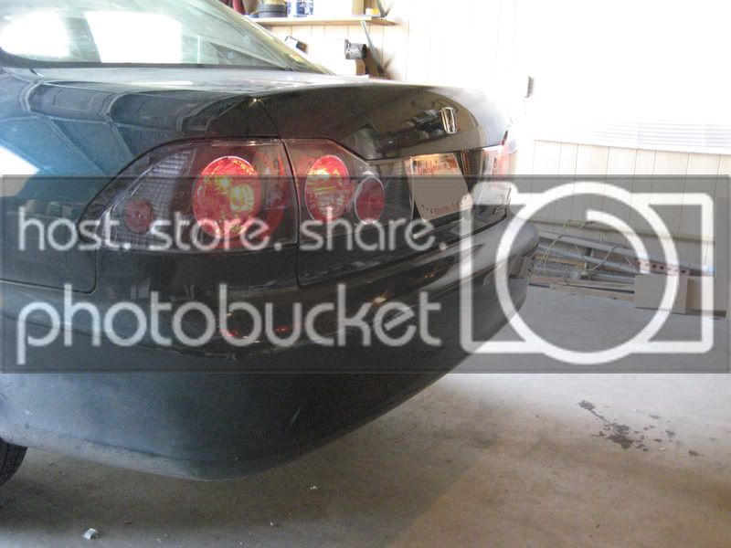

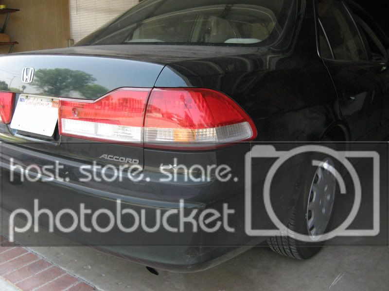

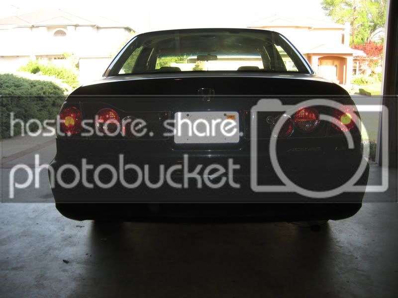

Here are before and after pictures.
Before:
After:
With the lights on (wasn't really dark out at all so you can't really see the full effect).
