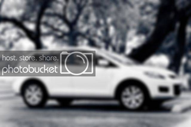

This is my 2007 Mazda CX-7 that I'm building to compete in USACi SQ shows in Mexico and the USA.
I'm part of Team Hybrids, the competition brand of Hybrid Audio Technologies founded by Scott Buwalda that sells some of the best speakers in the world.
This is my CX-7.

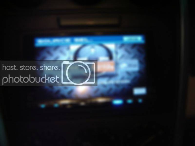

The Head Unit is an Alpine W205.

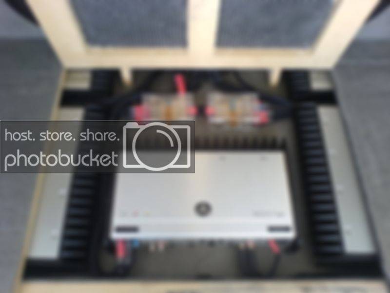

The music travels to the back via a fiber optic cable and also via Ai-Net cable, where it's processed in an Alpine H701, and sent to five JL Audio amplifiers hidden under a false floor.

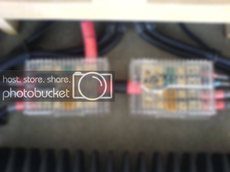

Power distro blocks.

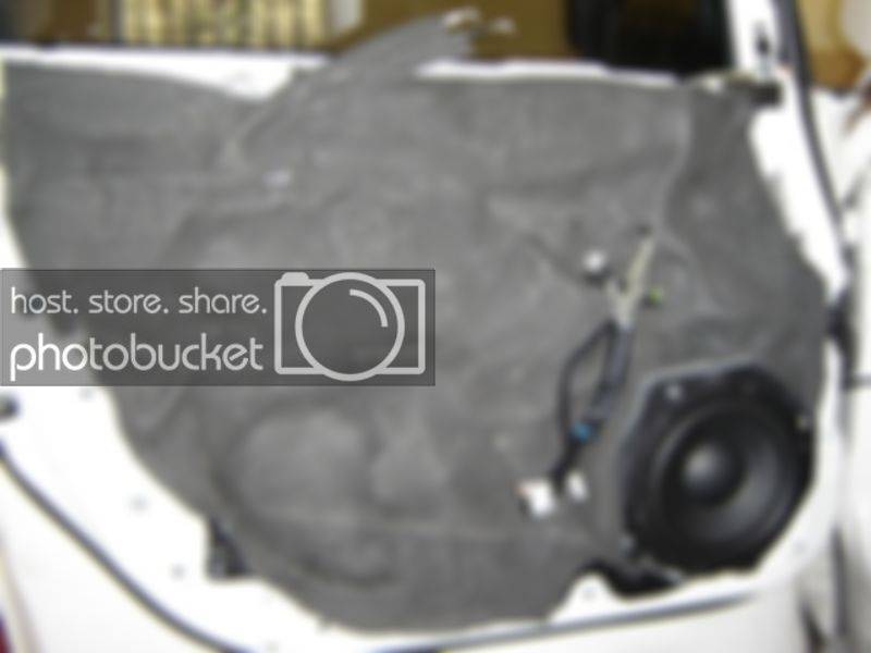

The front stage is handled by a HAT Legatia L831-3 set. The L8's are on the doors, the L3's on the kick panels and the L1's on the a pillars, all hidden with speaker cloth.

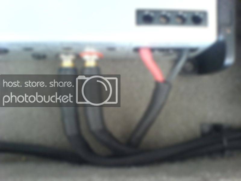

Amplifier wire terminations.

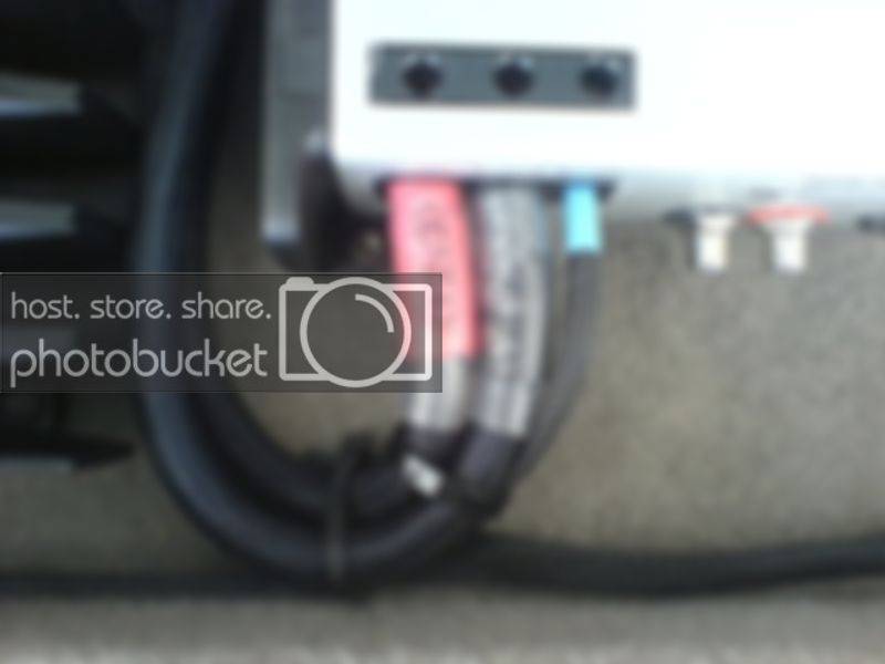

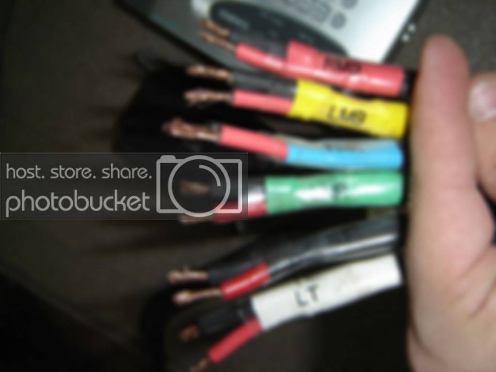

I do like your wires. With the techflex or whatever covering them. But where can I get those red sleeves that say 12V?
Yes, it's Techflex.
The "red sleeves" are colored heatshink.
I used it to "color code" everything.
Red for 12v and positive, Black for ground and negative, then each speaker wire cable has a different color.

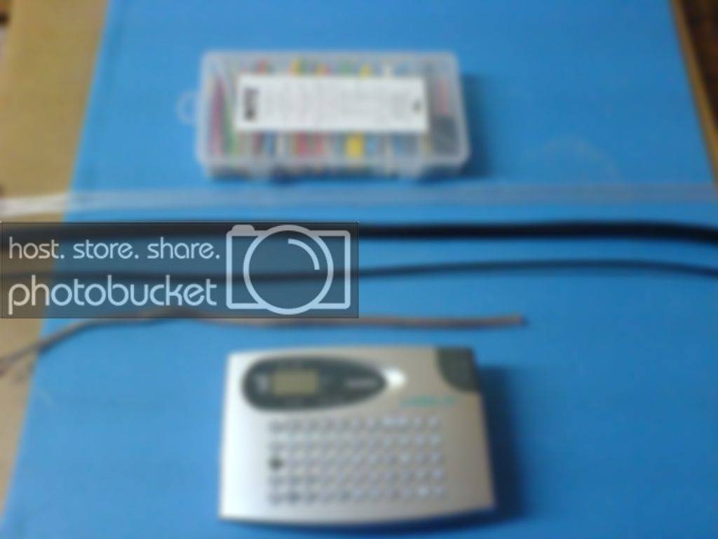

Here's a picture off all the speaker wire terminations. Each one is techflexed, color coded, labeled, etc.
On top of the colored heatshrink I put a label and covered all with clear heatshrink.
You can get a labeler for under $20 at any office supplies store.
I used the one at the bottom of the picture.

i hope you have some fans to cool off those amps..... its going to get hot awful quick under there without a way to disapate the heat build up
