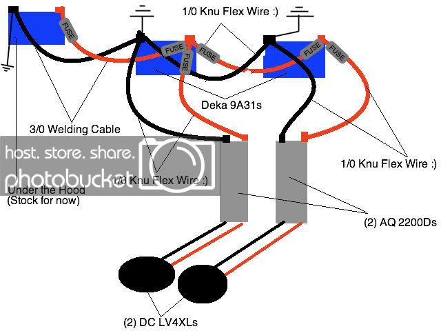

Does this look about right?
c0smo kram3r
Well, I saw an earlier topic about this, so I figured I'd post up my plans. This is how I was planning on setting up my system. I've had this drawn for a couple weeks now. The only questions I have, is what size fuse do I need? I was thinking 300A.
And, is this how I should place them?
between hood battery and first trunk battery positive
Then, between each Battery and amp positive.
I figured, you don't need a fuse b/t the two back batteries.
Does that sound about right?
As for fuse sizes, fuse based on wire capacity. IIRC 3/0 is good for about 400A. All of the 1/0 should be 300A. Ground each battery in addition to parallel connections between NEG posts.
