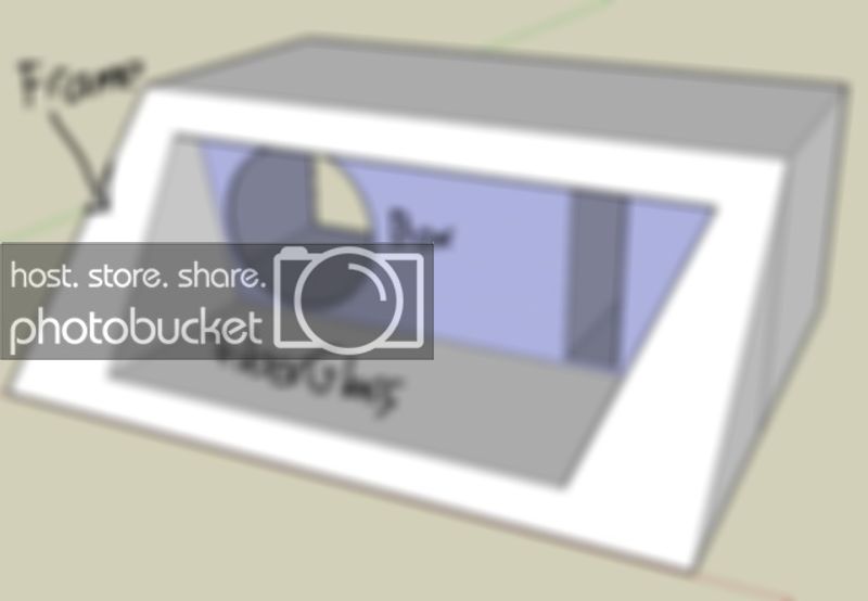

if i face it foward i'd end up having a semi weird opening.
kinda like this one.
if i were to do this. would i position the enclosure all the way to the back of the trunk or pull it closest to the opening wall?
would i have to run with the seats folded down the majority of the time depending on the amout of clearance given from the wall of the back seat and the cone of the sub?
i've really considered on facing the sub foward to help relieve alot of the noise cause by the trunk and the rear panel.
if i face it foward i'd end up having a semi weird opening.kinda like this one.
About the only way to do it and still run the rear seat, is to build a frame off of that panel that comes across, and have a baffle attached to the frame. Then basically building the enclosure to slide up to that baffle and secure to it. Thats what I would do anyway, unless you wanna do this.....
i was thinking build the box maybe 2-3 inches behind the frame. then fiberglass the outside of the box into the tube portion of the frame. though before the fiberglassing i would deaden the back end of the frame to cover any holes and air leaks. or as many as i could. same with the rear panel.
