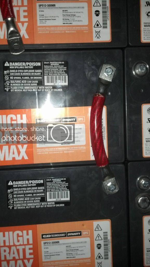

Do I need Bus bars?
adulbrich
Olive oil un-virginer
Well, between each battery would only be 4" of insulated wire. With that short of a run, it should be able to handle quite a bit of power, right?
There would be five banks of six batteries connected like this. In each bank, there would be six batteries connected in parallel like this "daisy chained"
It's the 1/0 Monster cable Sonic is selling on CACO.
The banks would be connected with Sky High 2/0 OFC that's as big as 4/0 welding cable.
Yea wire will be fine. Those lugs don't looked crimped at all? Is the wire just sitting in those lugs?
I haven't crimped them yet, lol. They were just sitting there for a visual //content.invisioncic.com/y282845/emoticons/laugh.gif.48439b2acf2cfca21620f01e7f77d1e4.gif
Yes, they will be crimped
