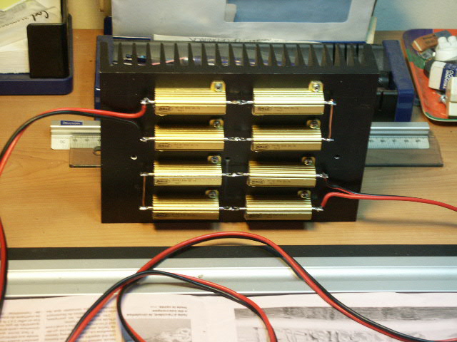

The problem is not the meter. You need a dummy load. You will get different readings with different loads. You need a dummy load that will replicate your target load, or at least give you a load you can calculate. 8 ohm dummy loads are common, and easy to find, and will allow you to calculate what you want at 8, and what it should be at 4 or 2 ohm or what ever your actual target nominal load will be.
You can either buy, borrow or build your own dummy load. Remember it's more important to be able to dissipate the heat for your target wattage than to actually hit your true target load. It will be easier to get/build a 200 watt 8 ohm dummy load, than to get/build a 1000 watt 1 ohm dummy load.
http://diyaudioprojects.com/Technical/DIY-Speaker-Dummy-Load/index.htm
http://www.audiokarma.org/forums/showthread.php?t=138902
http://www.radioshack.com/product/index.jsp?productId=2062288&cp=2032058.2032230.2032267&allCount=100&fbn=Type%2FPower+Resistors&f=PAD%2FProduct+Type%2FPower+Resistors&fbc=1&parentPage=family
I own a Fluke True RMS meter, but the only real advantage it has is a very high impedence which allows for testing sensitive circuits without adding much of a load to the circuit your testing. That's it. Not at issue with this kind of a test. Other wise my 20 year old $15 RS digital meter works just as well for this kind of a test.
