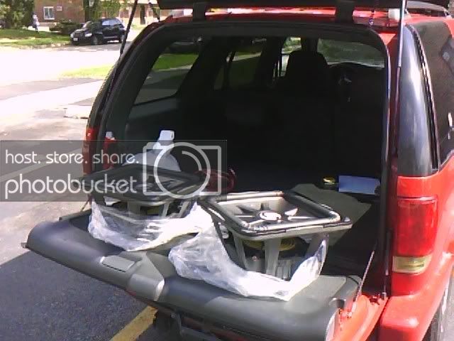

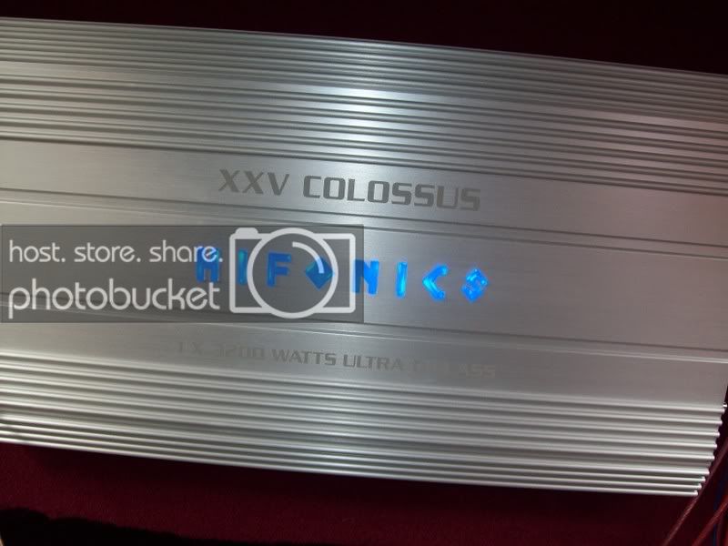

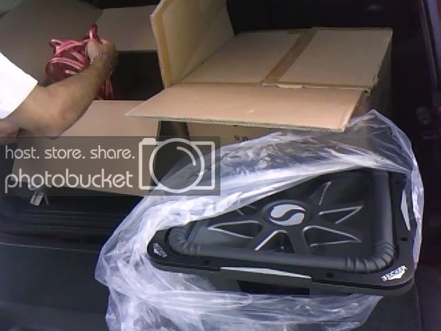

Because I got a pair of BNIB 2008 15" L7s for $100, essentially $50 a piece. Zx2500 isn't stable to 1ohm, so I sold it. I also got another deal on a BNIB XXV colossus for $450 . Couldn't pass up these types of offers, so I jumped on them and then swapped those L7s for dual 2ohm.

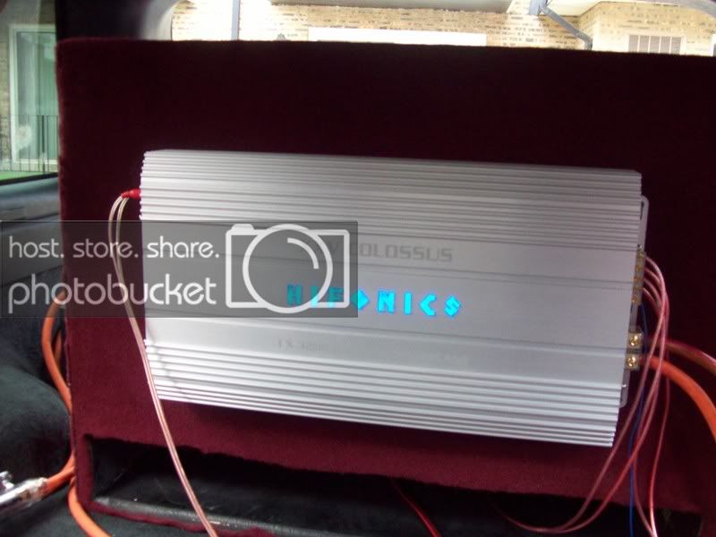

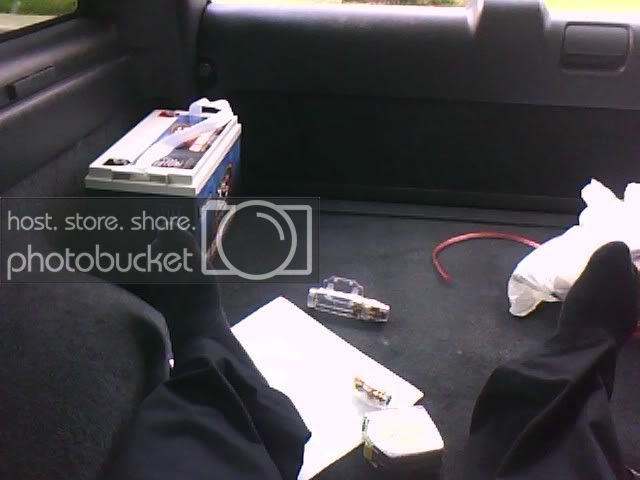

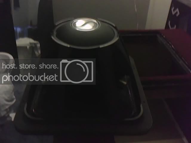

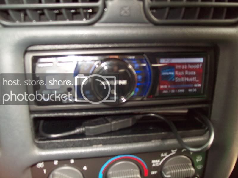

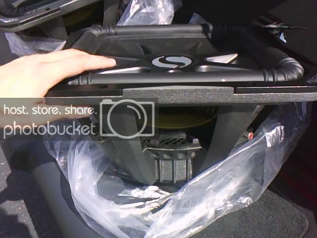

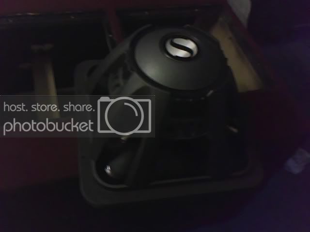

pics as promised

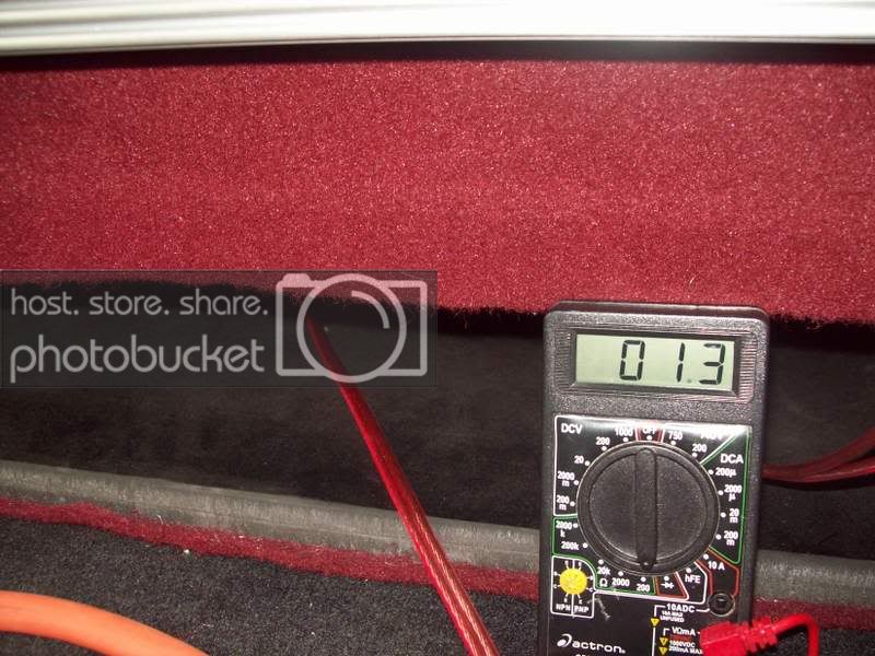

ohm load reading on each channel:
You are going to slowly kill your Hifonics mounting it to sub box. Board vibrates and brakes a mosfets leads. Most common problem with these amps.
