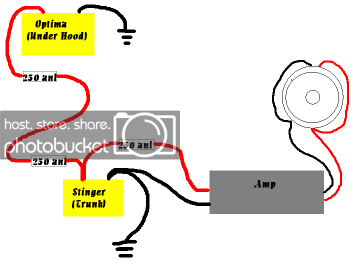

I was told by individuals on here I can hook up an extra battery like in the diagram below.
My lights are still dimming after the install and now I'm being told my system isn't running off the back battery wit hit hooked up like this.

It is hooked up correctly. Possible problems can be that you haven't done the big 3 and the possibility that your alternator isn't sufficient enough to charge both batteries.
And whoever told you your system isnt being ran off of the rear battery is a moron.

its hooked up right, reason tha tits dimming is because your alt charges at 14ish, and the batts sit at 12 ish
the dimming is the lights themselves running from 14.4 to 12.6
absolutely normal.
if you want to completely get rid of dimming you gotta investg in a H.O. alt, but imo, the 350 that you are gonna pay for that isnt worth it.
just a thought, put a DMM on both batts while the car is on and see if it is the same.
it should be.,
you dont really need 2 fuses between your batteries.along with that do the big 3 and see what happens
Better safe than sorry with the two fuses... if it ever happens that his front battery should become completely discharged and his rear battery send to much current t the front you can end up with a lot of fried wire between rear battery and front fuse... I personally have two fuses in my setup... but meh, chances are low of this happening...
x2, it's a little added protection on both ends
if the front batt is discharged then the rear is as well.
reason for the fuses is in case of a short, fuse will blow instead of battery blowing.
