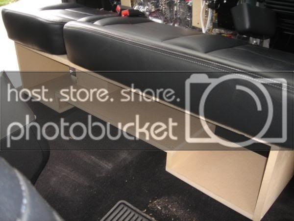

Hey every one, I would like help from you experts out there on designing a box for two RE Audio SE 12's Sealed. The subs will be placed in a truck under that back seat. Will be up fired!
Here is the space available to give you and idea:

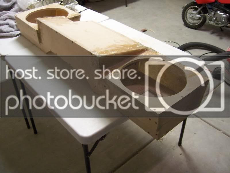

Now I have thought about up firing them in a box like this, but of course much larger for the specs of the sub:
Now my BIG question is, is this box design going to create issues with the sub performing the way they should? Such as not creating bass notes it should be due to design or not getting the output it should from design......
any help is very much appreciated!
As long as you have the correct volume and the surround doesn't hit the bottom of the seat during excursion you should be fine.

**** you know way to much, Does the shape of a sealed box matter as shown in the picture? Or is it fine? Also if the recommend 1.0 per sub think 1.25 would be a nice size making it 2.5 total?
Can never know enough...
And everything i've said can been found with a quick google search and the search button on your screen here.
1.25 per sub will give you a Qtc of .77 and 43.9Hz resonant frequency. Probably would be fine. I have no expereince building sealed enclosures but I would think that would be good. Just watch the power you put to it so that you dont push it past its mechanical limits.
Also I can not see your pic but I am pretty sure shape does not matter for sealed enclosures.
