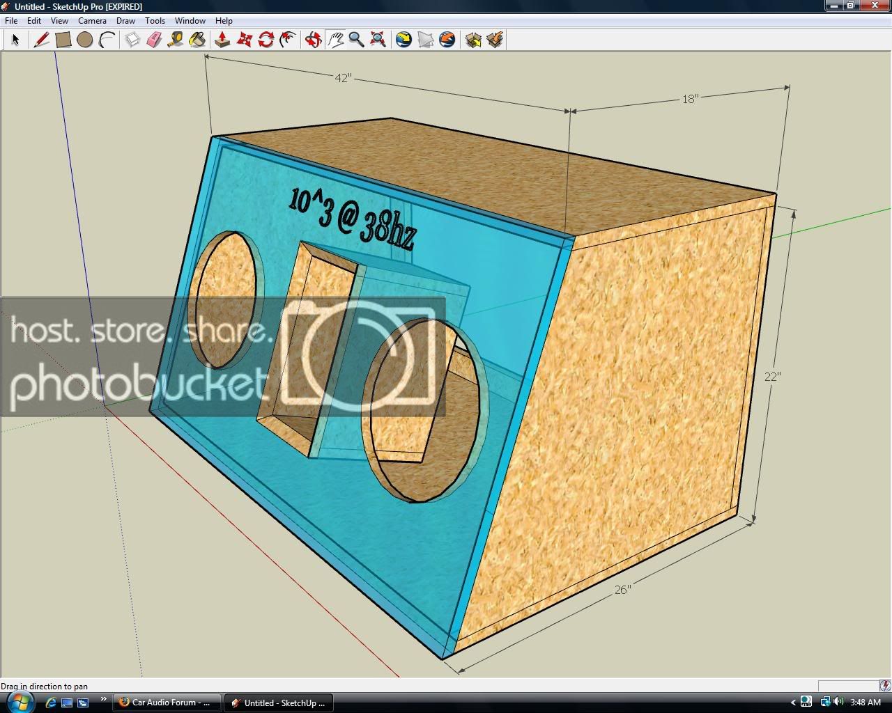

Designed box for 2 x XXX 12's
rcnshoe
VW Pimp
Tell me what you think. I took the specs off the RE website. 2.2@34Hz per speaker + Displacement - 0.24 cu. ft.
Came up with 5.068 cu. ft. 34.05hz
