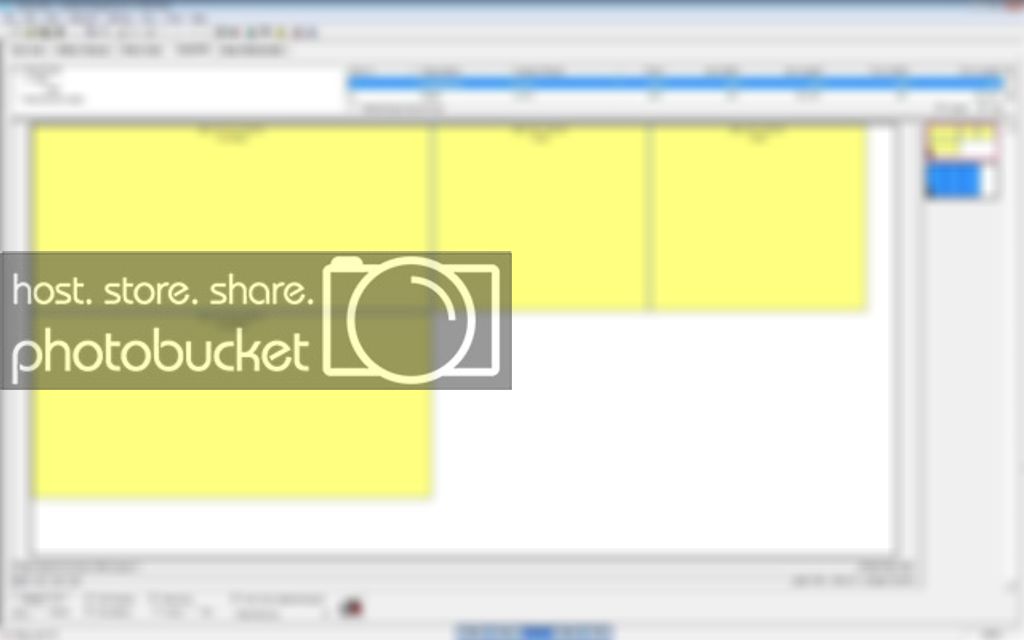

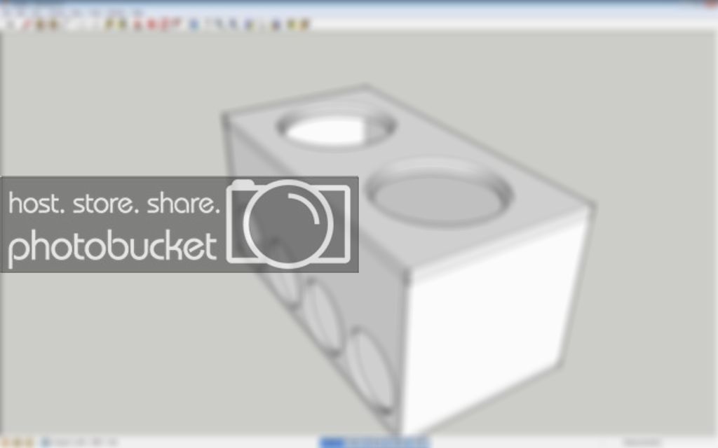

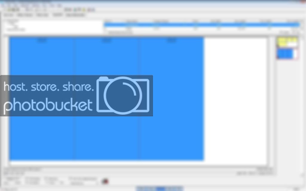

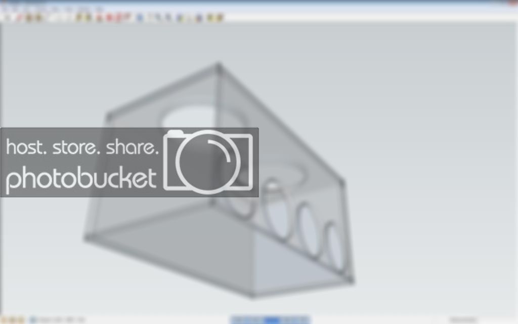

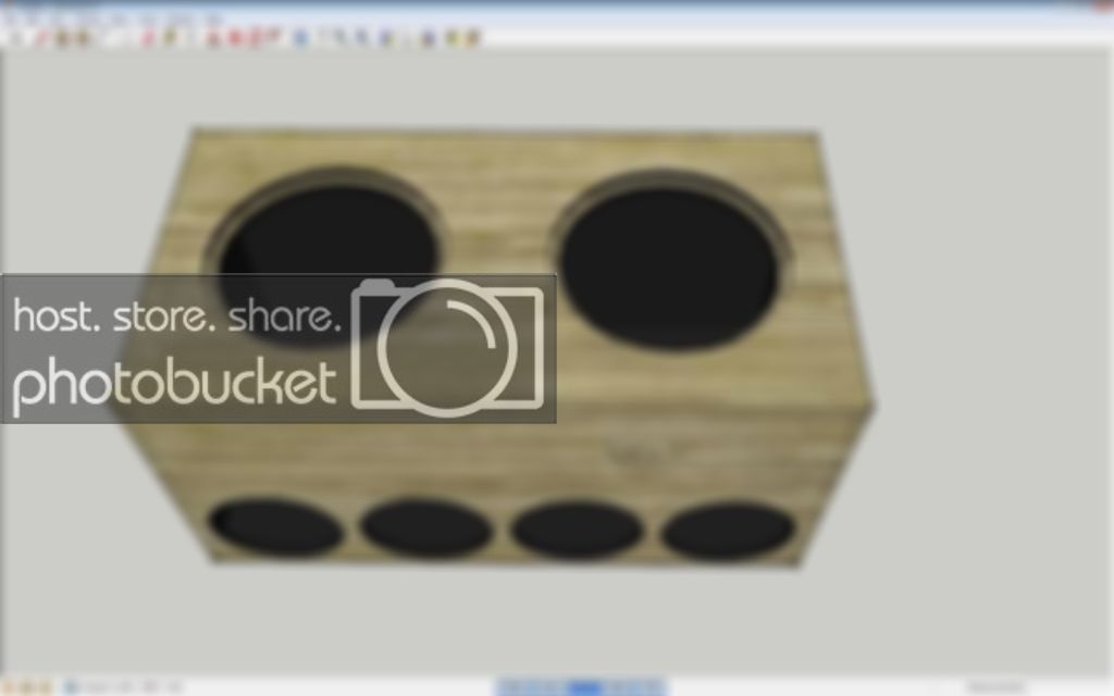

This is a box design for Jbizzles Trail Blazer, box is for 2 18" Nightshades on two SAZ-3500s. Box should consist of all 13 ply baltic birch. With two dowels placed vertical in between the subs and 45s supporting each corner.
The box is 10.5 cubes before aero and sub displacement based on the room available to work with. Tuning is up to Bizzle but I was focusing towards the 38hz area. Hopefully Bizzle will get pics up when its all built for everyone to see. Very basic box, but should do the trick and help him out a bit.
Cutsheets

Looks like my teammates famous green box.
Should get decently loud and low. //content.invisioncic.com/y282845/emoticons/smile.gif.1ebc41e1811405b213edfc4622c41e27.gif
Hopefully Saturday we can do some testing Tommy //content.invisioncic.com/y282845/emoticons/biggrin.gif.d71a5d36fcbab170f2364c9f2e3946cb.gif
Yup, its a real standard yet effective box. //content.invisioncic.com/y282845/emoticons/biggrin.gif.d71a5d36fcbab170f2364c9f2e3946cb.gif
