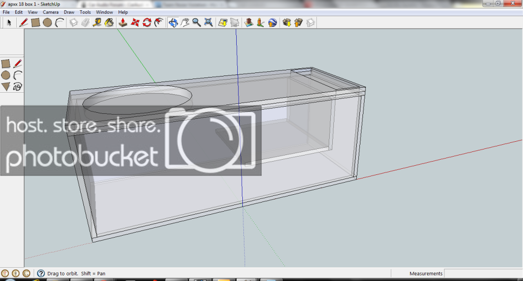

went to my first comp and pulled a 144.9 @ 37hz (juice box, gorilla zoe) with a broken loading wall.... I didnt brace it and it moved like a mofo and it made the sub load weird so yeah... but heres the next design 6 cu ft net with 90sq inches of port tuned to 33hz. mostly going for a demo/groundpounder that will still put up decent numbers... hopefully i can do a 48 outlaw with this bish... opinions??
