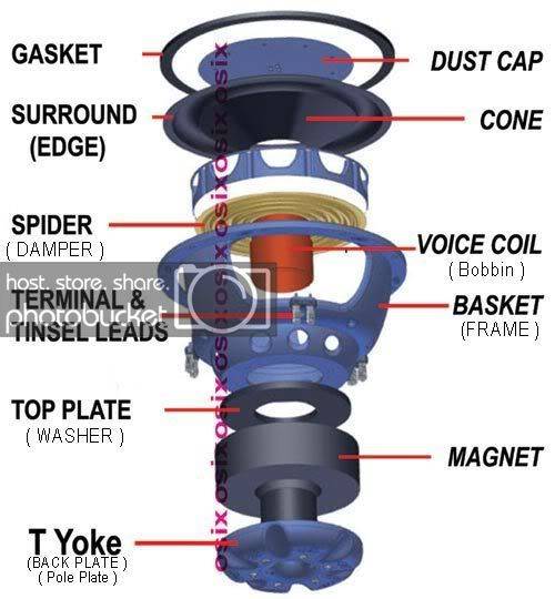

Cross section of a Sub -

just for reference, when dealing with overseas builders, and general industry use
spider = damper
top plate = washer
basket = frame
