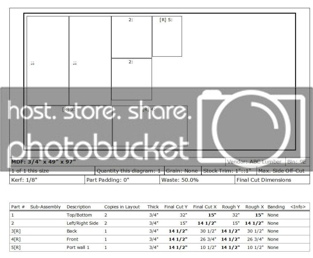

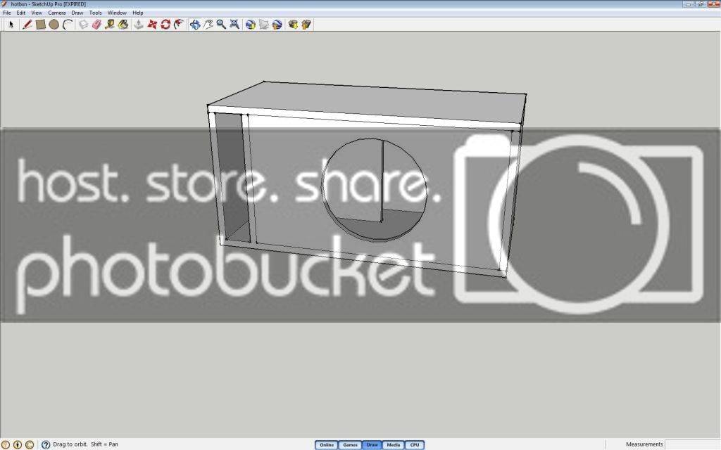

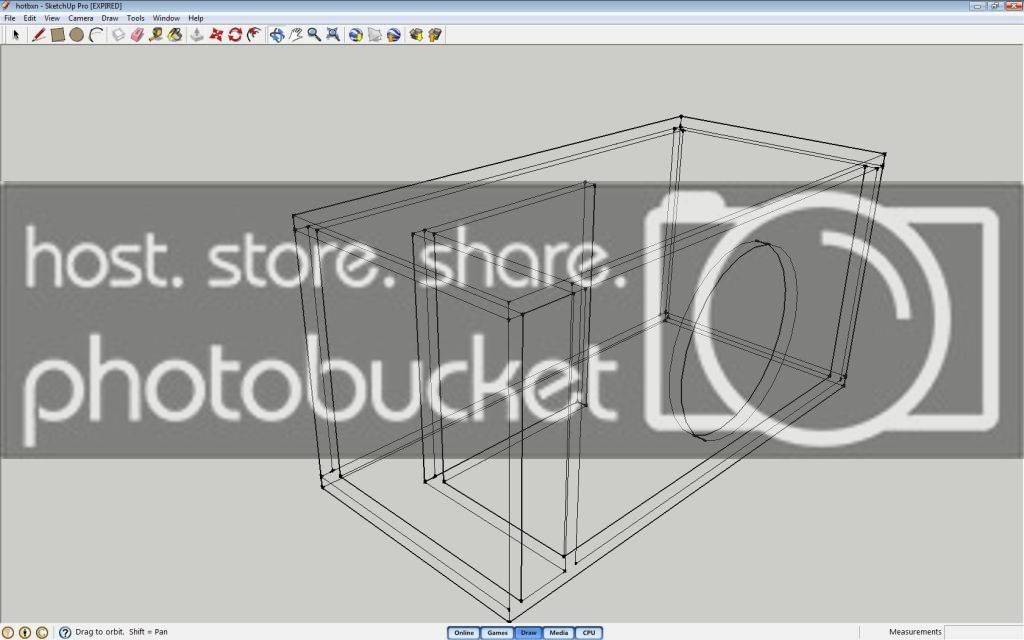

Hope ya find this here just easier to view then through a PM. BTW the cutsheet is a trial and did not put the last piece in which is the second part of the port wall, so make sure you dont forget it. After a few more tips I will buy the real version and no longer have the dumb trial. Port wall b is 12x 14.5 and you can see it in the sketch up pictures.
Box is 2.7cubes, at 36hz.
