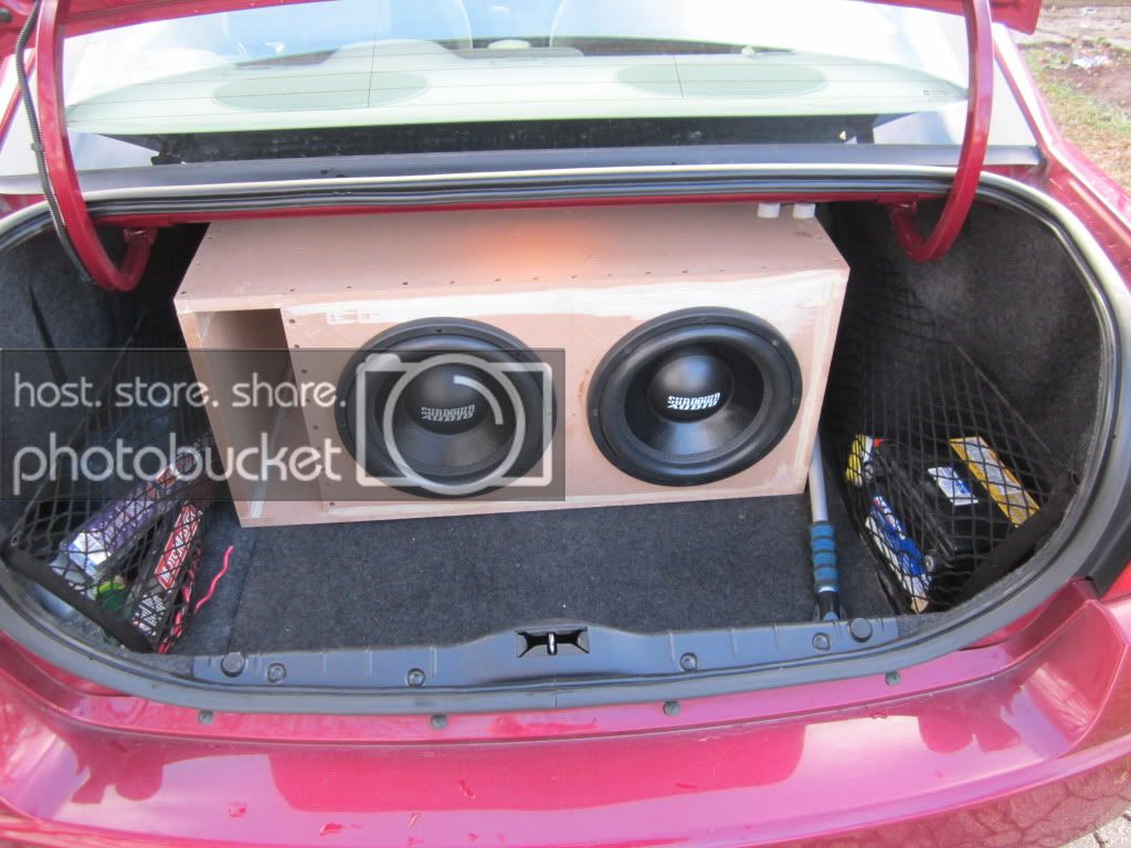

well i mean, djthrownslow songs pound, but when playing normal sounds, they dont pound as loud at all.
are your subs facing in, or pointing at the trunk? mine are pointing at the trunk.
my last system was ****, this is my first real good setup, i had 2 used mtx thunder 4200s, runnin off my ma audio 1600 that i have, and it ****** ****, subs were only like 250 rms each or something, and i didnt know as much as i did now about car audio ( which stil isnt alot ) l ol
and at the time it was using a 20A fuse lol.
Firing into the trunk - just like yours
