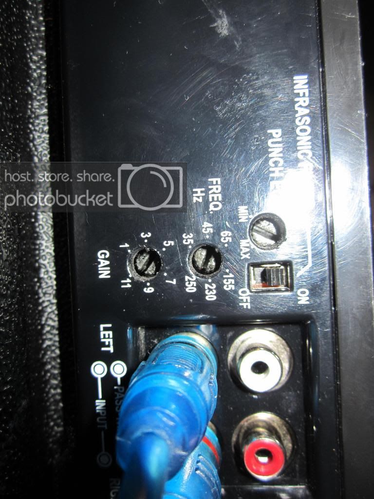

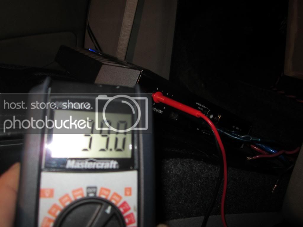

now how do you know im reaching the limits for sure of my amplifier? its reading 39 volts, and the gain is at 4.
is it even worth me getting a batt and upgrading to 0 awg ??
i just want to MAKE SURE these are pounding to their full potential, so if someone can guide me to do that it would be great.
sorry im stupid
The amp only make x amount of power. Just because the gain can go higher does not mean it should. If you set it higher than what it can send a clipped signal which can and most likely will end up damaging your speakers. If you want to be sure you are getting the most out of your amp, you need to get a o-scope so you can actually see when the waves begin to square and clip.
sorry im stupid
Gain =/= volume control. If you want to get louder get a bigger amp, or try a new enclosure. Is it worth upgrading? Yes because you'll probably want a bigger amp later on down the line. Pounding to their full potential? No, a pair of SA-12s will handle at least 2k. Get a bigger amp and they'll be pounding to their full potential.
7 pages of nonsense and no one has explained what the purpose of the gain setting is. It is NOT a volume knob. It is there to match the output signal of the source unit. For example if your headunit has 2.5v preouts, then you want the gain on the amp to be set to 2.5v (NOT volts AC) Unfortunately most amps don't have the voltage readings printed and instead have an arbitrary number system or even just a visual symbol indicated less to more.
I have a Rockford p1000.1bd and it has the same looking settings and I have 2.5v preouts, same as OP. My gain in about the same place as op after he reset it. Mine is set for around 37vac or 1400wrms x 1 ohm which is what my birthsheet reads. I have a 130a alt, 1 run of 4ga and no electrical upgrades and I'm running a 2ch to the front stage and my **** is maxxed out. I don't push my volume past 50-60% though so I dont really have much of a voltage drop unless I burp a 0 db tone.
