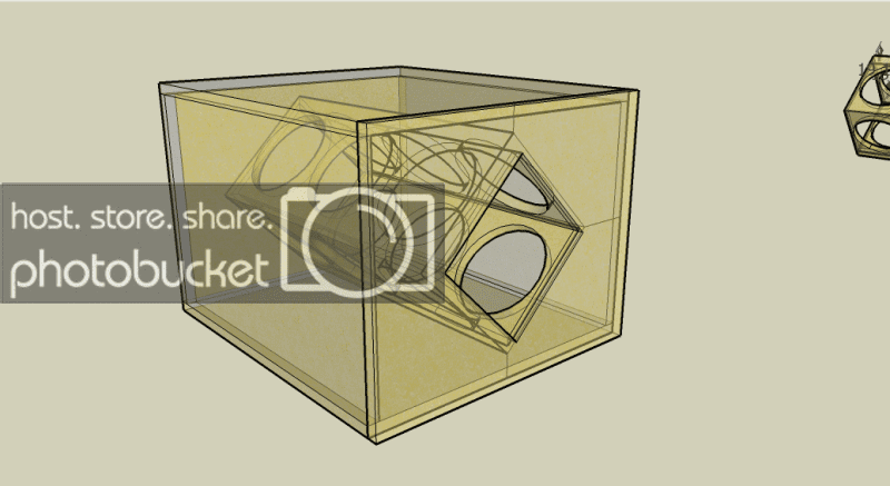

Initial Concepts:

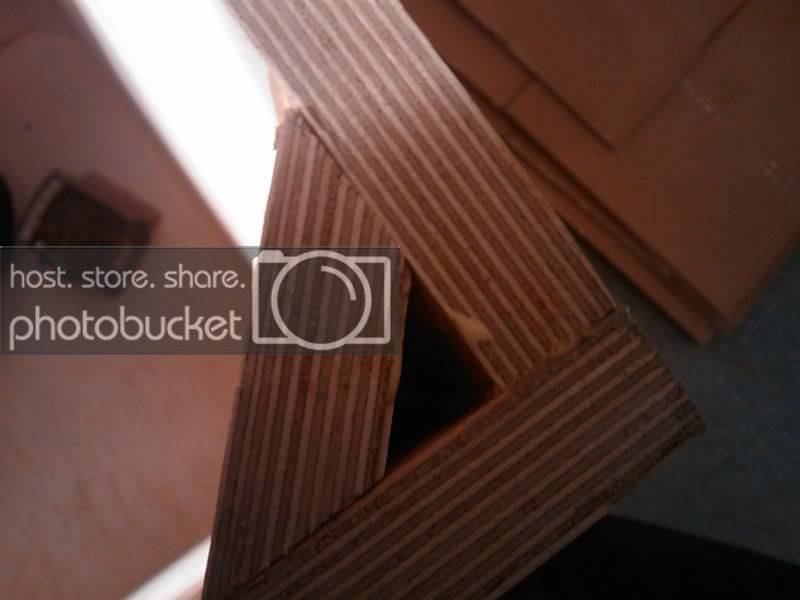

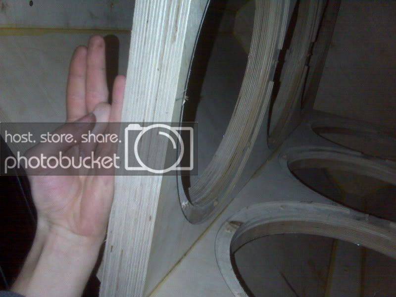

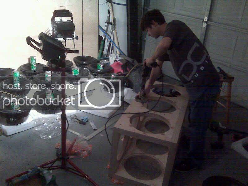

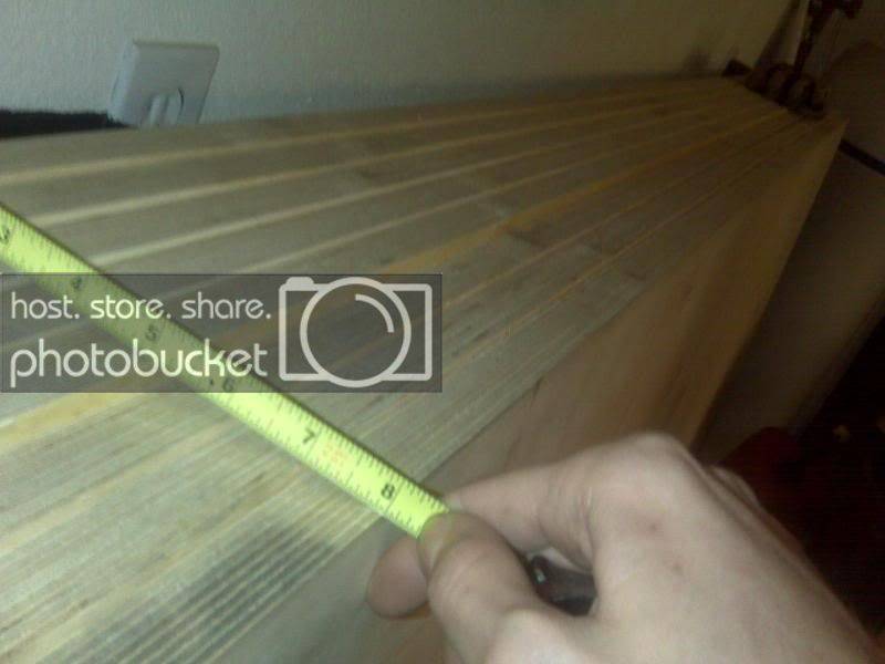

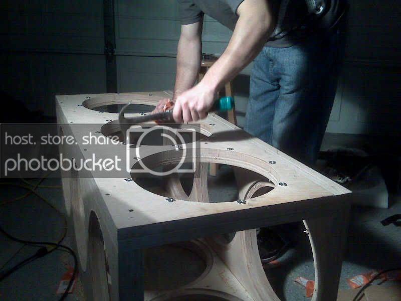

Chose good wood, 18ply 1\" full birch

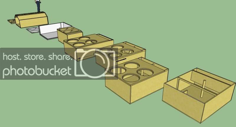

Final Design Chosen

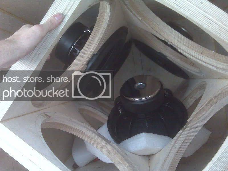

Woofars Lvl 4 15s
Lookin good so far!!!!!!!!!!!!!

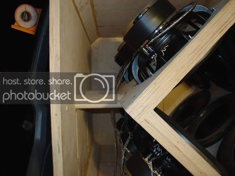

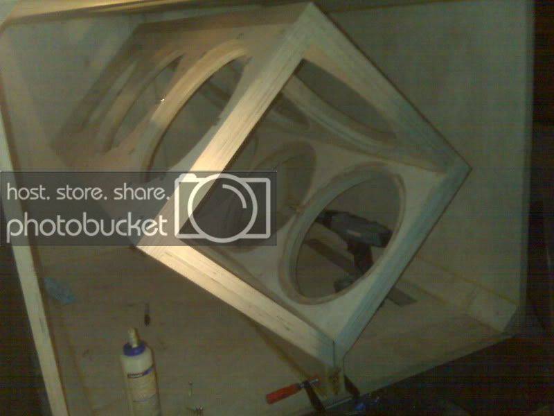

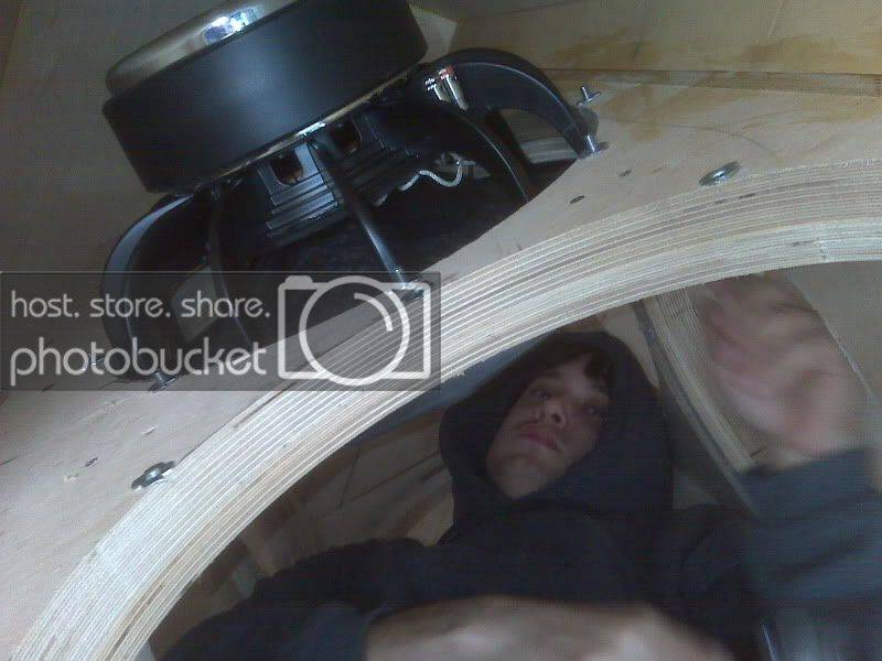

2" wooden dowel to brace the largest open panels and zee tunnel.
So-

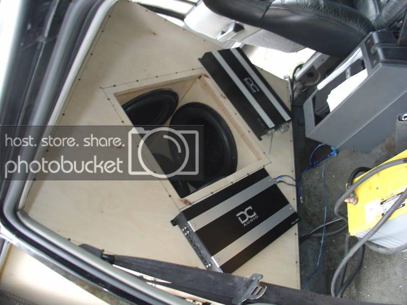

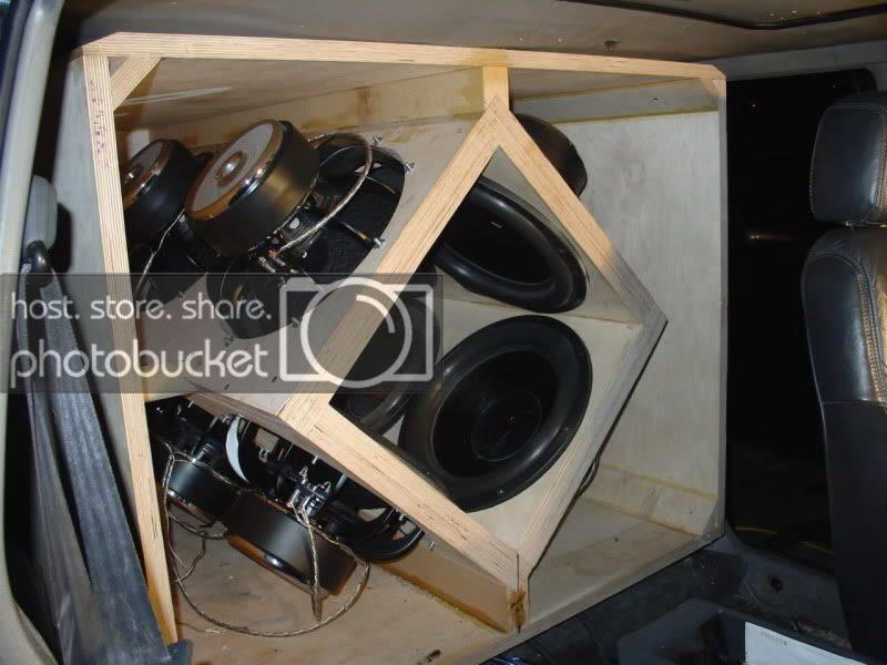

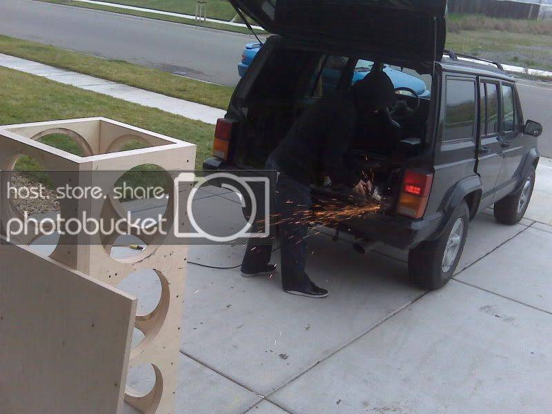

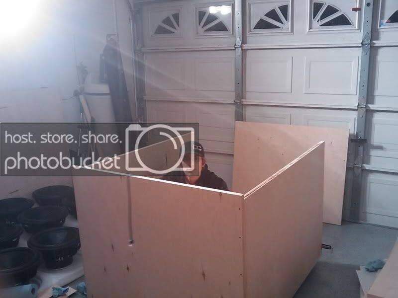

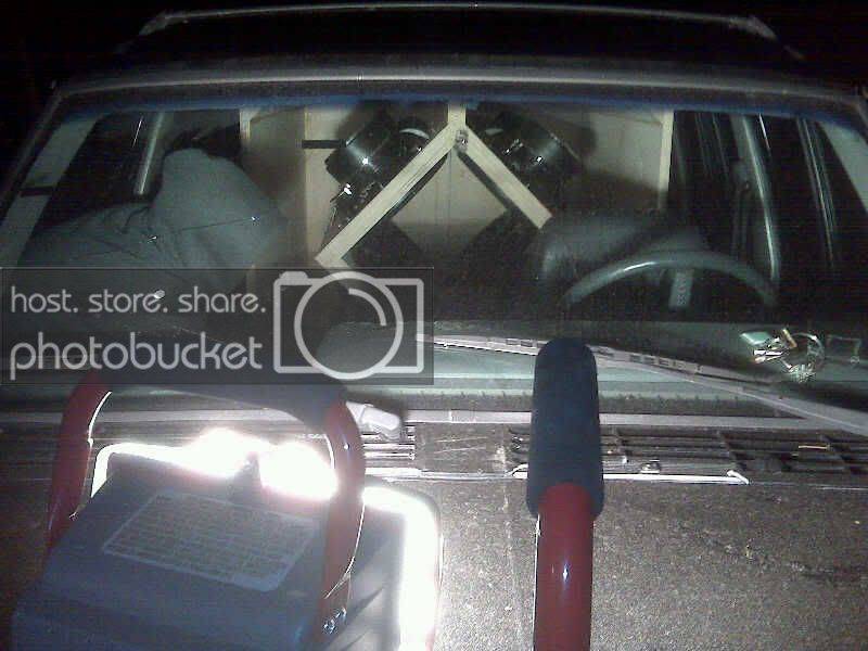

It was almost exactly seven days from the moment I laid the first glue joint on the first woofer to the point of it playing (two of four amps and unsealed) but I think we did a hell of a job in that amount of time. //content.invisioncic.com/y282845/emoticons/smile.gif.1ebc41e1811405b213edfc4622c41e27.gif

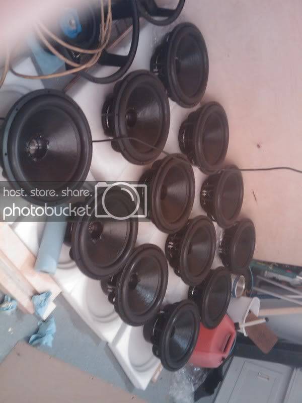

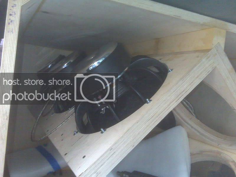

I built all of them- four were recones and fully built the other 8.
The goal of this build is to play extremely low, as "safe" and "reliable" as possible while also putting up a good score for when he goes to shows every other month or so. To achieve this we went as high as possible with motor and cone, while keeping watt per woofer low and in a sealed environment.
We'll see how it does in the future //content.invisioncic.com/y282845/emoticons/smile.gif.1ebc41e1811405b213edfc4622c41e27.gif
