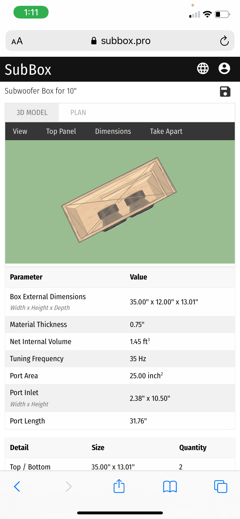

u think 3.5 cubes is enough space for the 2 lvl4 10’s?
It'll be close. DC's like big ports.
here is the box design i was originally gonna go with, but it might change due to where ima want the box to go
