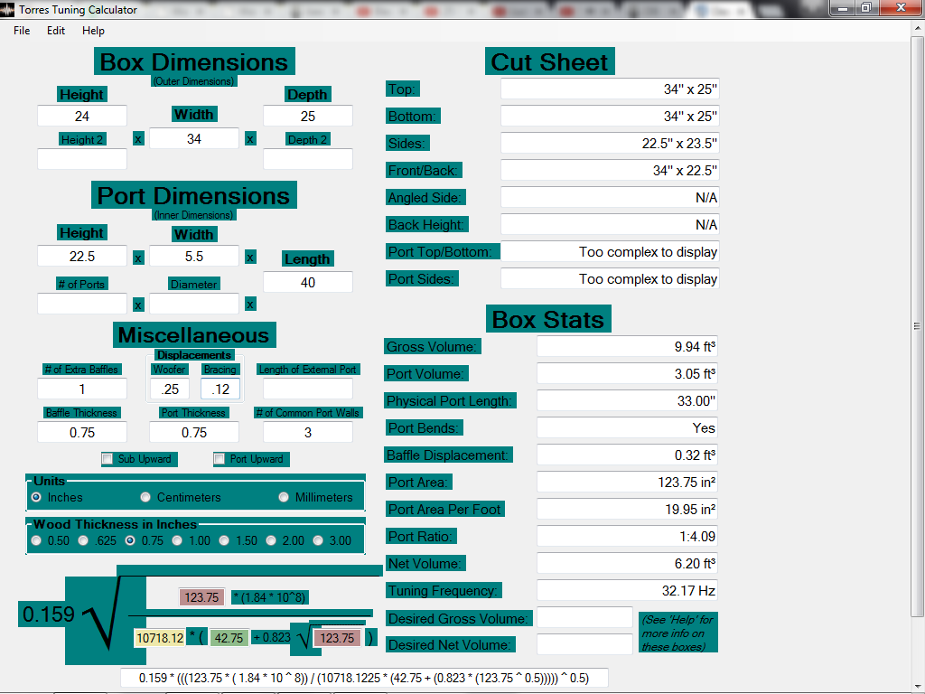

Yeah I'll load up some pics later on. I'm at work right now and don't know how to load pics on my phone. Box is 34x25x24

is this a slot or an aero? With slot and around 120 sq inches of port, After displacements, its not 8 cubic feet its a lot less than that around barely 6.2 cubes.
is this a slot or an aero? With slot, After displacements, its not 8 cubic feet its a lot less than that.
Sorry that was stang and I new box plans for an aero lol. It came out to be 8.3 -8.4 don't remember the exact number after port displacement. The current box is slot port.

Ok. So you guys are saying I should do 10+ cubes with 160 sqin of port.
160" would be for a 14-15cubed box... U gotta play with numbers and it all depends on the size of the box... Get Torres box calc if you don't already have it
