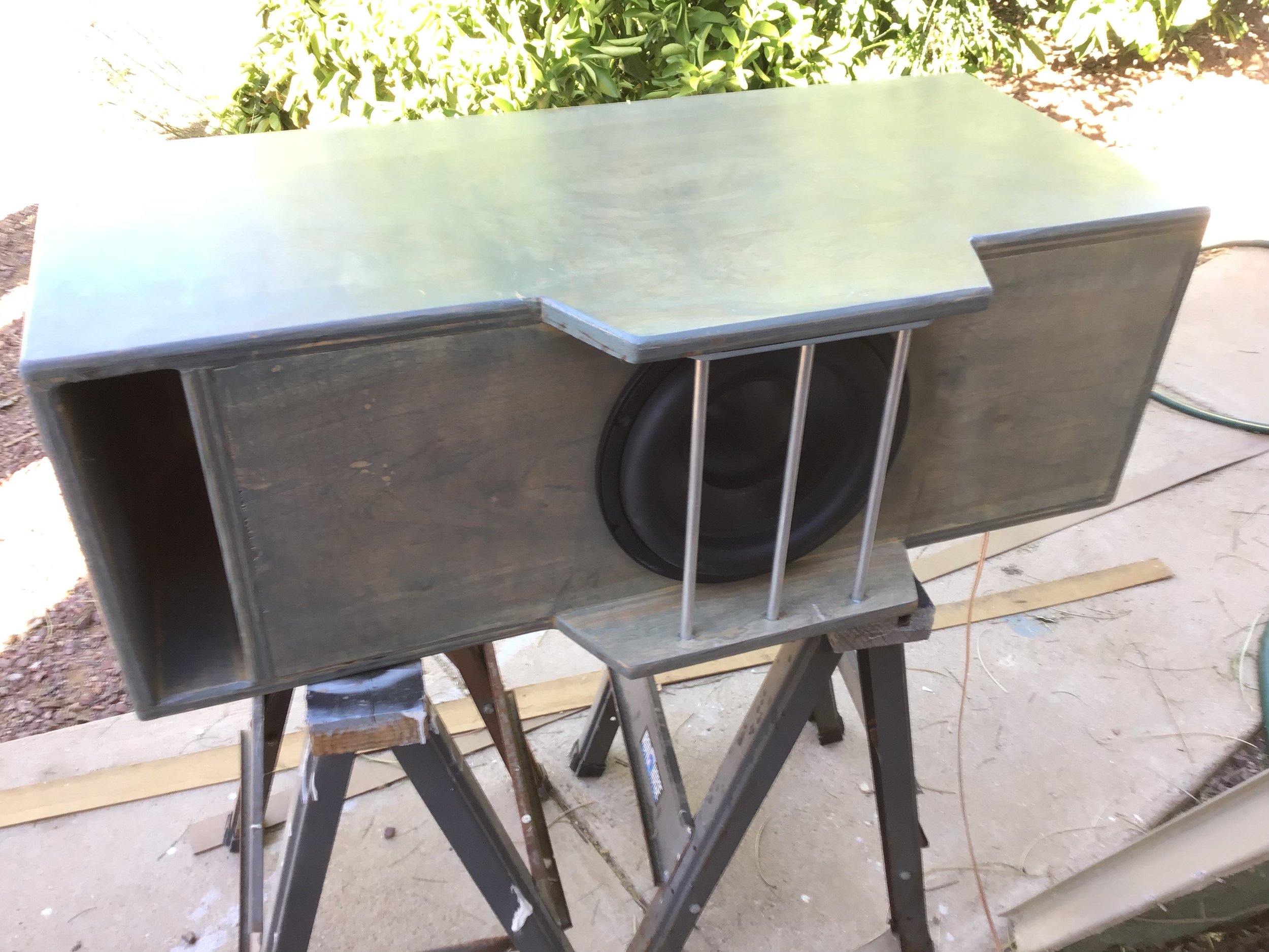

Trying to finish today so I can install tomorrow. 1.3 cubes tuned to 30 HZ. Doing clear coat and putting the sub in jail now.

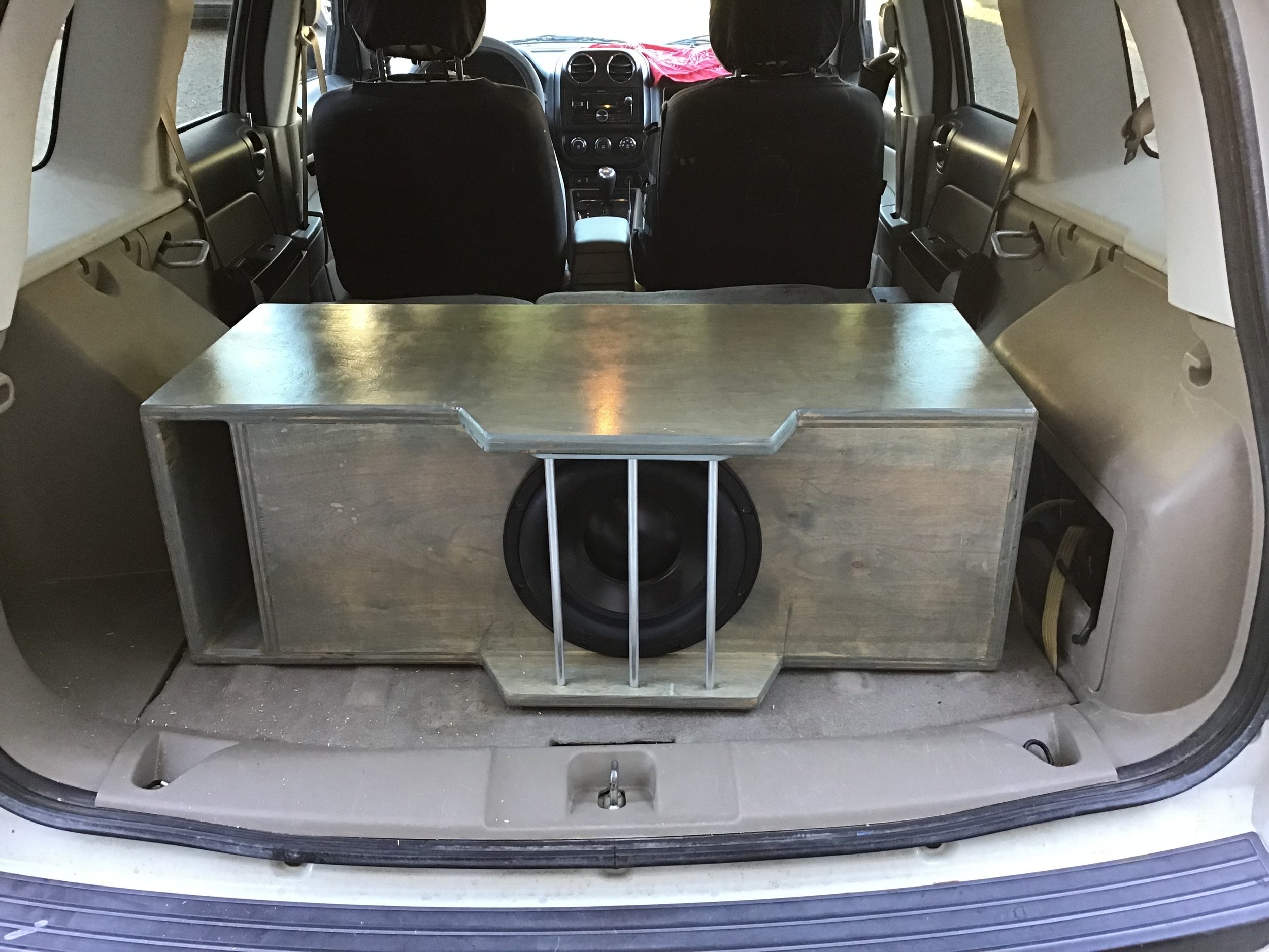

Sorry if you already stated but what vehicle is this going in?Finished with the box. Installing later this evening. Heavy MF for a single 10.
View attachment 32987View attachment 32988
Nice! I bet it gets low!Sounds really good. I’m going kinda easy on it for the first few days and just running the 600 watts I had the audio legion armada running on. It’s louder than the armada on the same watts.
24 inches of total port area which works out to 20 sq inches per foot. They recommend 1.5 cubes tuned to 40 HZ for an “spl car audio enclosure”. I didn’t like how that looked when I ran the parameters so I came up with 1.2 @ 30 HZ being closer to what I wanted. It’s sounding pretty damn good.Let me know how it plays man, I'm genuinely interested. Dayton has some of the most confusing enclosure recommendations with some of their subs.
What's your port area or port area/cube?
It seems to play up to 80 hz fine. I was nervous that the port area might be too large but I’m not hearing any issues so far. I wanted to try a smaller air space with a slightly larger port on it. Once I start pushing it hard I will know better how it’s doing.How high are you able to play?
