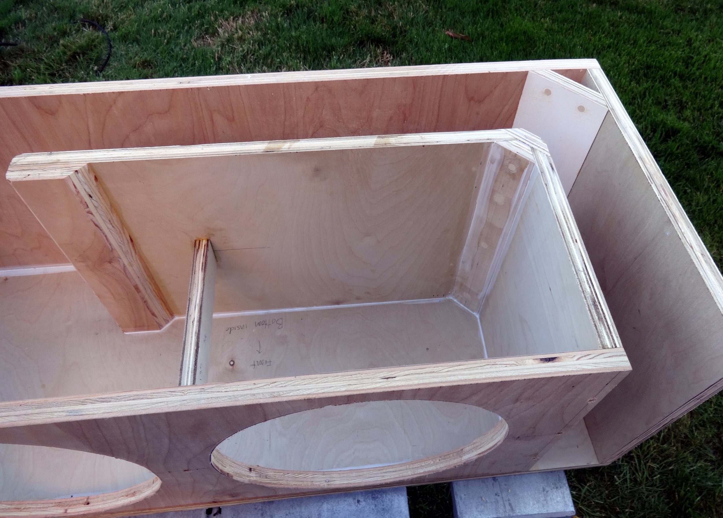

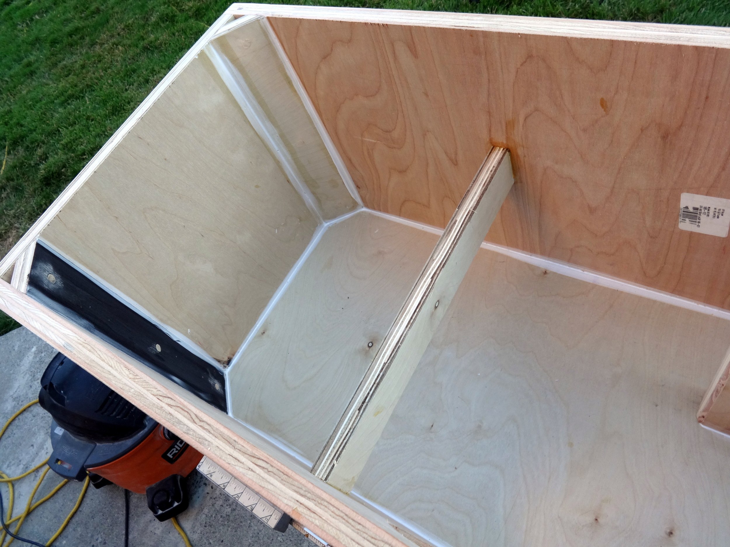

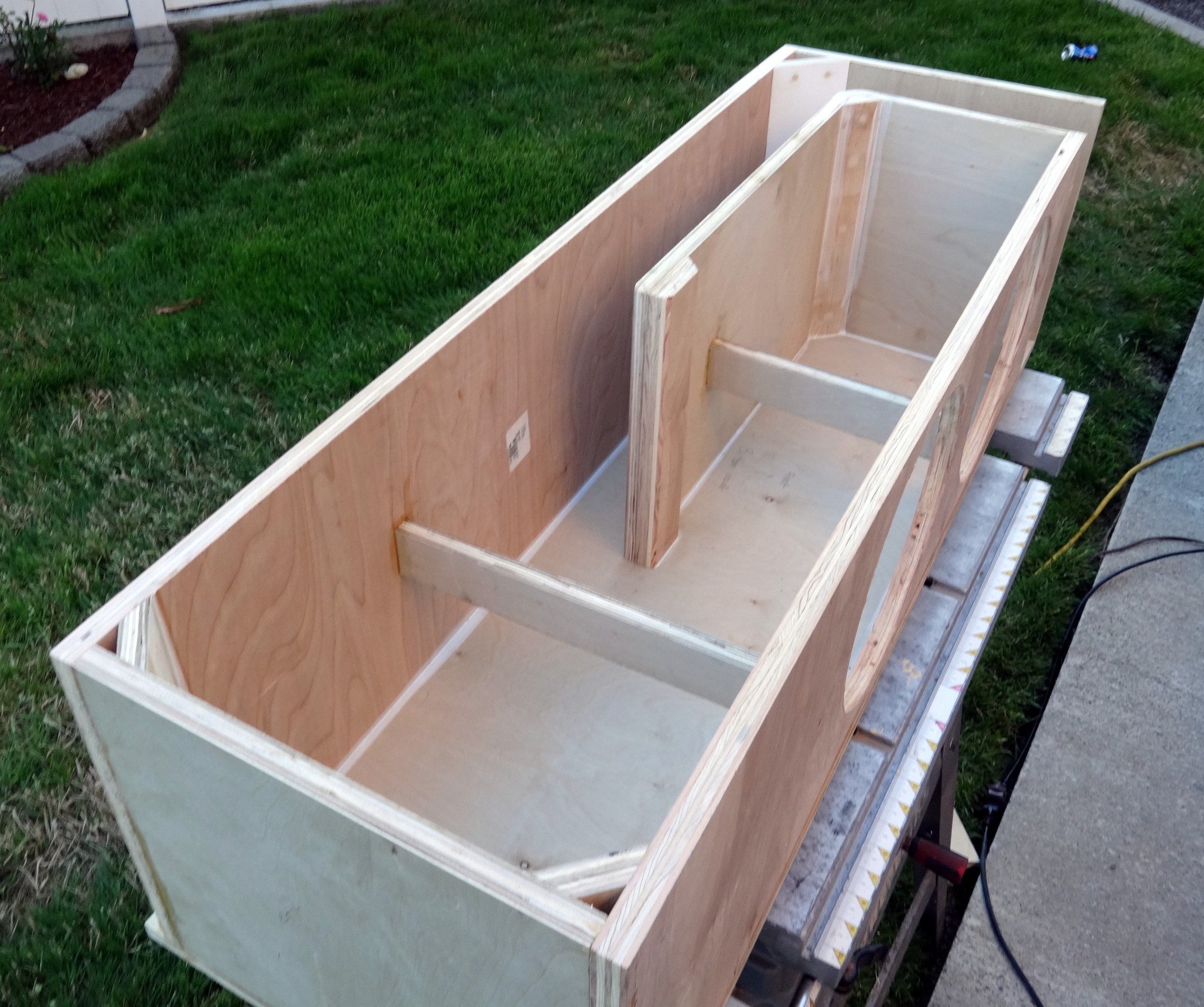

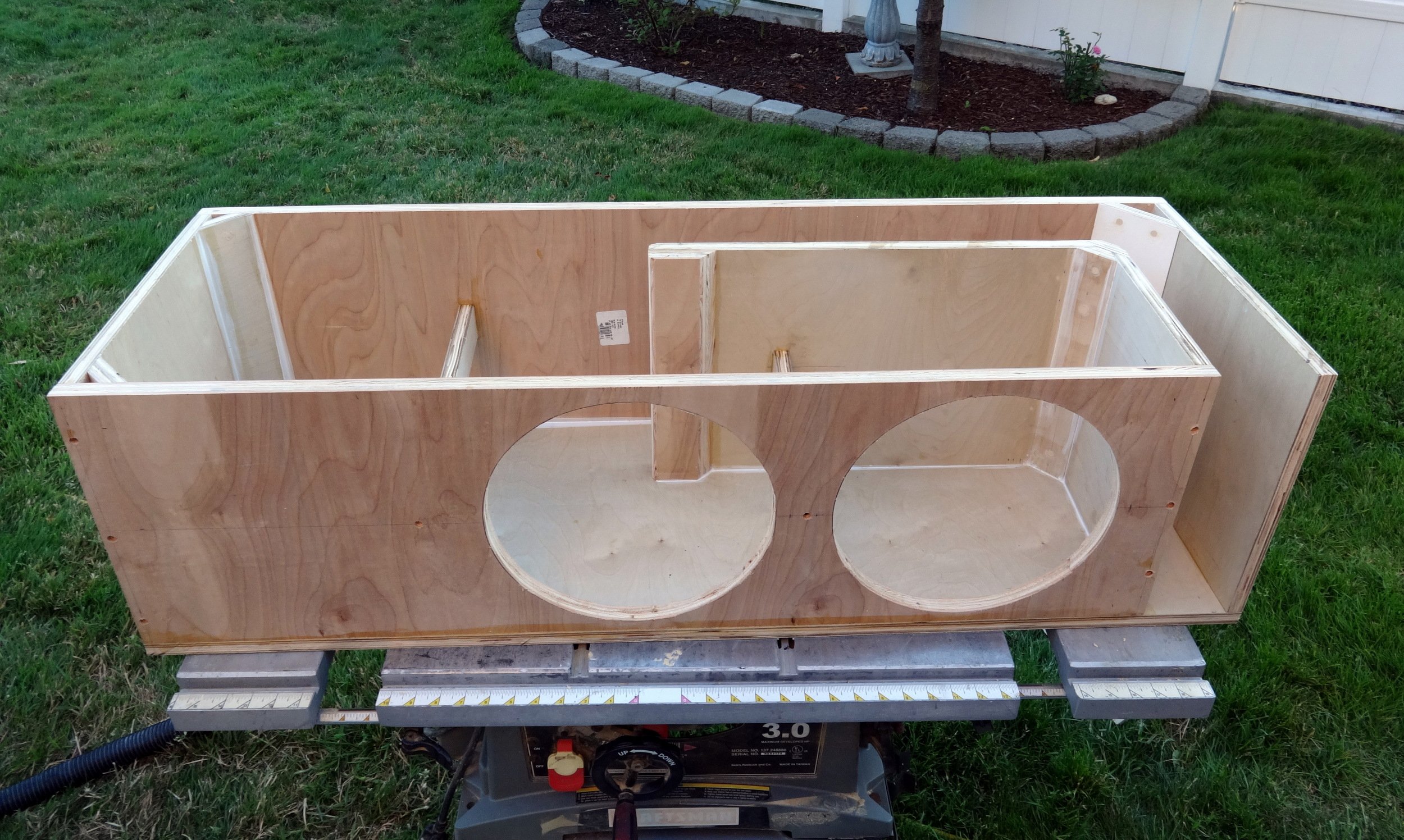

These will be going in a 2002 GMC Envoy.. Box is 3.0 cuft. Tuned to 30hz with a 12.5" x 3.5" port opening.
Subs will be powered with a Zapco ST-2000XM II or JL RD1500/1 both provide 1500 rms @ 2 ohms.
Progress so far.

Hit a Screw with the router bit when I was doing my cutouts for the subs, had to finish with my $hitty jig saw.. cutouts didn't turn out the best but will grab a new bit for the 2nd baffle.
