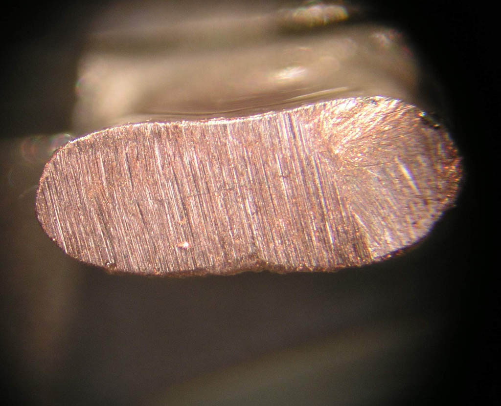

This is what a proper crimp looks like if you cut it in half
http://www.aeroelectric.com/articles/CrimpTools/GL.jpg
Note that there are no voids in the wire grip area for either terminal. If I had a better polishing tool, you would be able to see individual strands captured in the terminal wire grip barrel. The 500 microinch or so thickness of tin plating on each strand would be visible as squashed ovals traced in the copper surface. As you can see, the wires & connector become one. It eliminates all voids between wires, thus keeping any air out. This prevents corrosion, which is the #1 problem in electrical connections. Corrosion increases the resistance of the connection, which obviously is BAD.
