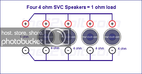

you'll need a dual 2 ohm, or 2 dual 4 ohm subs to get down to 1
Any of these ways will work for a1ohm load just make sure you know what ohm vc you have.

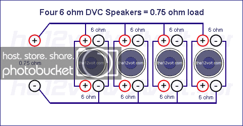

Aso, here is the only way that i saw on how to make a .75ohm load

Normal 1ohm coils can range from .7-1.3 usually //content.invisioncic.com/y282845/emoticons/biggrin.gif.d71a5d36fcbab170f2364c9f2e3946cb.gif
exactly.
so getting EXACTLY .7 is gonna depend on what the specific coils read.
