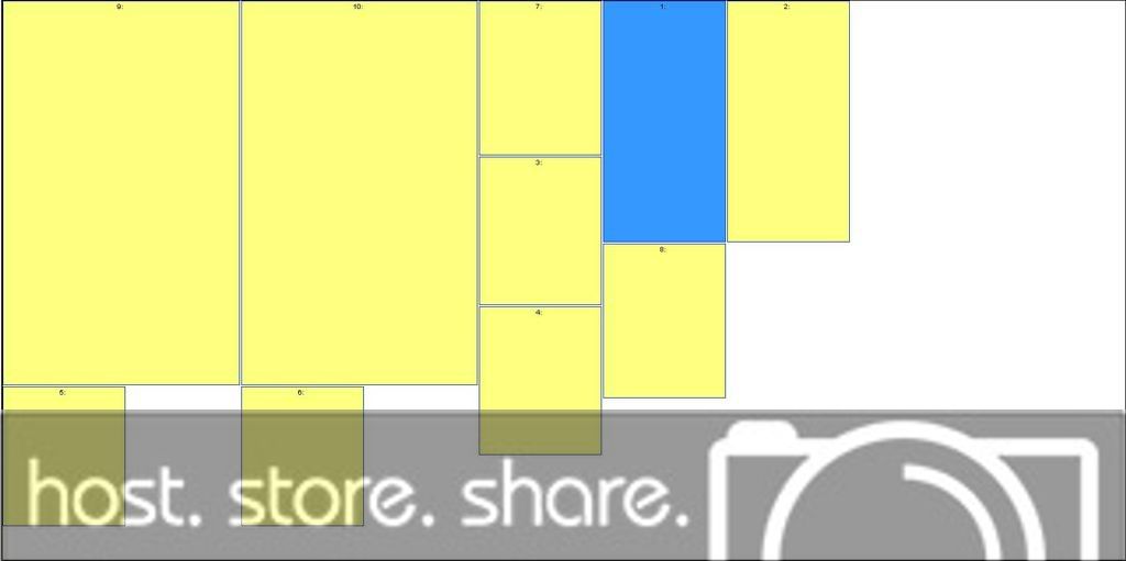

Cutsheet Help?
You will need to cut 4 pieces to 10.5"x49" out of those you should be able to get the first 4 you listed 20,12.75,12,13.25.Then cut 2 pieces to 20.25"x49" and you will get the 33" pieces out of those.
Hope this helps.
Use the thing located in your head to figure out which piece is which. It wont' be hard, I promise.
This is real nice but not the most effecient.Cutting all the similar widths out at once will be much easier.Once the width is cut all pieces will be almost exactly the same width and all that is needed is to cut each section off at the lenght you want.
You will need to cut 4 pieces to 10.5"x49" out of those you should be able to get the first 4 you listed 20,12.75,12,13.25.Then cut 2 pieces to 20.25"x49" and you will get the 33" pieces out of those.Hope this helps.
Thanks very much, I appreciate both of you helping me!
