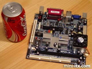

New updates on the CARPUTER is that the motherboard I have now is big and I really don't whant to put it in the trunk, longer cables give me loss in video quality and can pick up more noise, so I bought on ebay a small motherboard used for car pc and I can fitted behind the 8" Touchscreen LCD. I don't want to sacrifice my laptop for this install yet
