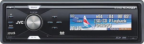

I bought a JVC KD-AR7500 as the main Head Unit controlling the 7band EQ with a nice 5volt pre-out, and the Car PC will be on the AUX in. The JVC Headunit will be stealth unless I decide to modify the center console. I won't be using the AudioControl EQL.
Main features I was looking for:
Plays CDs, CD-R/RWs (including discs loaded with MP3 and WMA files), and Secure Digital (SD) cards
7-band iEQ with 12 preset tone curves
BBE Digital for more lifelike sound from your compressed music
advanced multi-bit DAC (digital-to-analog converter) for accurate sound reproduction
auxiliary input
5-volt front, rear, and subwoofer preamp outputs
CD frequency response: 5-20,000 Hz
CD signal-to-noise ratio: 102 dB
